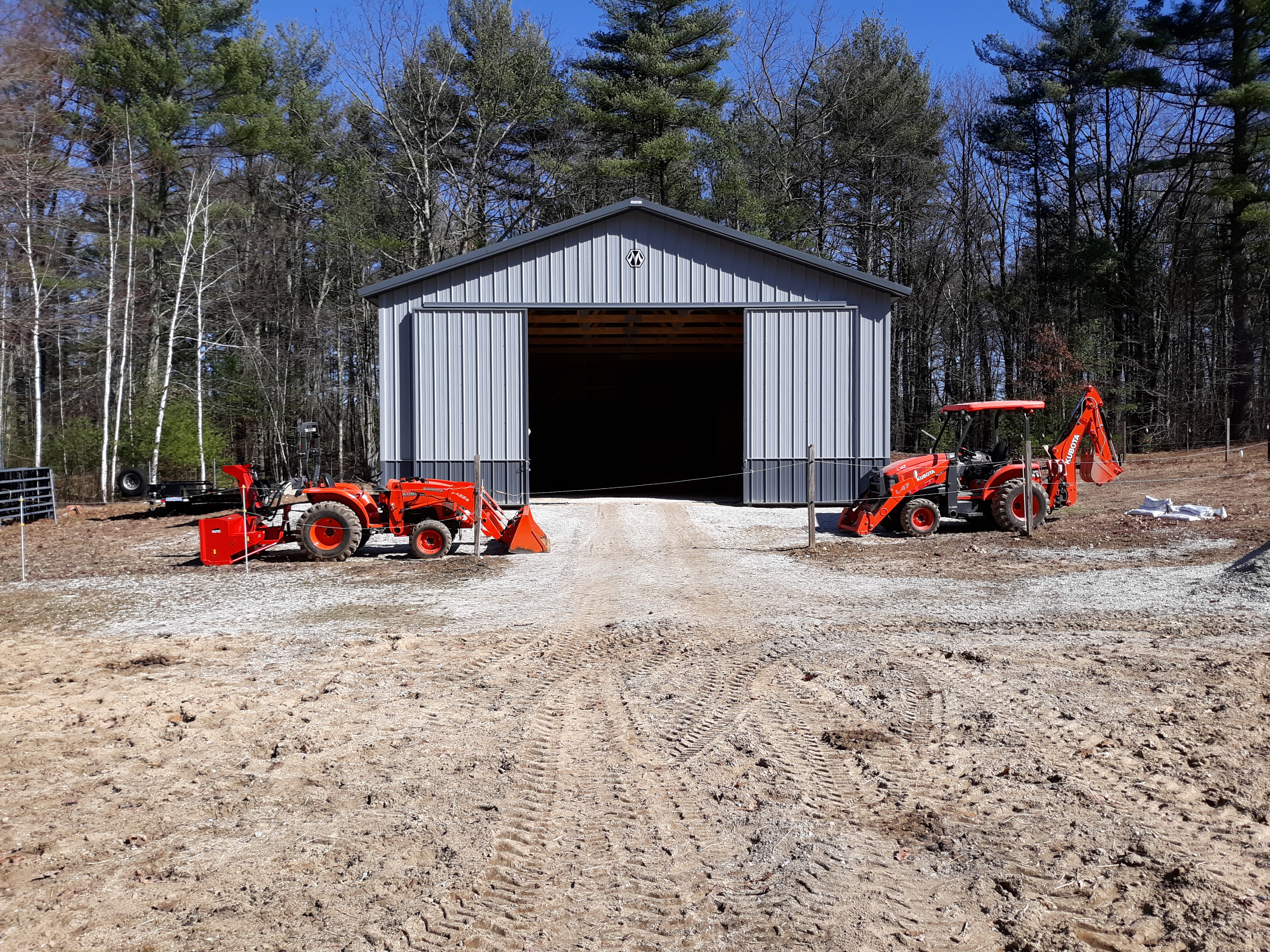

Another vote for Morton. They built my commercial shop in 1992 and it still looks great. Then they built my 36x53x14 toy box in 2003 and it's good too. They will use whatever siding, pitch, roofing, size, do they whole thing, just the shell, or anything in between.

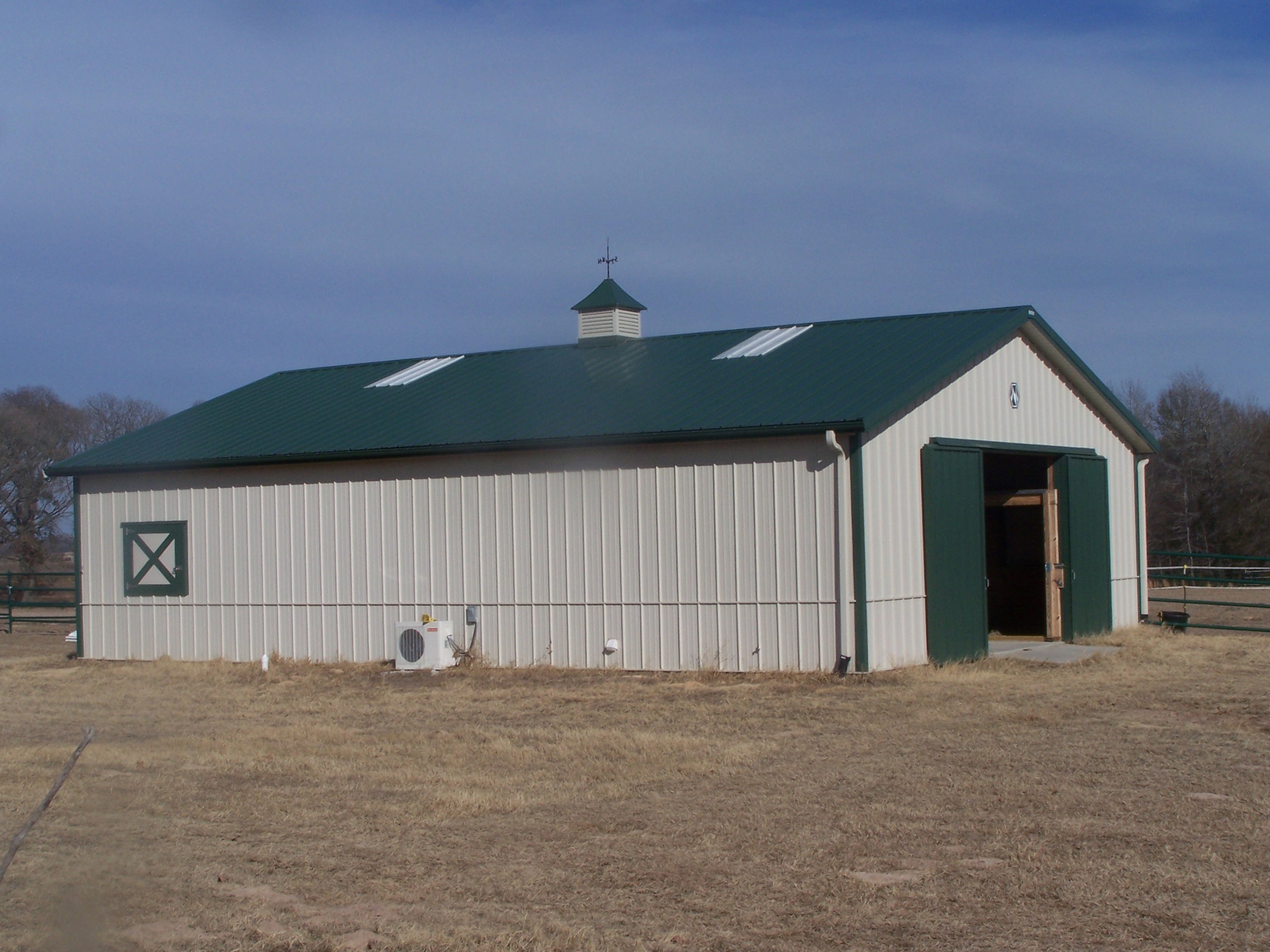

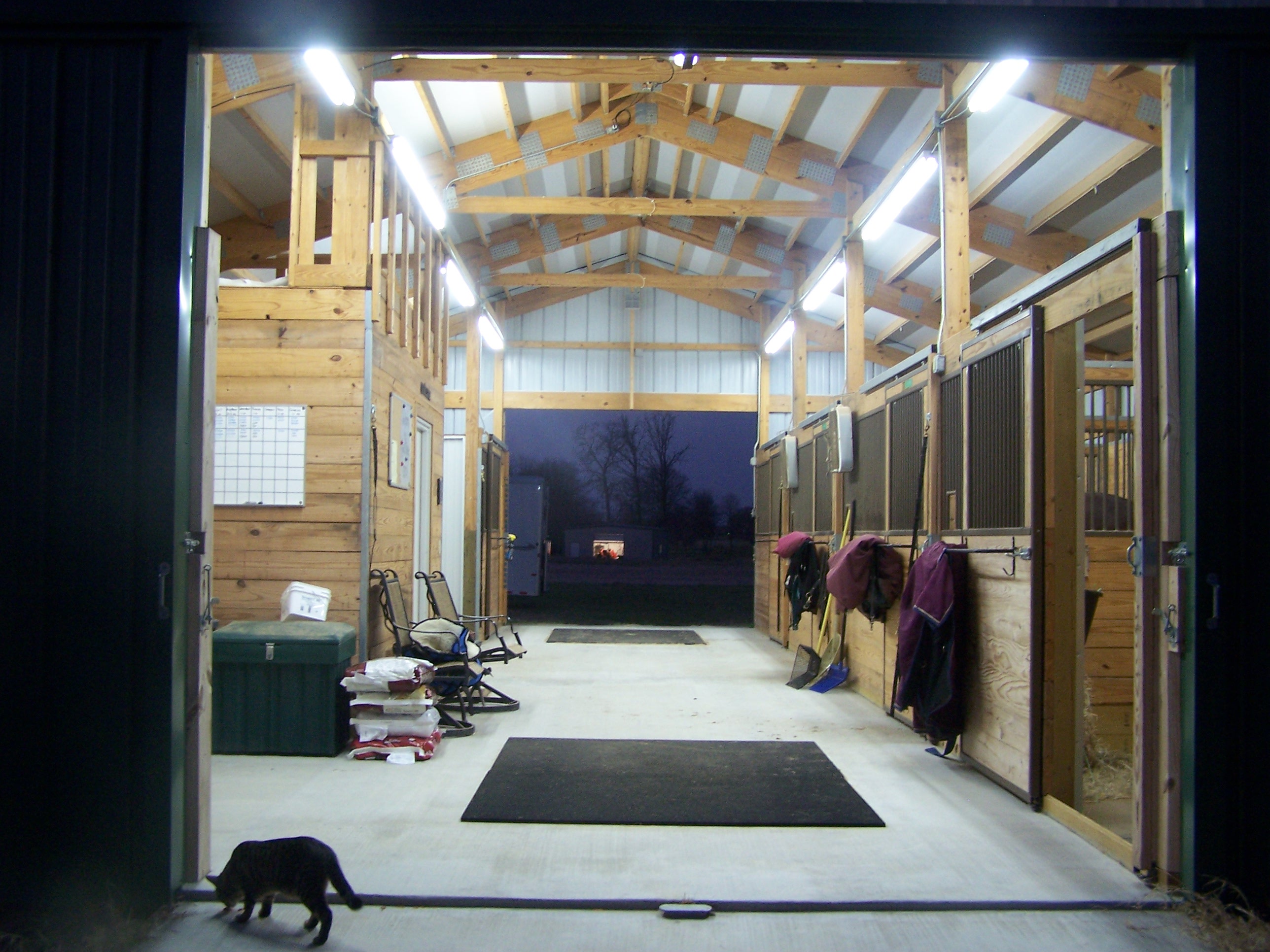

We went with Morton. Our stables are 10 years old now with zero issues. They are not the cheapest but are top quality.

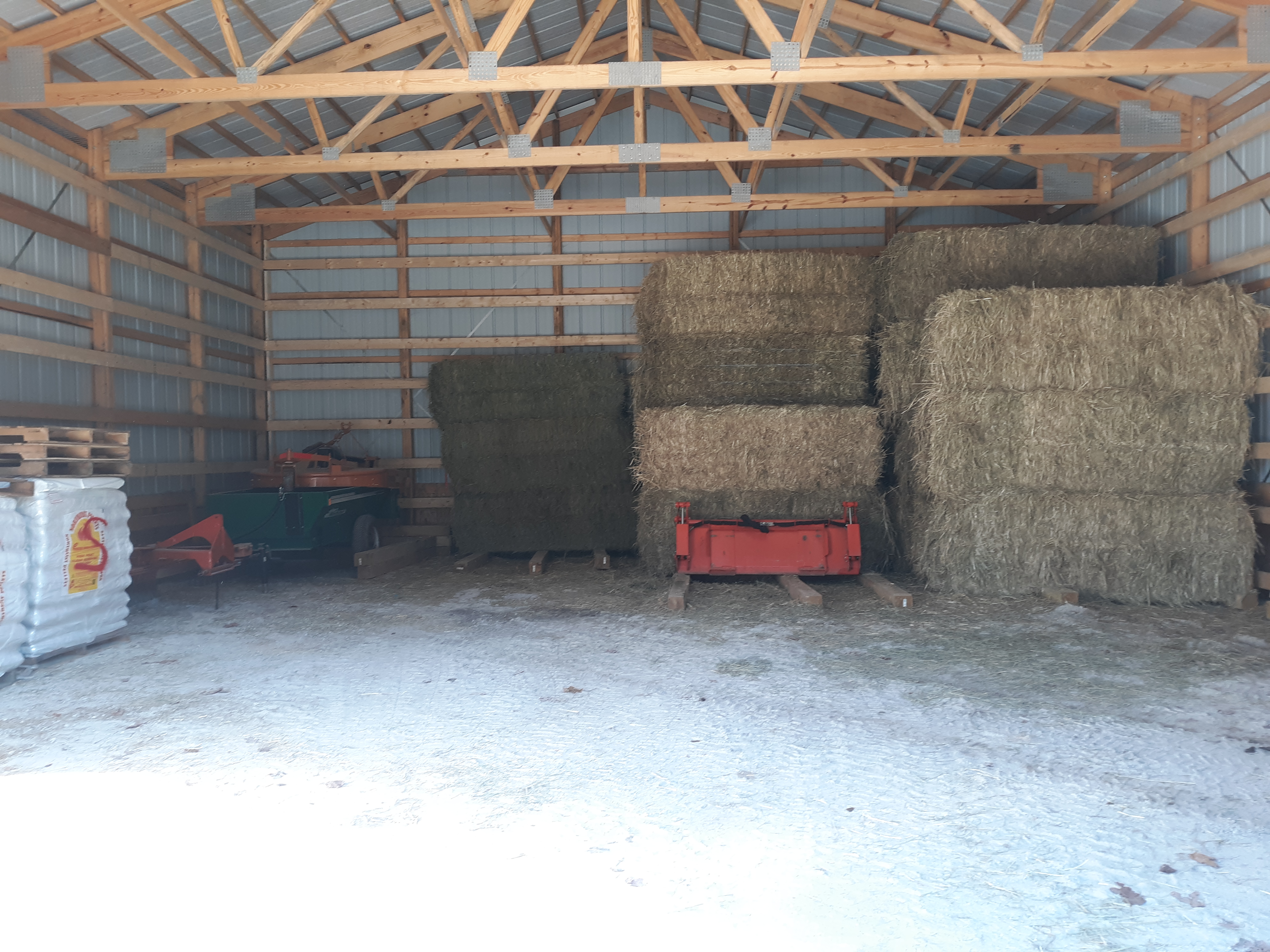

I put the 2x6 in so I would not push the siding out stacking the hay with the tractor hopefully it works......:rolleyes:

I'm at 40 yrs here in north florida:
20 - 12X12 stalls with center aisle and sliding doors
We've modified it severely over the years but it's in fantastic shape.
