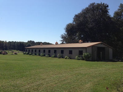

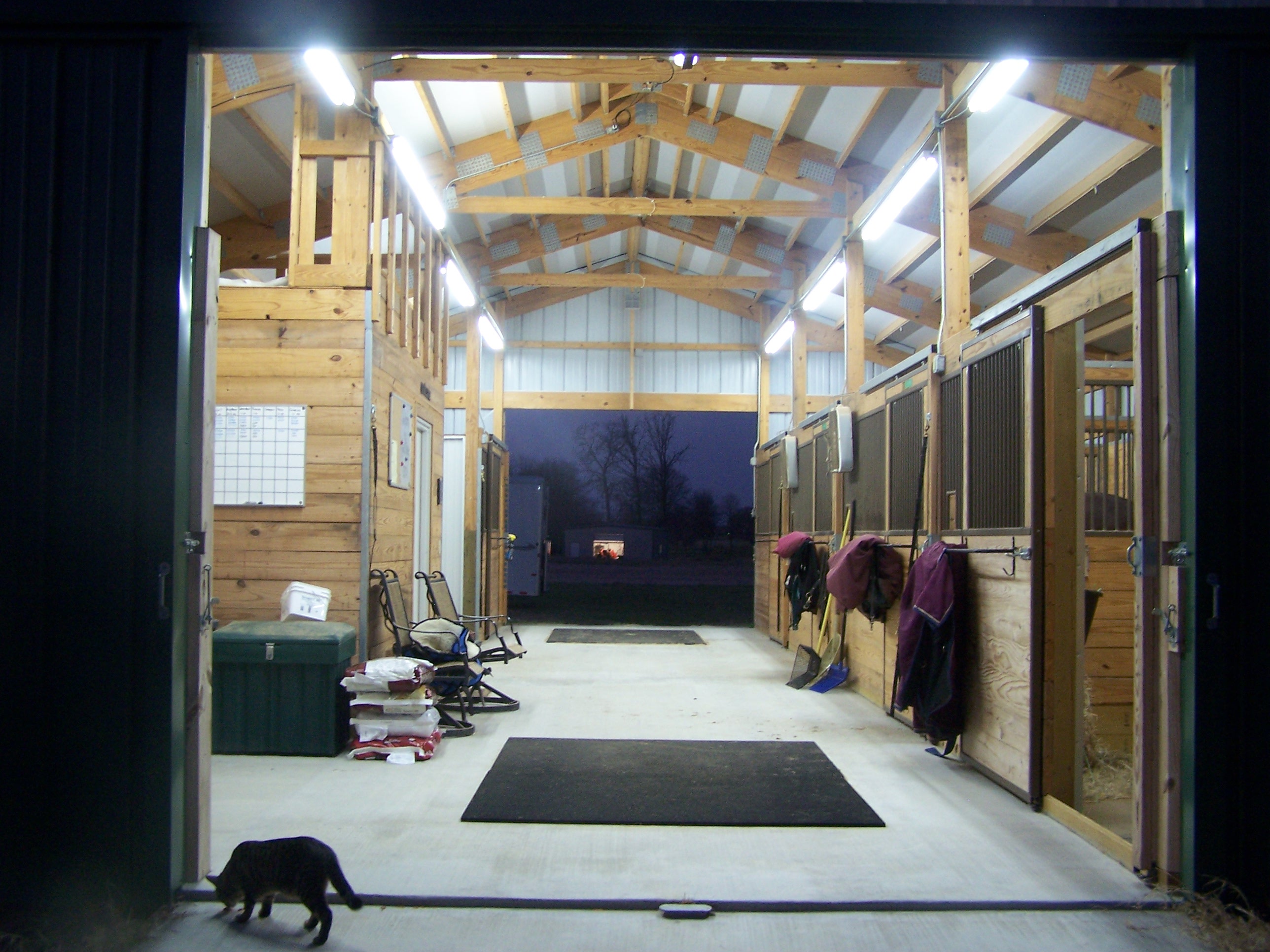

I'm at 40 yrs here in north florida:
20 - 12X12 stalls with center aisle and sliding doors
We've modified it severely over the years but it's in fantastic shape.
