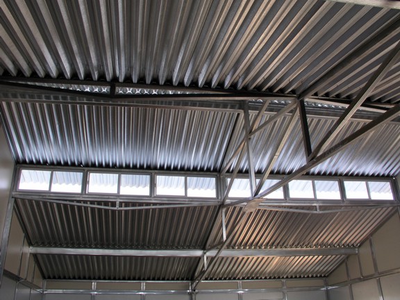

Size is approx 900 sq ft (37x24); cost for structure approx 21K, concrete 2K (with me doing all excavation and formwork).
