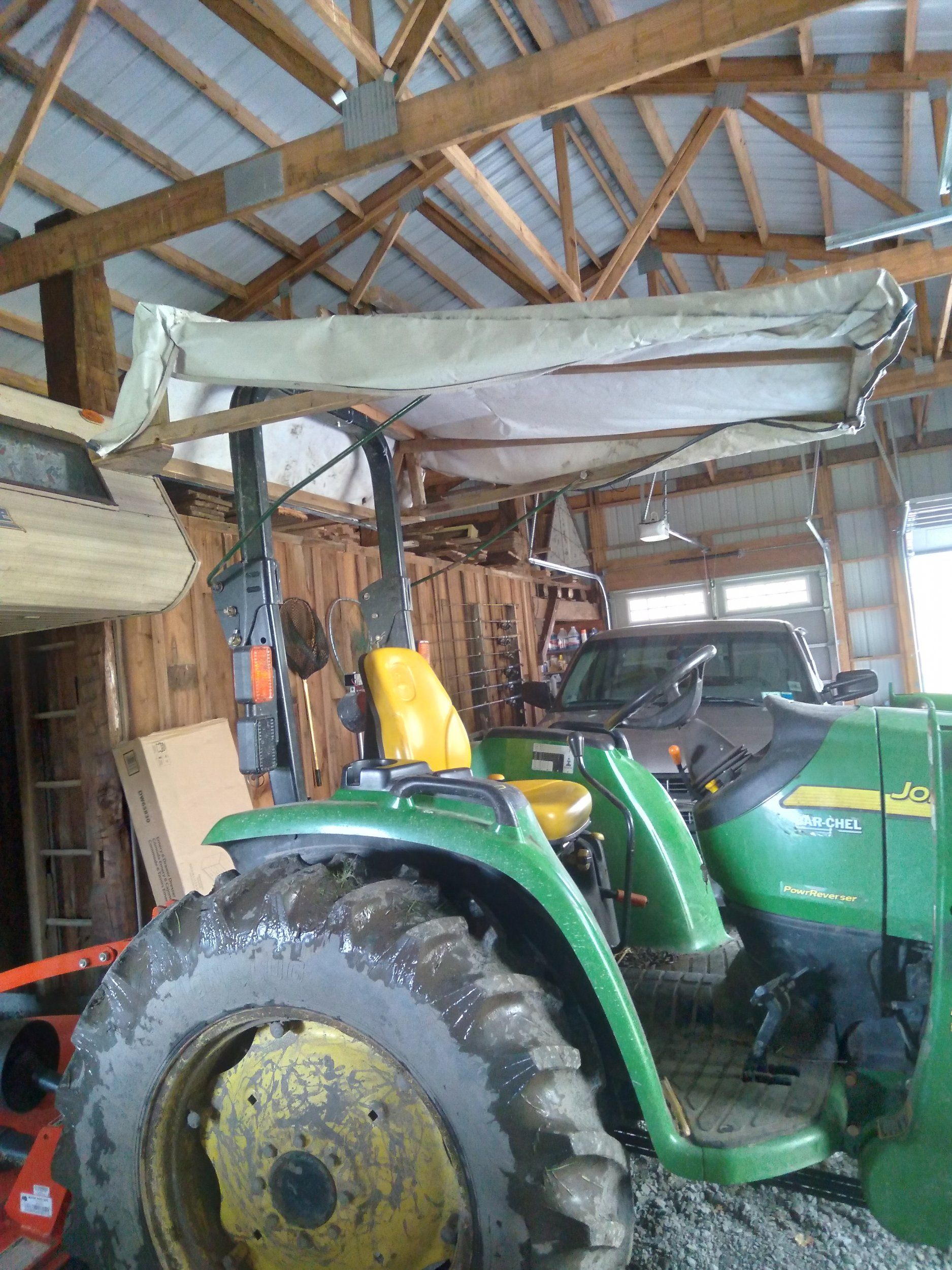

I prefer a canopy over a cab because I use my tractor a lot in the woods and for mowing along hedgerows where cab windows would be destroyed. Also, I am up north where AC is seldom needed.
A block heater, heavy duty loader bucket, and loaded rear tires are the only factory options I added. I prefer the standard gear transmission for most field work, much of which is with ground engaging implements and open field mowing.
Home made a accessories which I added were a hammer holder near the 3 point, a large wood framed, canvas covered removable canopy, a rear work light, bucket bolt on chain hooks, trailer hitch, center tree/ditch scoop, and loader arm mounted sprayer boom.
One factory option ths that was not available on the last new tractor I bought and I would have liked was hydraulic draft control. Fortunately, my antique Ford 8n has that, which makes it better for plowing unless the ground is too wet. If it is the 4wd of the JD trumps the hydraulic draft control.
   / For the newbies The best creature comfort add-ons to your tractor To consider when buying #68
You are way too cool!!! A canvas covered removable canopy! I think Kubota needs your ingenuity 😁
   / For the newbies The best creature comfort add-ons to your tractor To consider when buying #69
Here is a picture of the removable canopy. It takes about 2 minutes to put on or take off and weighs about 30 pounds. The canvas was salvaged from an old tent camper that my brother on law scrapped.
