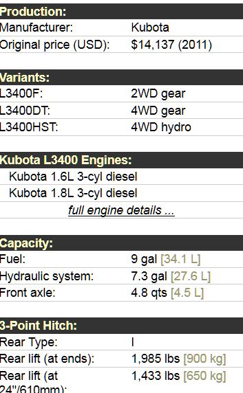

I see this: how are you planning on picking up 5000# on a tractor(L3400) that will only supposedly pick up 1985#s even with end of the 3 pt draft links? No one is going to have counterbalance weights to "your extremes". Here's what I'll do Tuesday, I'll take my M7040 with FEL to a certified scale. I'll weight frt axle with a rd bale on FEL no counterbalance weight then weight frt axle with bale of hay on frt & rear and report back. Well see how much difference in the ACTUAL WEIGHTS
.I believe in correct information on a discussion forum
   / For those of you who think the L3400 has a weak loader!! #50
I think he's talking about total weight.
Actually I'm referring to whether or not counterbalance on the rear of the tractor will """"significantly relieve the weight and wear from the frt axle"""" on a tractor equipped with a frt end loader with say 1000"s on the loader.
