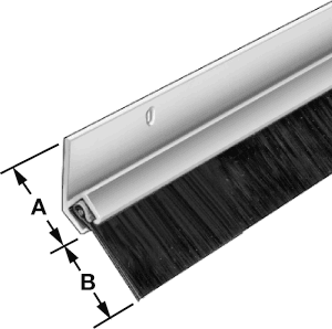

Check out Brush Seals. You could mount them under the fender on both side of the slots, and would not hinder lever movement.
Do a Google search also on the term "brush seal" for lots of different sizes and styles. McMaster-Carr has 3' pieces of flexible PVC backed stuff for about $40 that would work great.

+1 on what Kenny said! I was thinking about modifying something like the brushes that they use on shredders, but Kenny's plan is better..

In response to your drafts around controls, I have given some thought to this subject, I was going to fabricate some type of cover from the same material they use around overhead doors to seal out air leaks. It is mounted to a piece of aluminum and looks like the paint bristles of a hair brush. Chevrolet trucks use the same type of system around their 4-wheel drive floor mounted shift lever. You can buy this at www.mcmaster.com
