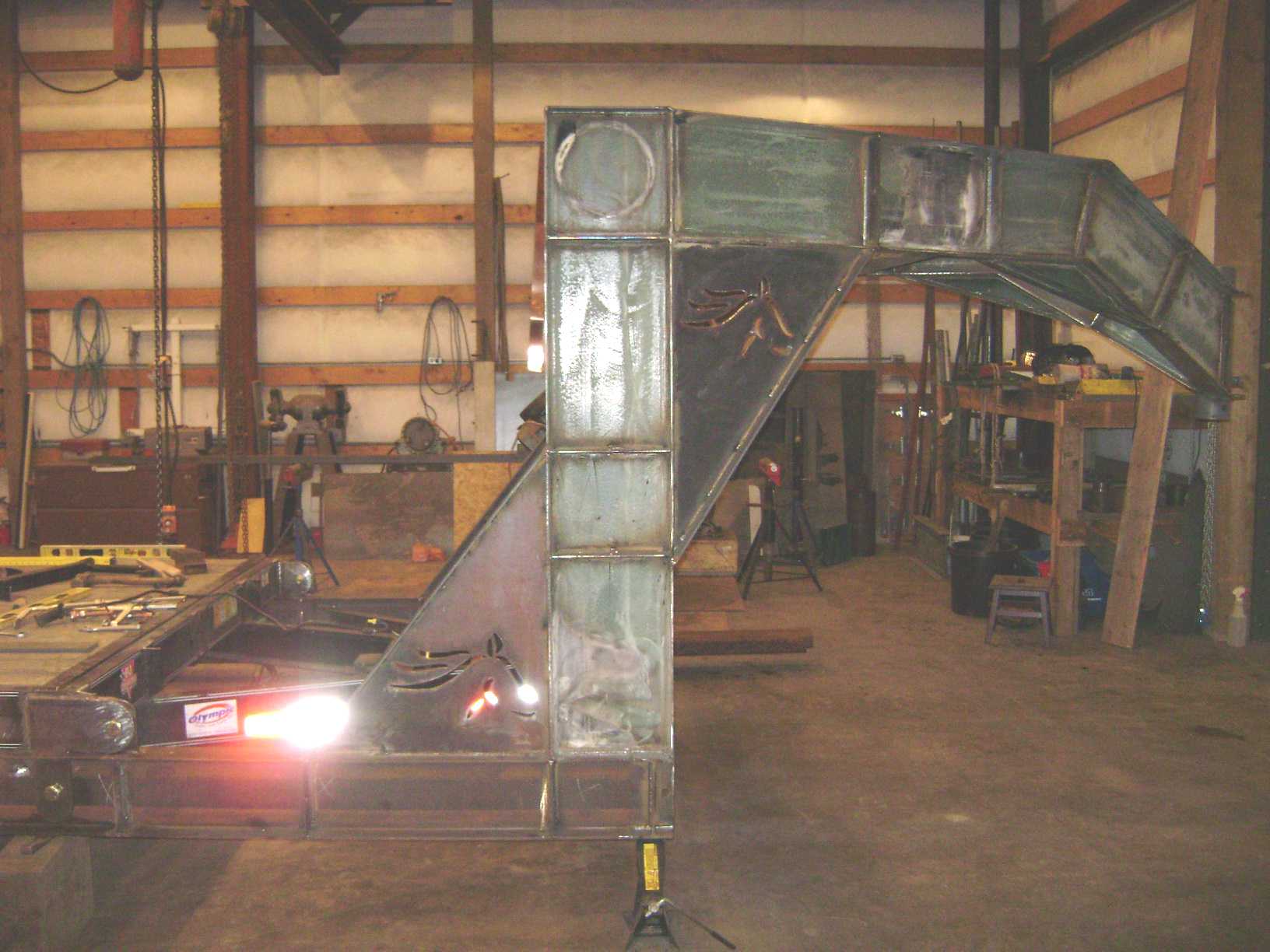

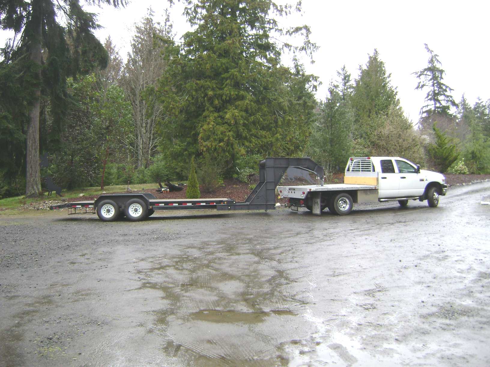

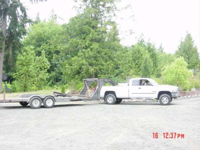

VERY cool..... i wouldnt mine doing that to my own gooseneck so i could fit my new larger tractor...but the axles are too light duty.
That happened to a buddy of mine when I built his. Latter he replaced his axles.
Don't jump right into doing this! With the cost of steel, paint, you'd be better off buying a used gooseneck trailer. I had my adapter Line-X'd which was less than half of the powder coat quote, not counting my labor I only saved $700.00 over buying a new gooseneck.
The horse heads are a nice touch.
Thank you! People comment on them all the time.

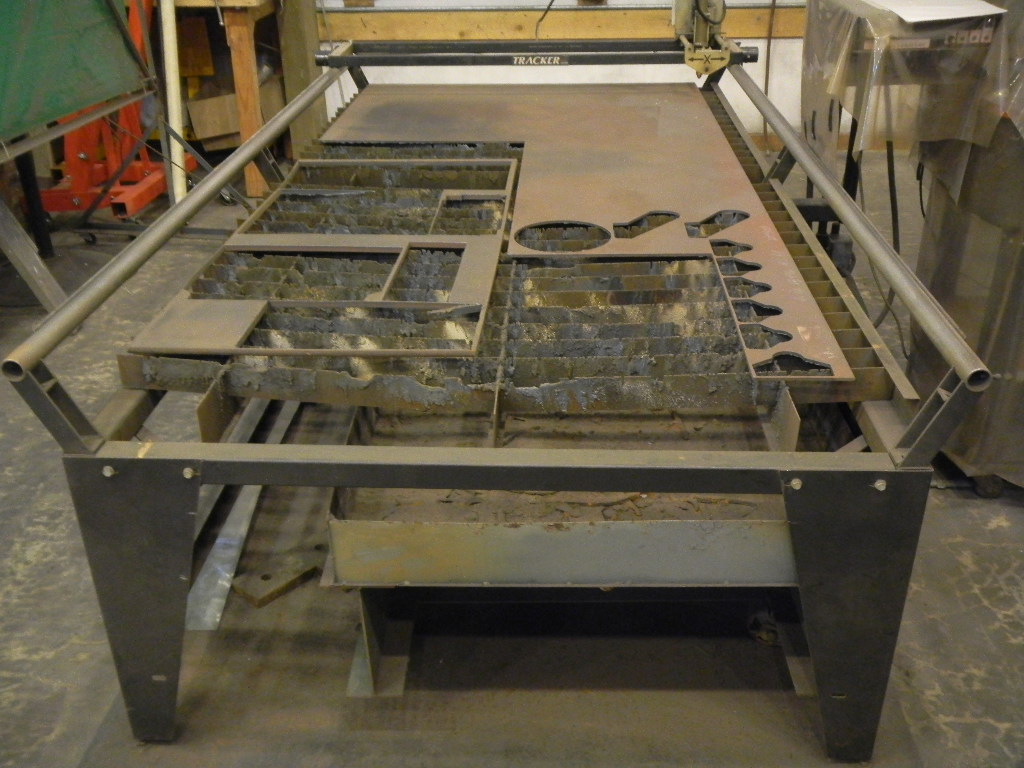

You may have told me, but I forget a lot:eek:. Do you cut over water? I built a removable tank for under my machine, really helped with the smoke / dust and believe it or not even with what little dross I got before cutting over water.
no, i have an air table under mine and suck most of the bad air outside. I wouldn't mind getting a water table but their kind of spendy, and i have not been getting any outside jobs for my plasma cutting anymore with this economy. I used to cut alot of timber frame construction brackets, etc. not any longer.
Does your water table tend to rust anything standing above it? My table has about 60 sheets of 3/16'x 54" x 4" slats of steel that make up the bed. I was worried that having a water bed would create a moisture pool that would rust my table. The one dynatorch offers is perminant...not portable water table.
   / For those with a Plasma cutter... #37
When I first heard about cutting over water, I didn't believe the reports. I really blew it when I built the tank:mad:. Not believing in the results, I didn't want to cut out the gusseted legs of my machine. So I built the tank too narrow, and too short. Now knowing what a huge difference it makes I wish I would have done it correct. The water should be just under the slats. Now some of the better class machines have the slats underwater, and the material sets in water. I never noticed my slats rusting, but who could tell with so much slag on them.:laughing:
   / For those with a Plasma cutter... #38
Thats a good idea. the table that Dynatorch sells is like $3,000
Maybe ill build a small portable water table that i wont have to leave under there. And put it on wheels so i can roll it under....
hay.. i have a new project to work on. thank you
