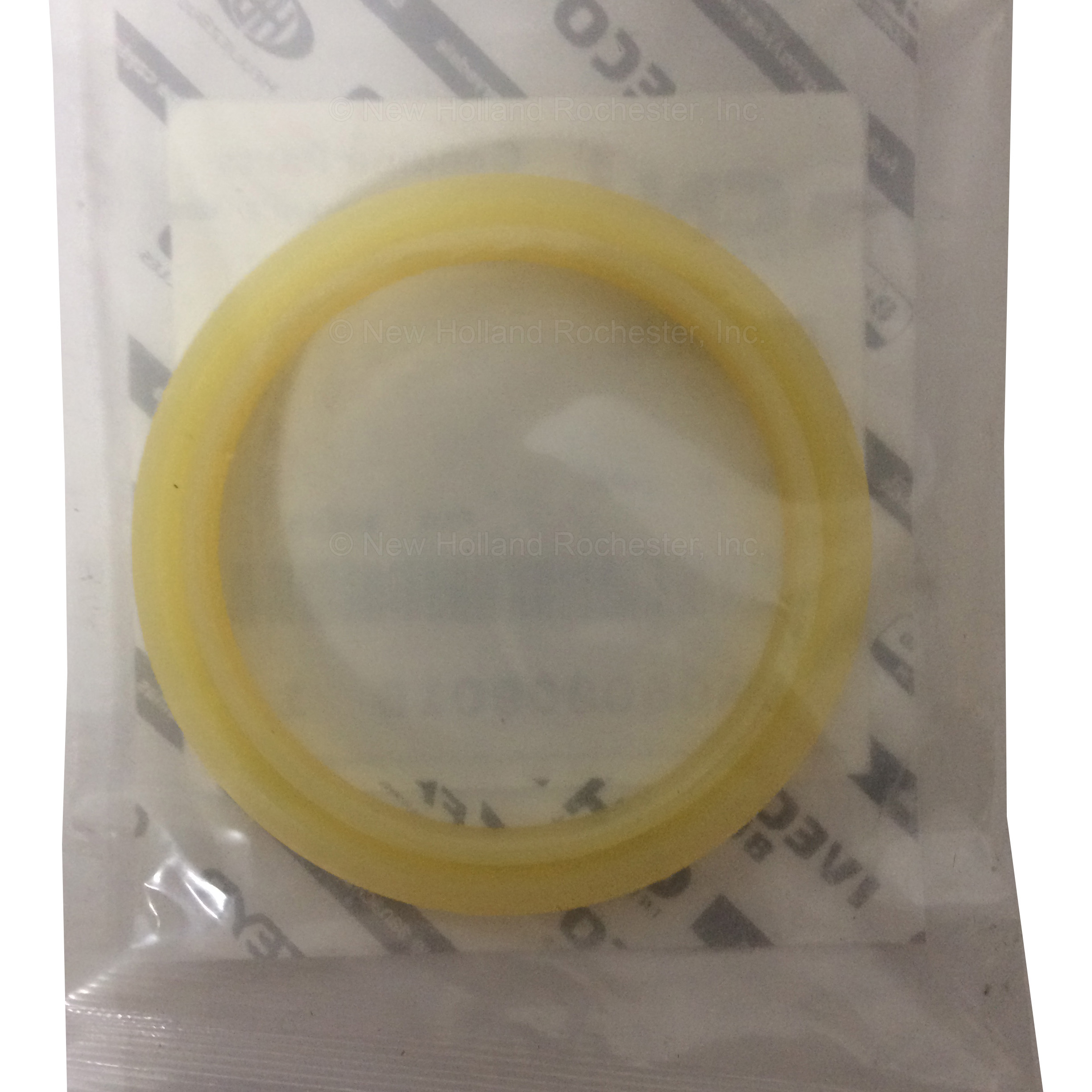

Ut oh. Thats not good. So i guess the filters are like the seal, none made anymore? I found , after i paid high dollar for one, the size of the seal and you can find them on Ebay for way less than $10 dollars. I simply measured the high dollar one and recorded it and looked on Ebay and they are there. From China and takes a couple of weeks to get. Size is 48MM x 60MM X7MM. Got two on them on the way.
Thanks for that info. Will dig out my cleaning materials.
I have a diagram of your rig. It is a bit different with ford 1700. Some of the stuff I said with the rock shaft is a bit different. SBA050309016 is the seal you need. I did a quick search and was not able to find. NH might have it. below I have a parts look up and see if you can order one. I did not want to sign up. when I overhauled my hyd system , I paid about $8 for the seal and pump overhaul kit under $30. Now , I wished I bough a spare just to have it. Now they want two arms and a leg for it. lol.

Dang, NH has it for $57 now. I just wished I bought an extra. The first one lasted 25 years.. not too bad.

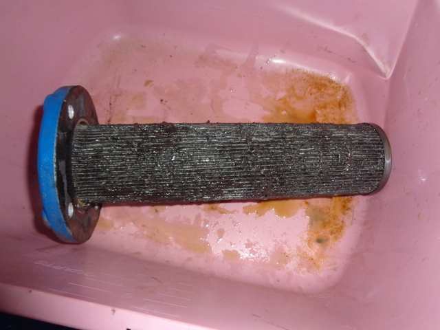

I addressed that in couple of posts earlier. Need to re-use. Now if I destroyed the the screen then I would have Jerry rigged some in line filter of some sort. Remember that the screen is on the suction side of the pump and does not see much pressure, so it does not need to be so robust. See the before and after below.View attachment 882061View attachment 882062
WOW, thats amazing how it cleaned up. Mine is in far worse shape. It is made of PAPER and it twisted out of shape, like somebody has tried that before. Gonna give it a shot anyway. That INLINE filter is a great idea and i may just try/do that. Thanks for the pics. BTW i just now put the cap back on without the filter and cranked the engine and that lift popped right up. Shut it down immediately. I DO KNOW it was the filter. Never would have guessed that.

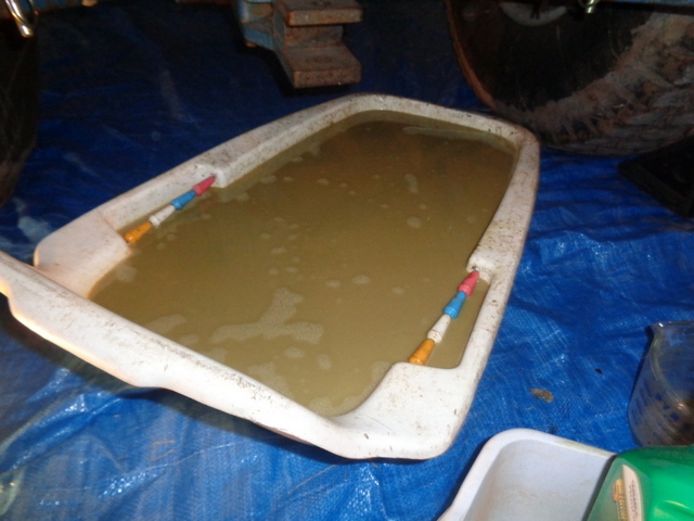

Nothing last for ever! it is perfectly normal. Older seals were based on Nylon. imagine how much heat and pressure they are exposed to. They turn brittle after a long use. Diffy reservoir is atmospherically vented so you will bring moisture in, oil gets oxidized and then turn to very weak acid mixing with other contaminant could cause less lubricity of the hyd oil and more abrasive. This is how my oil looked like after storing the tractor outside under a tarp during my 2 yr home construction. That oil is not good for any seals. New tractors now use rubber seal and also a backer seal , they have improved it a lot. saying that , Ford 1000 series Have an excellent hyd design and so simple to maintain. There is so much disassembly is required on my kubota just to get to the seal, doable but a pain for sure!
