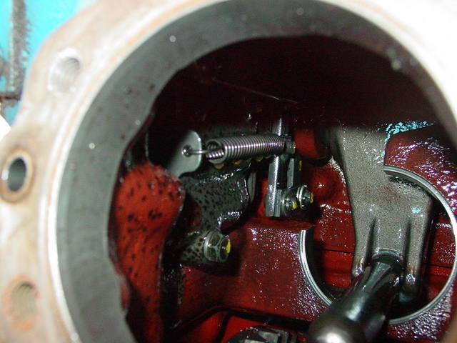

I have a diagram of your rig. It is a bit different with ford 1700. Some of the stuff I said with the rock shaft is a bit different. SBA050309016 is the seal you need. I did a quick search and was not able to find. NH might have it. below I have a parts look up and see if you can order one. I did not want to sign up. when I overhauled my hyd system , I paid about $8 for the seal and pump overhaul kit under $30. Now , I wished I bough a spare just to have it. Now they want two arms and a leg for it. lol.

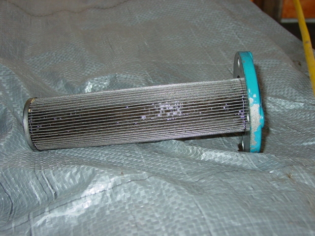

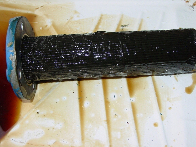

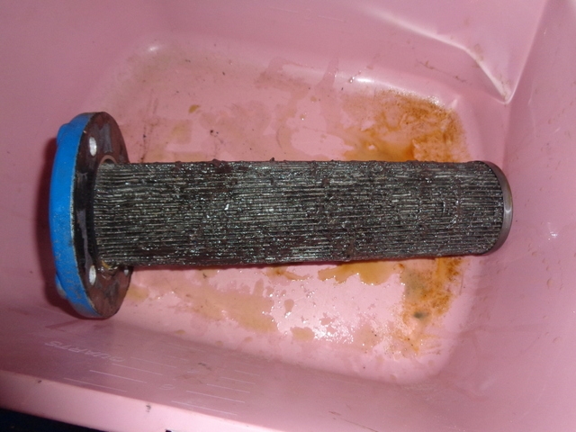

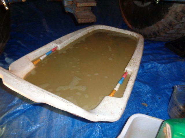

I addressed that in couple of posts earlier. Need to re-use. Now if I destroyed the the screen then I would have Jerry rigged some in line filter of some sort. Remember that the screen is on the suction side of the pump and does not see much pressure, so it does not need to be so robust. See the before and after below.View attachment 882061View attachment 882062
WOW, thats amazing how it cleaned up. Mine is in far worse shape. It is made of PAPER and it twisted out of shape, like somebody has tried that before. Gonna give it a shot anyway. That INLINE filter is a great idea and i may just try/do that. Thanks for the pics. BTW i just now put the cap back on without the filter and cranked the engine and that lift popped right up. Shut it down immediately. I DO KNOW it was the filter. Never would have guessed that.

Just to let you know about that filter i THOUGHT was paper. Turned out it was just coated with a jelly like material that looked like cardboard. It actually is metal and i dont know why it was all twisted out of shape. Maybe previous owner got a little rough with it. Anyway, i will clean it up and reinstall , when the rains stops.

I seriously doubt if the original screen was paper. That screen or i line should be structurally strong enough so the pieces would not go thru your hyd pump. It can't chew it u without self destructing and that is high $$$$ cost. I overhauled my hyd pump about 20 years ago and complete kit was under $30 then.

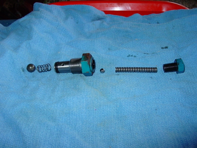

There are also two O rings easily accessed in the drop rate control - which is usually a knob under the front of the seat. That drop speed control is usually the culprit when a 3pt hitch will not stay up. It is simply a valve that controls the rate at which fluid leaves the 3pt lift cylinder.

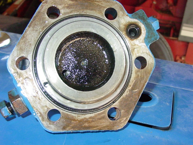

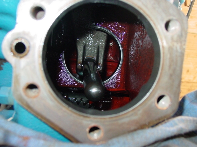

If you search my posts, you will see where I had a lift that wouldn't go down, and it was due to the head over the piston being installed 180 degrees incorrectly.
Scotty,
The return path of hyd oil flow from lift cylinder is through rate of return back to spool valve. So only leaky spool or lift piston seal could be the cause of 3 point drop. The knob simply establishes how fast or slow 3 point goes down and nothing more.

yup, that is exactly right. The head is symmetrical and that mistake can happen. when I did mine I made sure oil path way with the O-ring is in right orientation.
If you rotate the rate of return all the way to turtle then effectively you block the oil return and cannot lower. if 3 point is all the way up and then you turn the rate of return to turtle/closed and 3 point comes then , then for sure it is the seal bypassing the oil to diffy and lowering of the 3 point arms.
David from jax
Yes, i figured that would happen so i took pics of it before i took it apart. But my problem was the filter was completely clogged. Never even thought that would happen.

Yes, it works great. It was the filter plugged up . Cleaned it and works great. Yes on the parts being hard to find. That seal is very expensive and the dealers who still have it have jacked the price up so high it is insane. Greed has is out of hand. So after i paid high dollar i got it and measured it and found on Ebay for less than $10 dollars. Size is 48MM x 60MM X7MM. Will keep them in stock. No need to get ripped off by greedy corporations. Othe parts are just not available and impossible to replace and best to just scrap the tractor for remaining parts. My next job is the front wheel drive. I think the rear u joint is broken. I can probably find a replacement cause u joints of all sizes are available.

Glad you found the issue and were able to correct the issue. In my case, I actually scribed a line across the head and onto the base, so that a mistake wouldn't happen. Unfortunately for me, the head had already been removed, and me scribing a line only made it more difficult for me to realize that the scribed line was incorrect!
