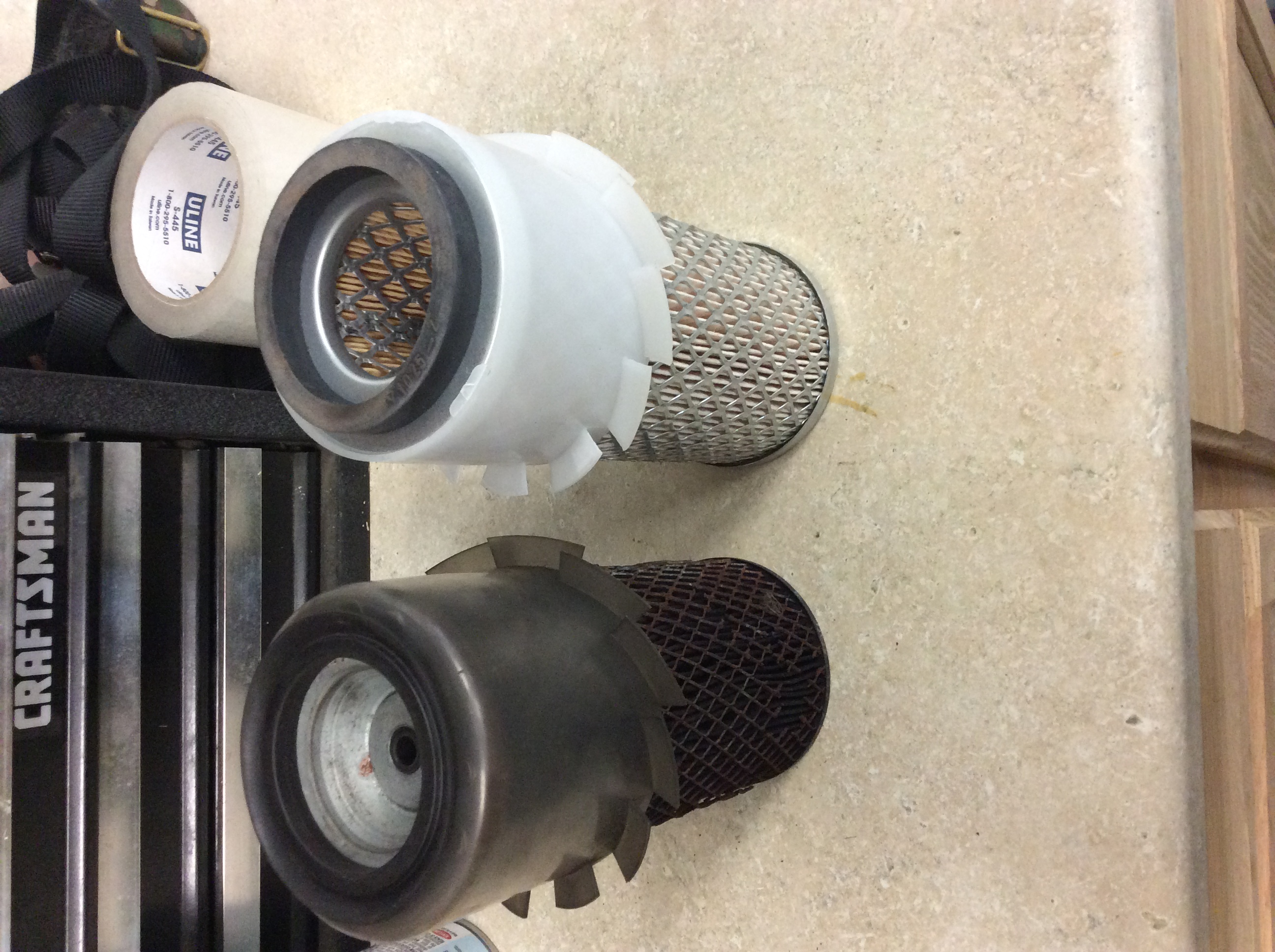

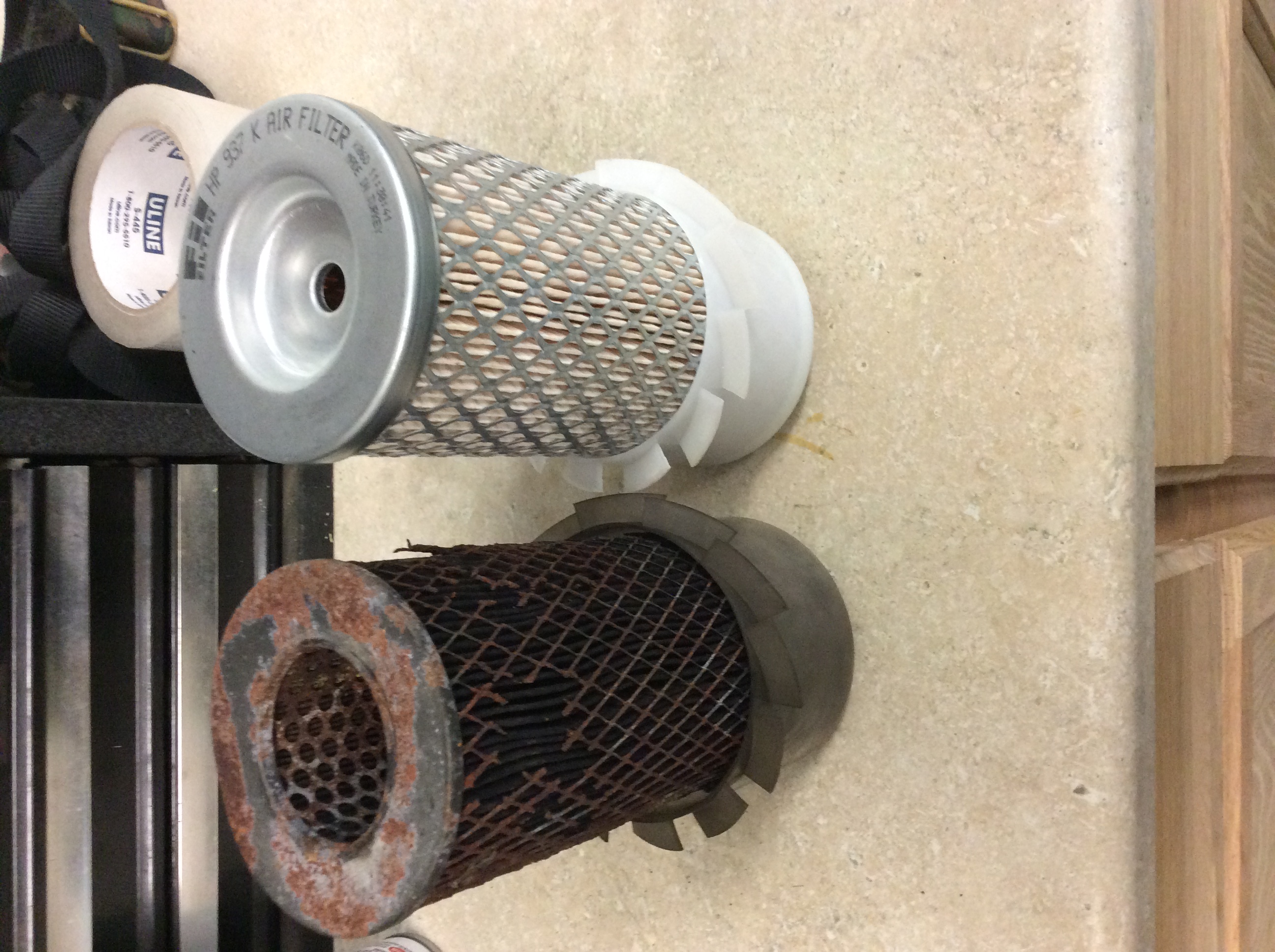

Got a few filters changed today.
The cover for the hyd filter removed. There was an o-ring on the cover plate that I did not see in the parts manual. Anyone have a part number for me?
The old and new filter side by side. You can see all the trash in the old one.

I never did find an o ring for it, but mine didn’t leak so I just reused the old one.
The filter I believe I got from Messicks, but I can’t be certain, it’s been awhile.

My o-ring was in really bad shape after splitting the tractor - this is what I used and it seems like a perfect fit:
M2x65 Viton O-Ring, 75A Durometer, Round, Black, Viton, 65 mm ID, 69 mm OD, 2 mm Width
