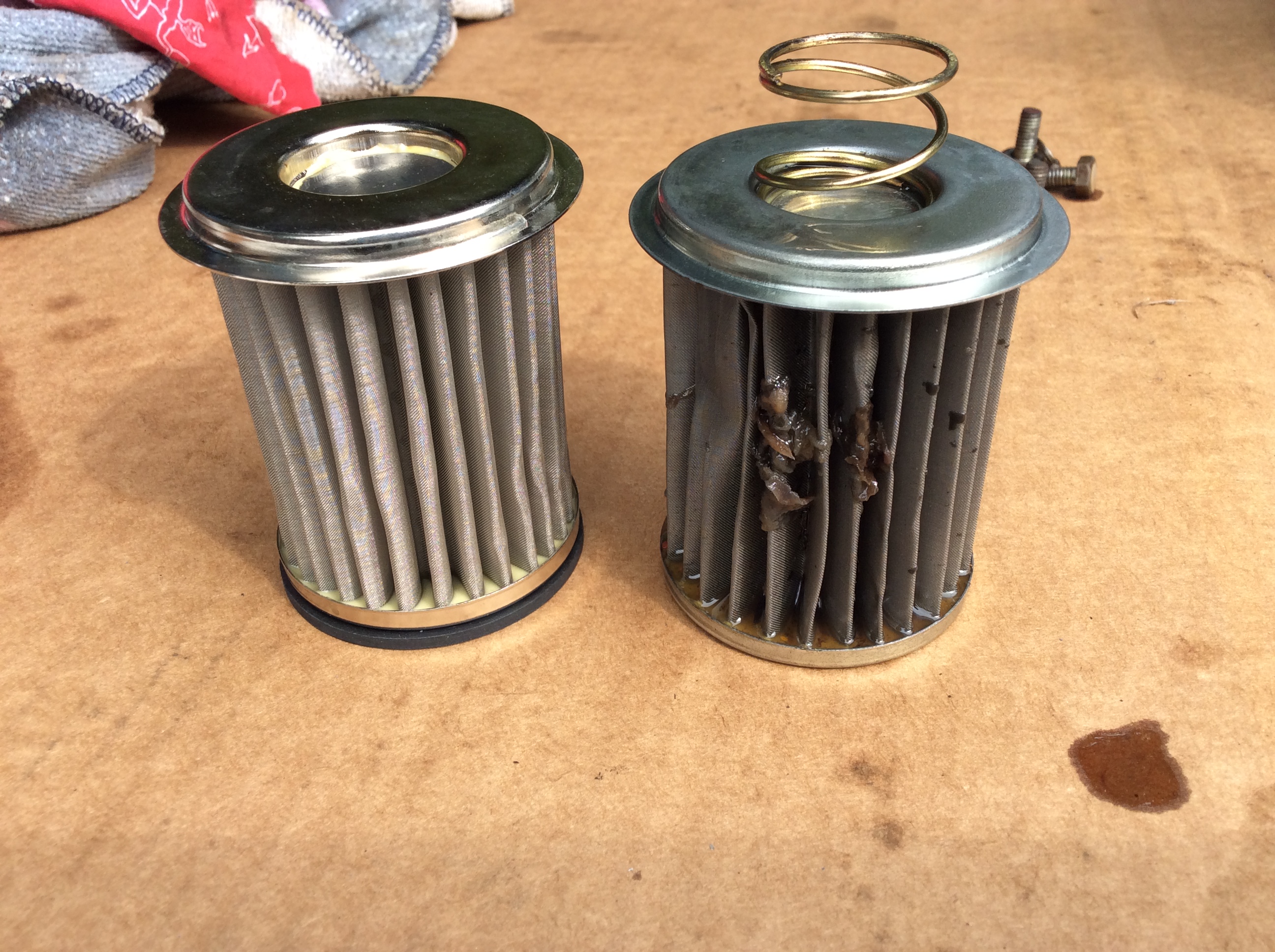

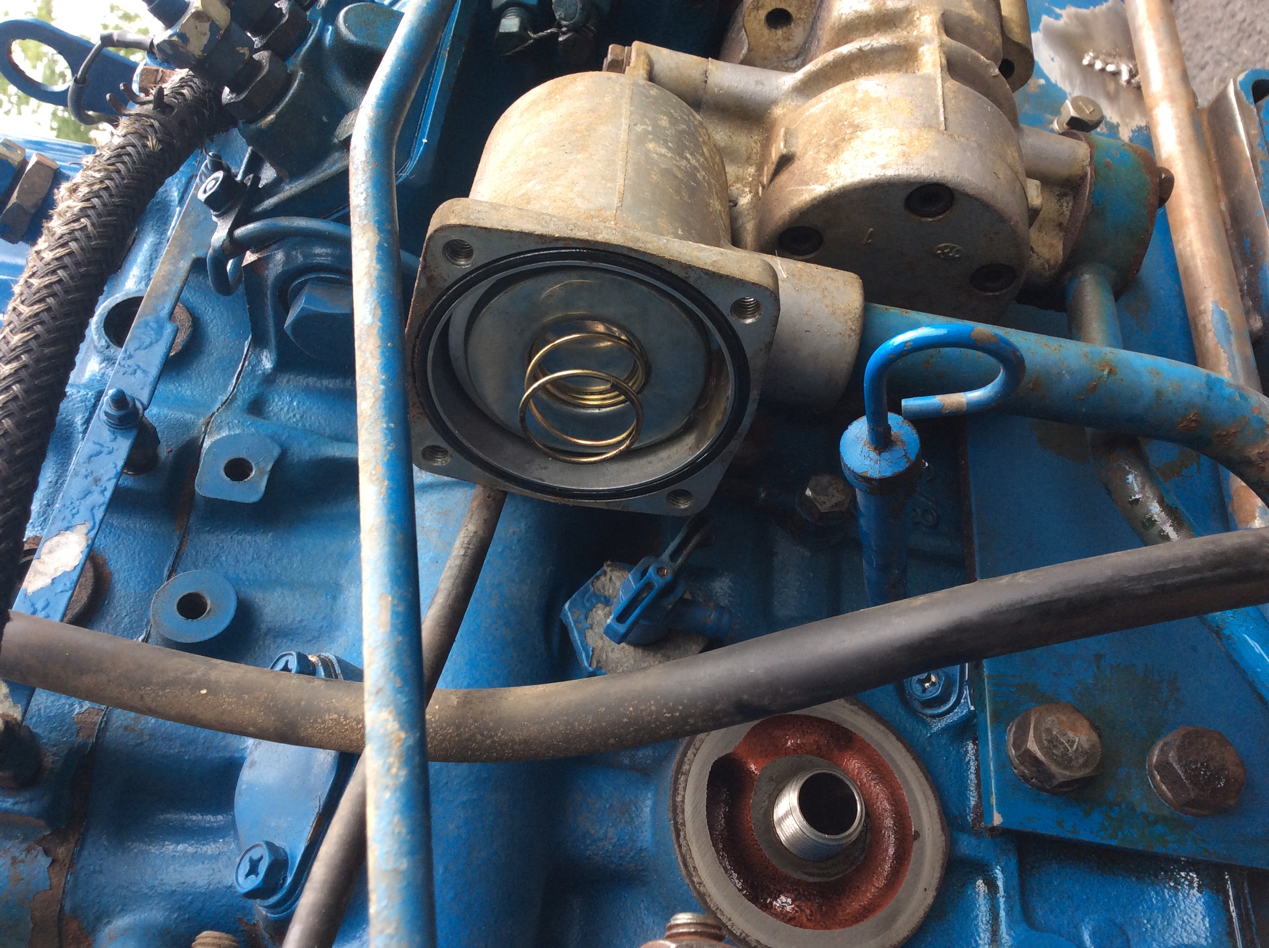

Got a few filters changed today.
The cover for the hyd filter removed. There was an o-ring on the cover plate that I did not see in the parts manual. Anyone have a part number for me?
The old and new filter side by side. You can see all the trash in the old one.
Did you ever find the part number for the o-ring on the filter cover?

I never did find an o ring for it, but mine didn’t leak so I just reused the old one.
The filter I believe I got from Messicks, but I can’t be certain, it’s been awhile.

My o-ring was in really bad shape after splitting the tractor - this is what I used and it seems like a perfect fit:
M2x65 Viton O-Ring, 75A Durometer, Round, Black, Viton, 65 mm ID, 69 mm OD, 2 mm Width
