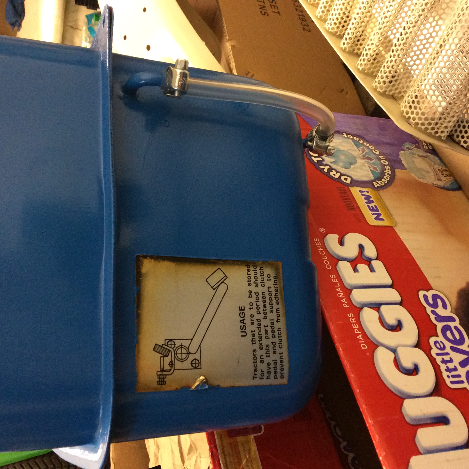

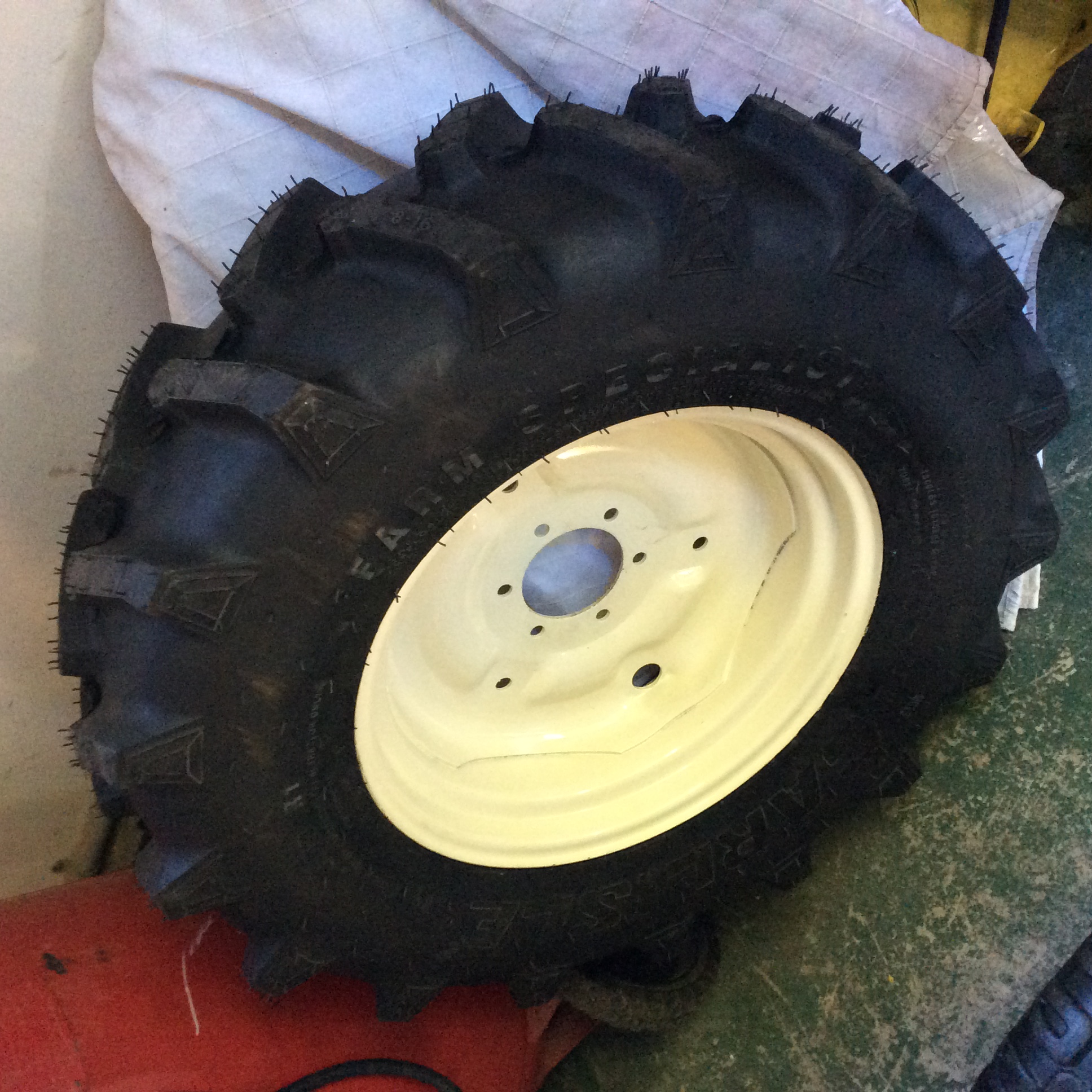

Today I got the front tires mounted and new valve stems installed.
Also got the new sight gauge installed on the tank. You can see the clutch relief sticker also for long term storage.

What did you use for the fuel sight gauge? Mine is a black rubber hose and I have a wooden dowel I check fuel level with. Gets old sometimes.
   / Ford 1210 tear down and repair
#84
It was some clear fuel line for lawn mowers. Will see how it holds up.

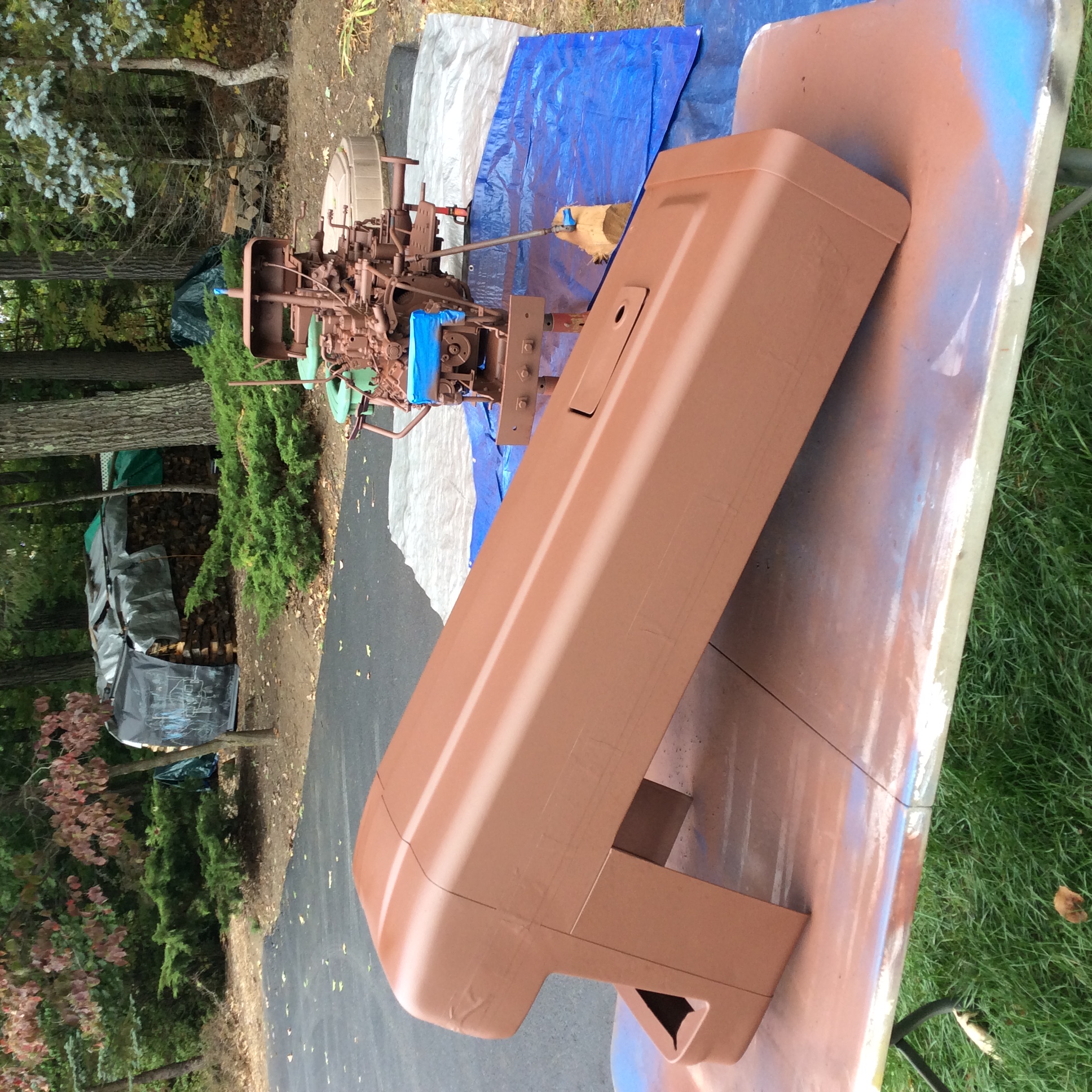

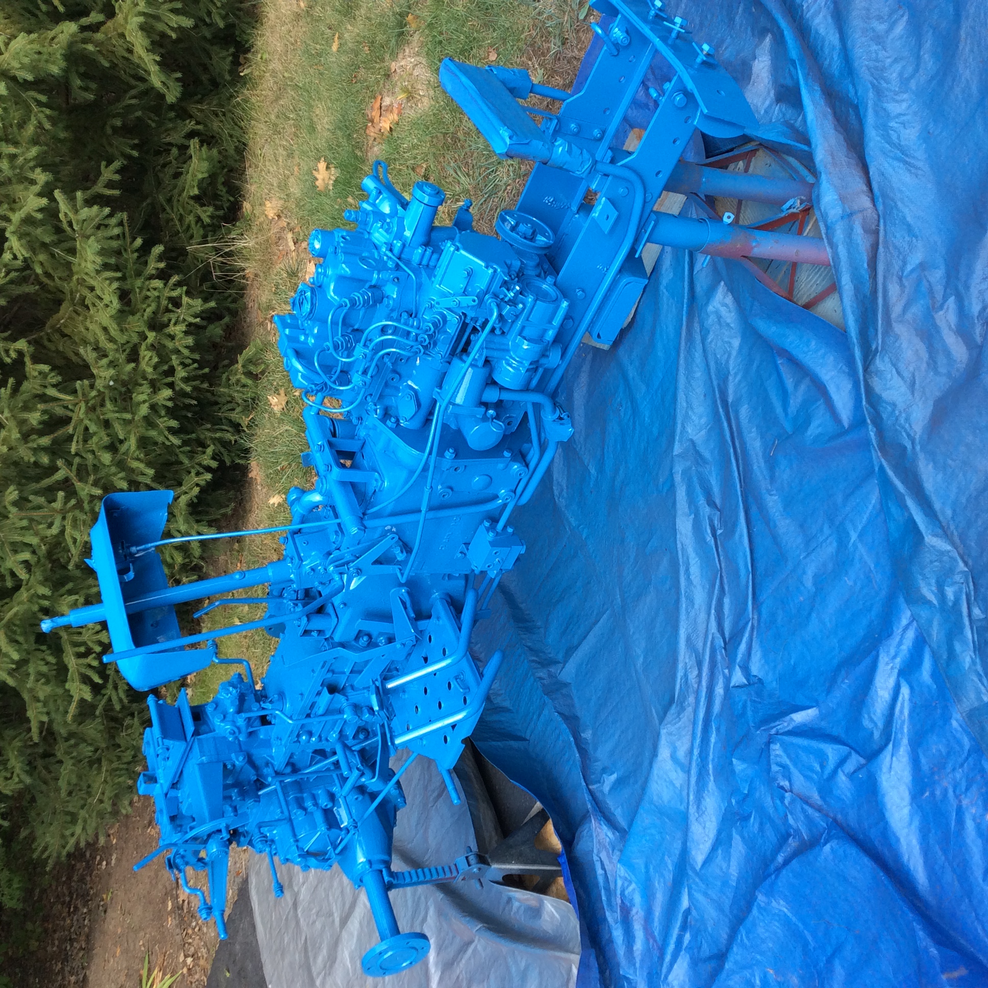

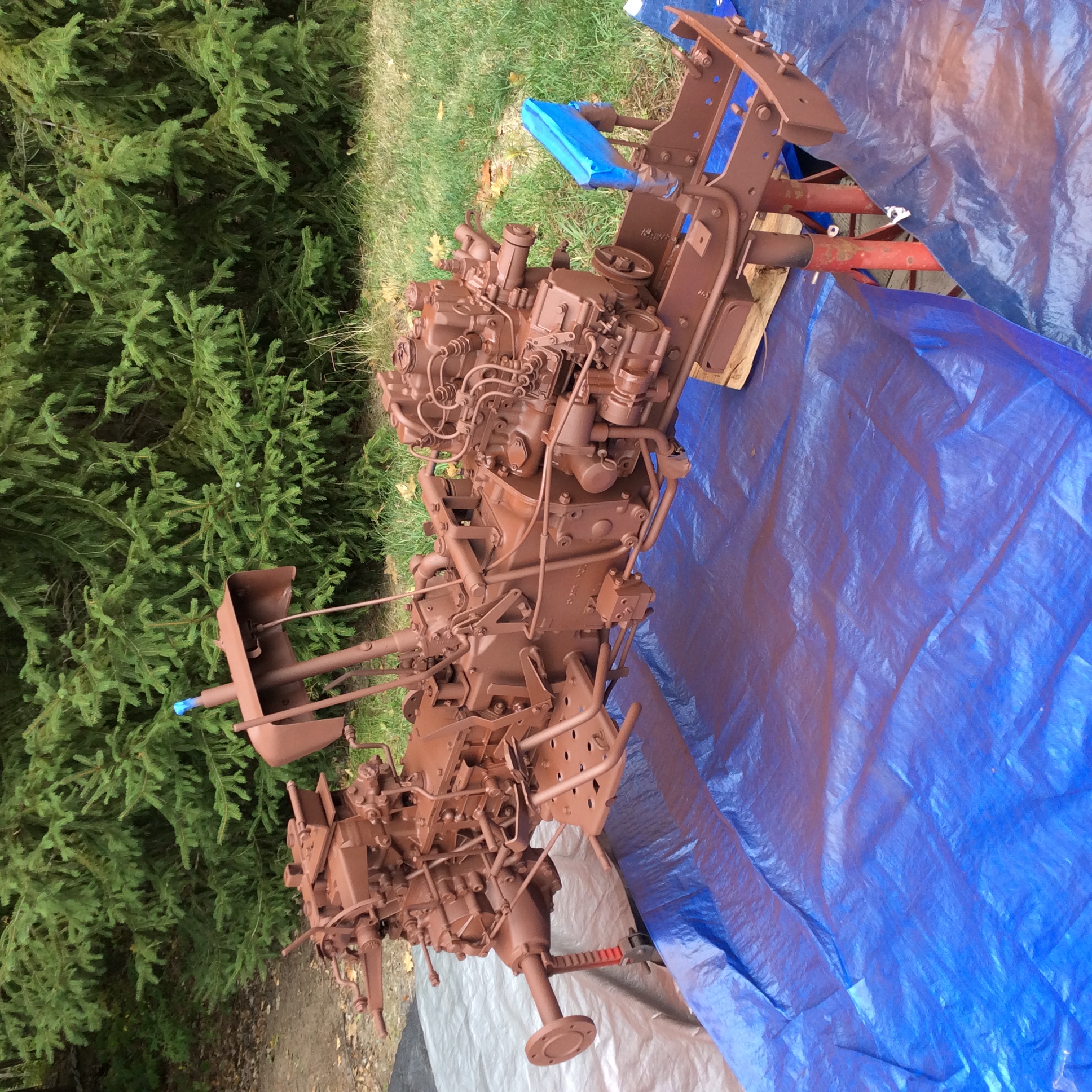

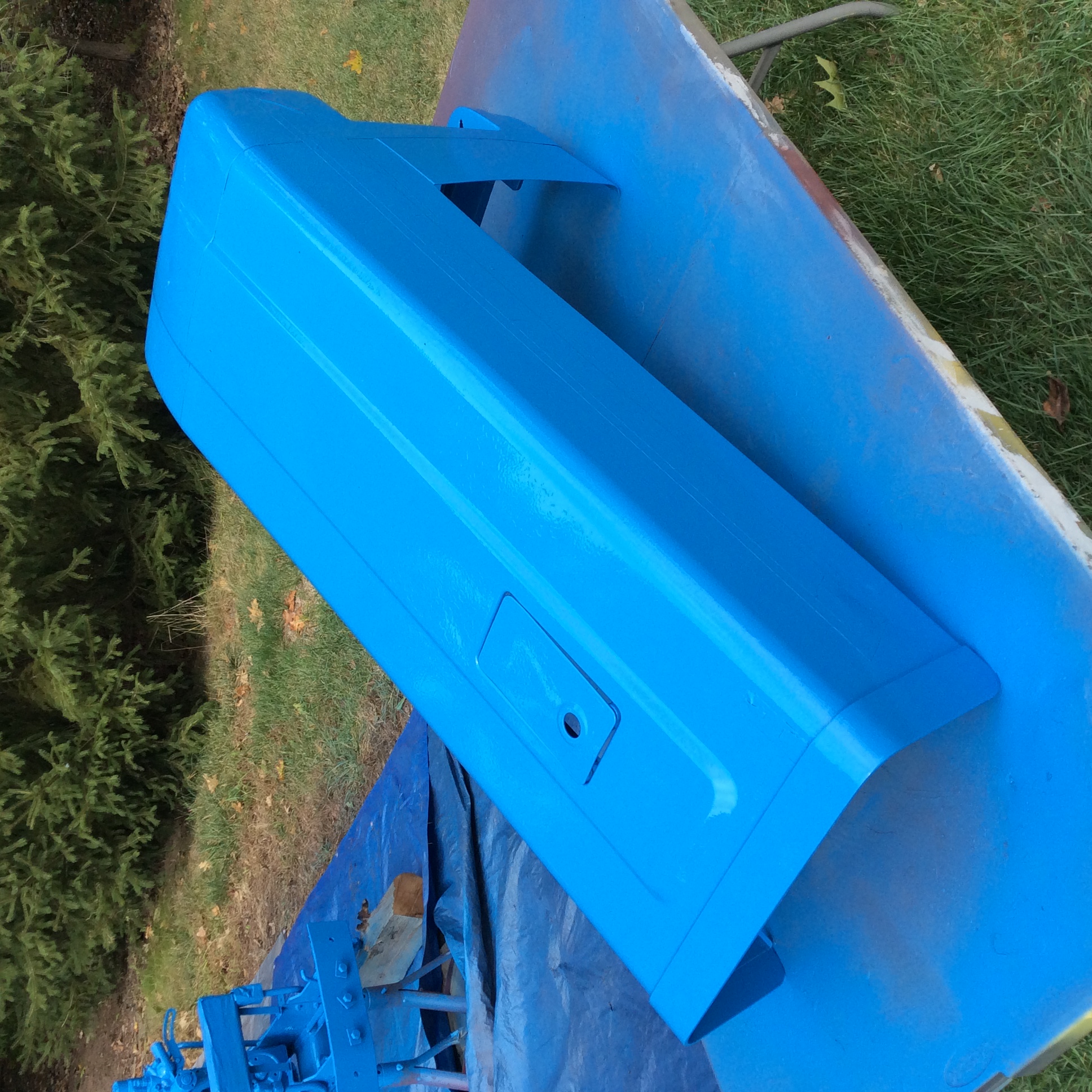

Last of the painting is done. The bugs had a field day landing in the fresh paint...:(
#86
All nice and pretty again.

Got the new tire mounted today. I was going to try and do it myself, but decided for $18 it was worth it to save my back. No scratches on my rims either, was amazed!
The paint is taking a long time to dry. Going to be awhile till I'm able to reassemble this thing.

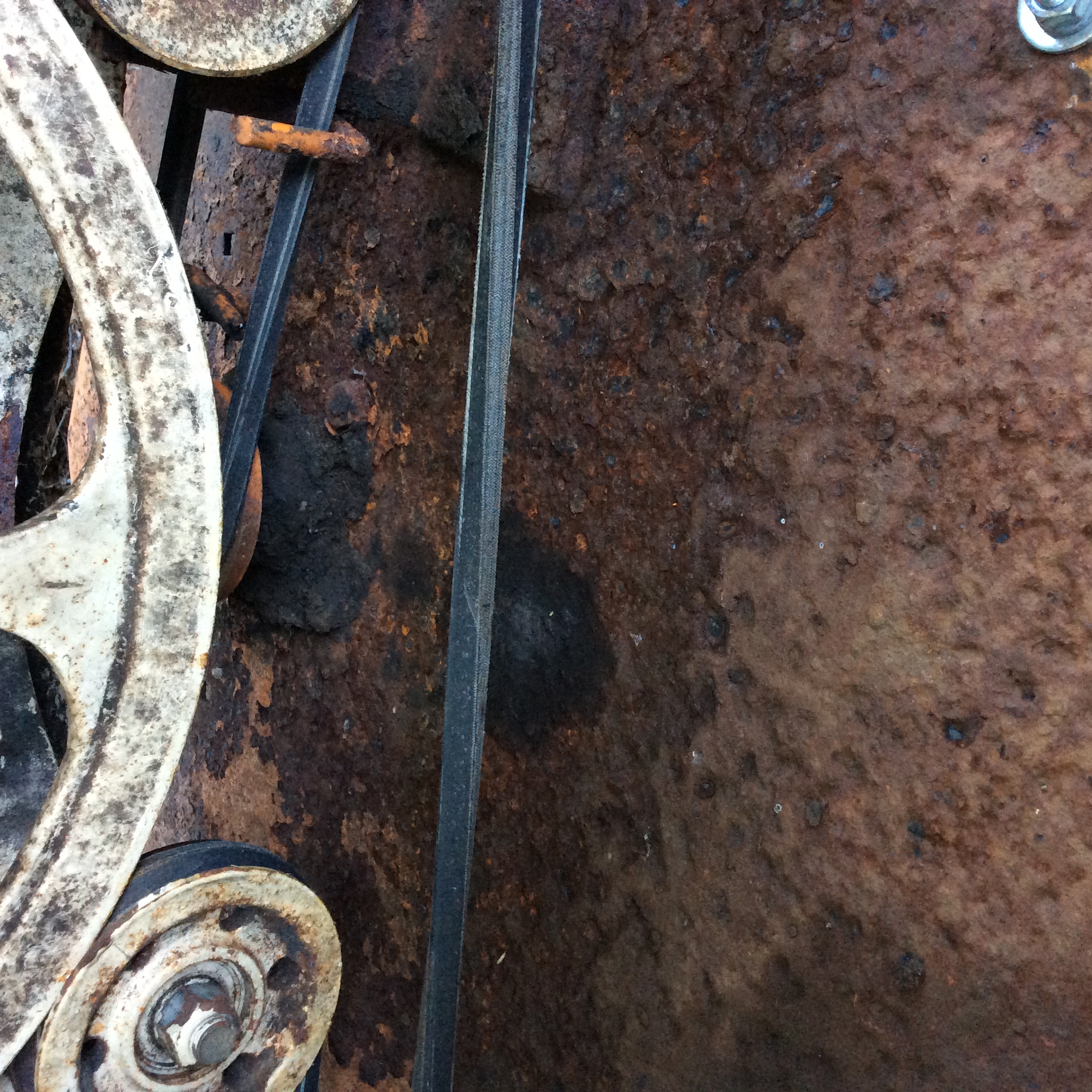

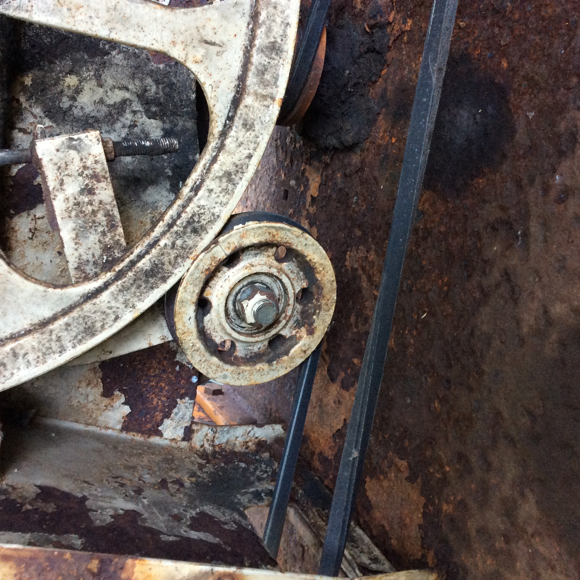

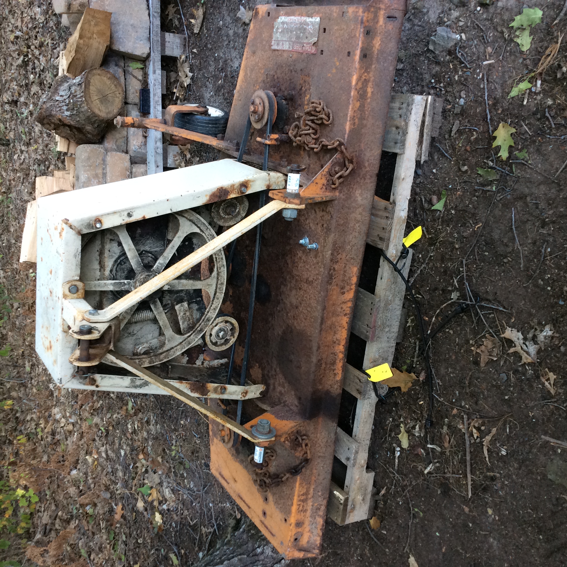

Since the paint is still drying on the frame, I started tearing down the finishing mower. It's a Woods RM59-3. I knew it was locked up, but didn't know why. After getting the covers off and pto shaft out of the way I pulled out another huge rodent nest. Once that was all cleaned up, I was able to see what was going on.
Here is the covers and pto shaft removed.
I found lots of rot on top of the deck from the huge mouse nest in there.
The reason she is locked up is the binding between these two pulleys. Not sure if something is bent or the belt is stretched. Will require further investigation over the Winter.
