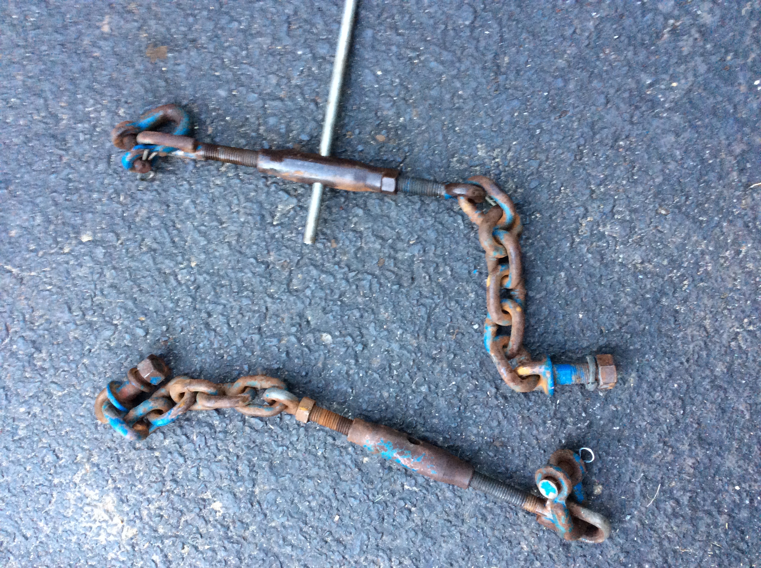

Got the 3 point sway control chains pulled to free them up. They were stuck pretty bad, but got them loose with lots of elbow grease. What do guys use on these?...grease?...ant-seize?

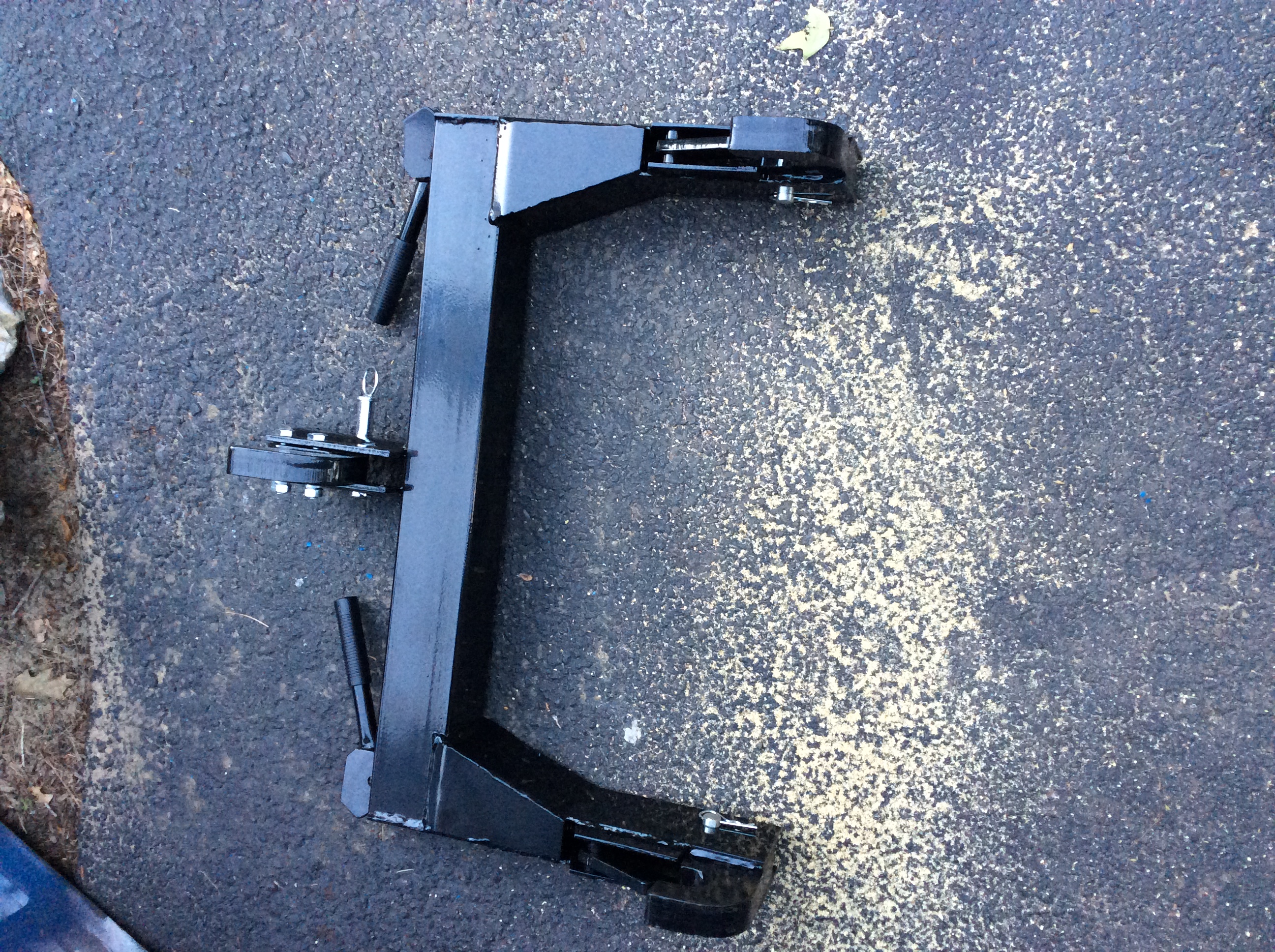

Also started buying some toys. Picked up a quick hitch adapter for some future attachments.
Have a wish list for attachments, but will ask about that when I'm done with the restoration.
   / Ford 1210 tear down and repair #62
I just use Fluid Film on the turnbuckle threads. Pretty low maintenance.

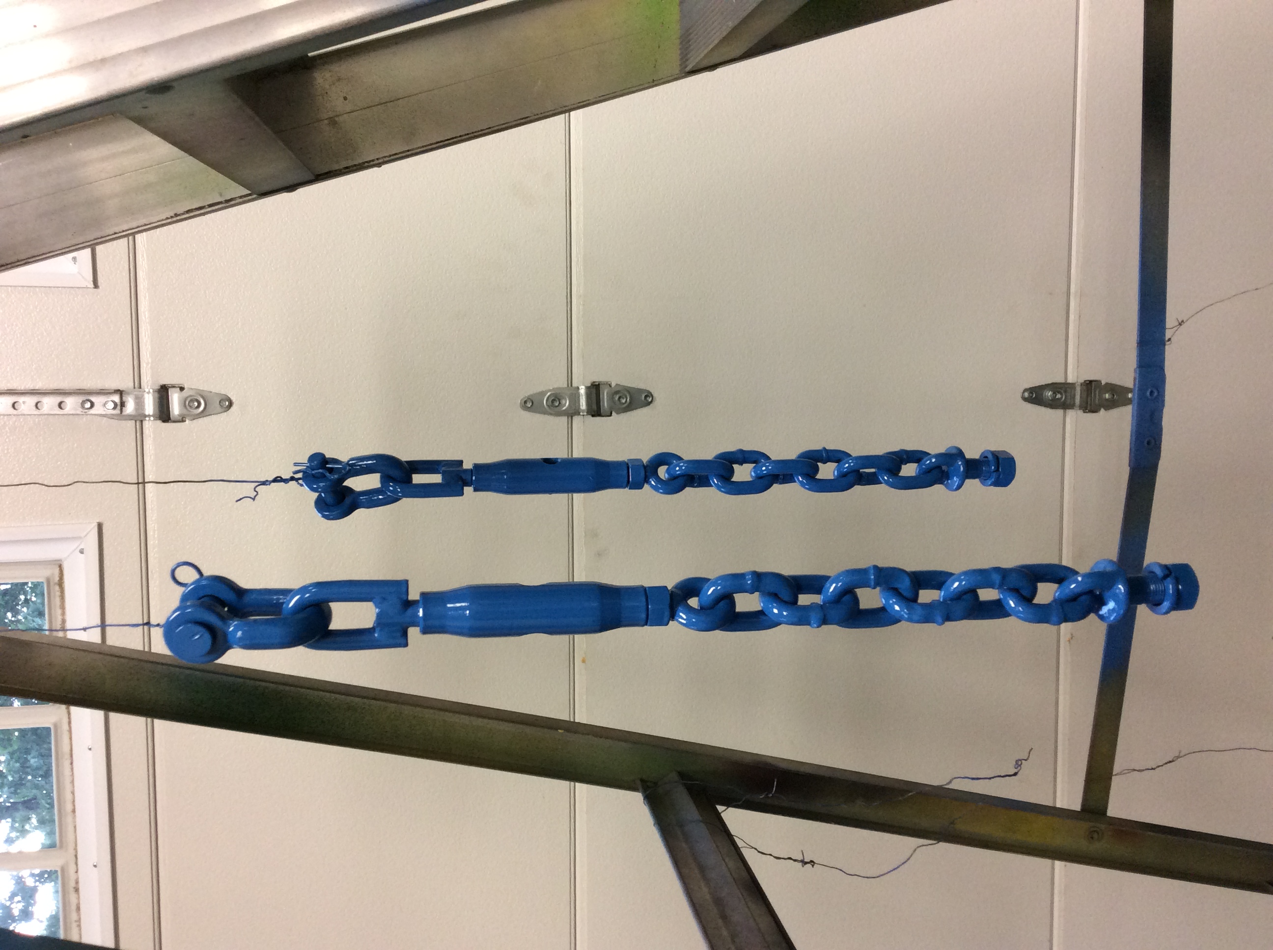

Got the 3 point chains cleaned and painted up today.

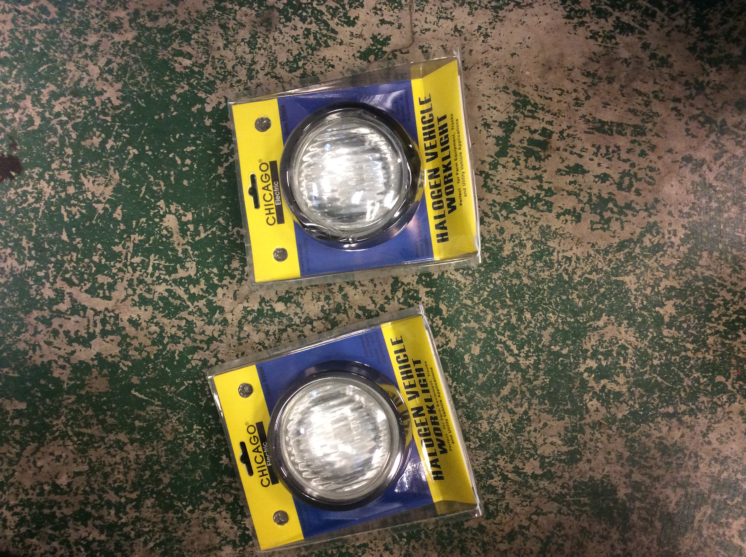

Picked up some utility lights to replace the headlights that were missing on mine.

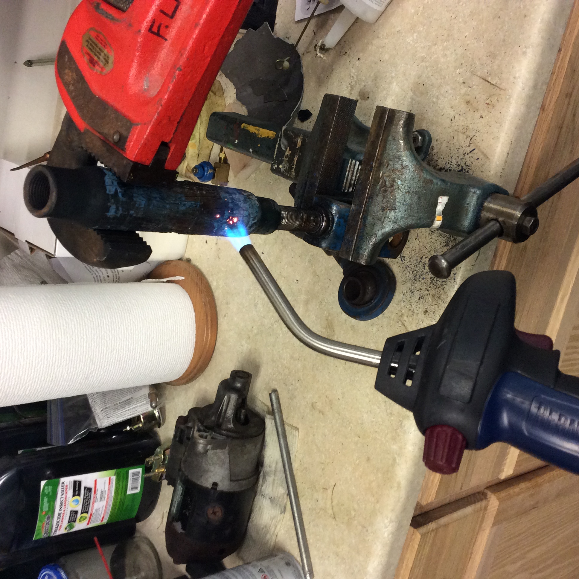

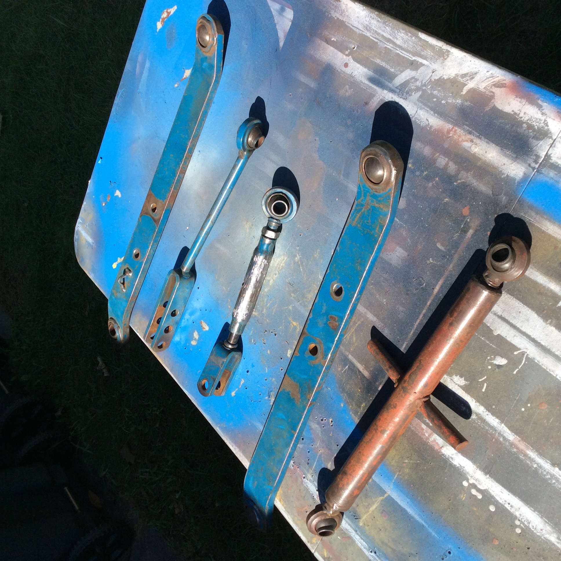

Trying to free up my frozen 3 point hitch adjustment arm. It is rusted solid in there. Have it soaking in pb blaster for the night and will mess with it tomorrow.

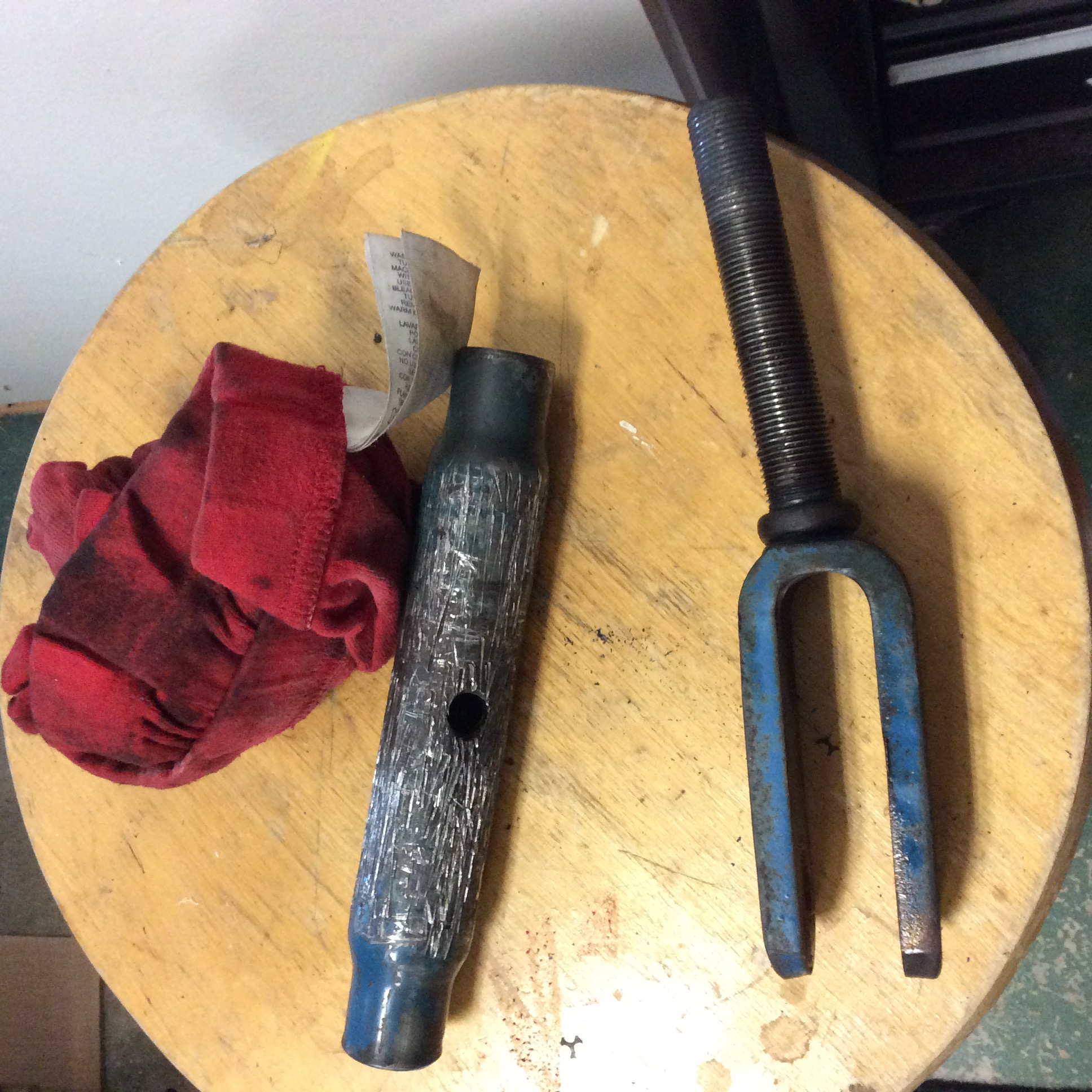

Here is a pic of the frozen 3 point turn buckle.
#65

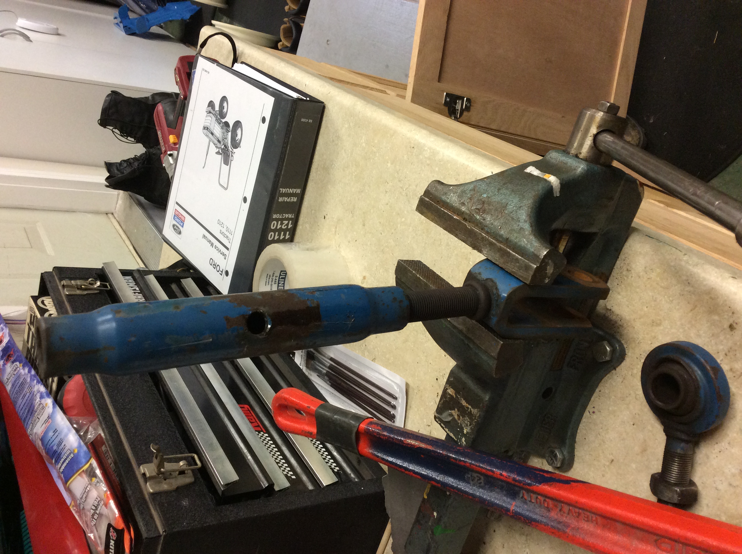

Spent two hours this morning messing with this 3 point hitch turnbuckle. Finally got it off though, lots of heat and penetrating oil.
#66
The top link was also frozen with rust. Some more time with the torch, and pb blaster finally got it free. Here are the 3 point pieces cleaned and ready for paint.

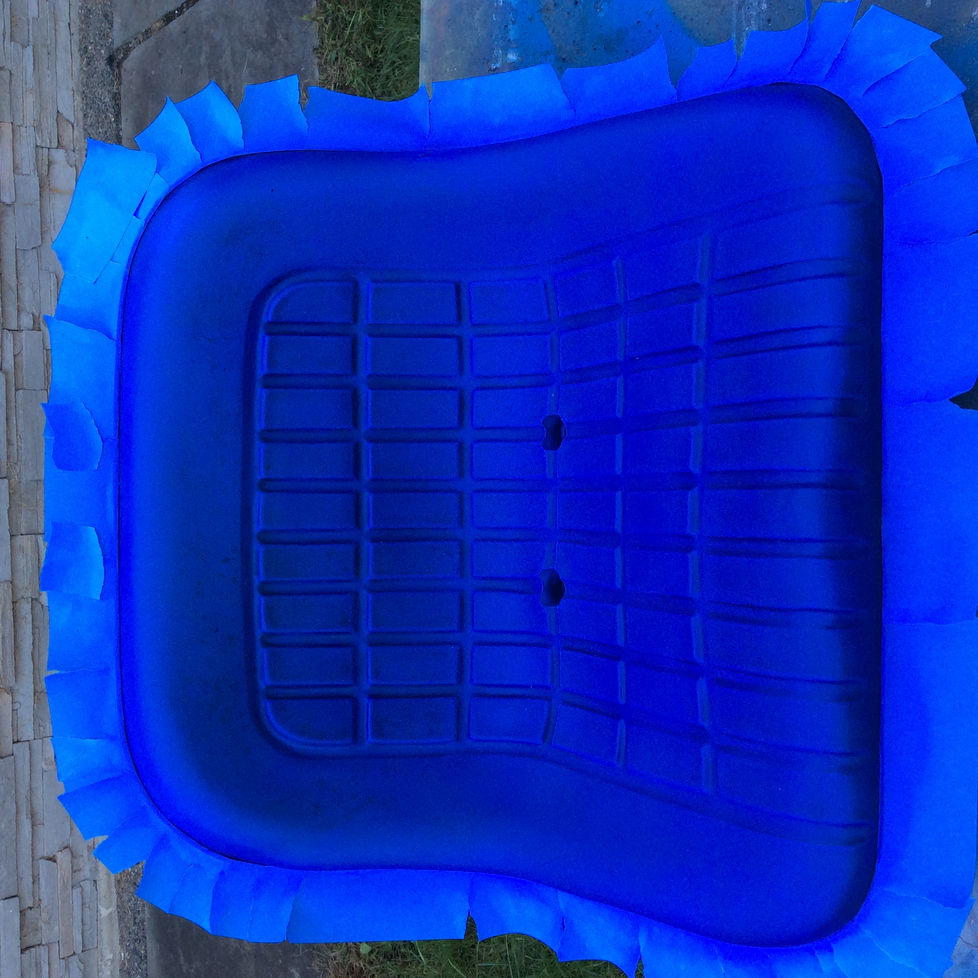

Gave the seat a coat with some blue plasti dip. Saw some people do this on YouTube. Looks better than it did, will see how it holds up.

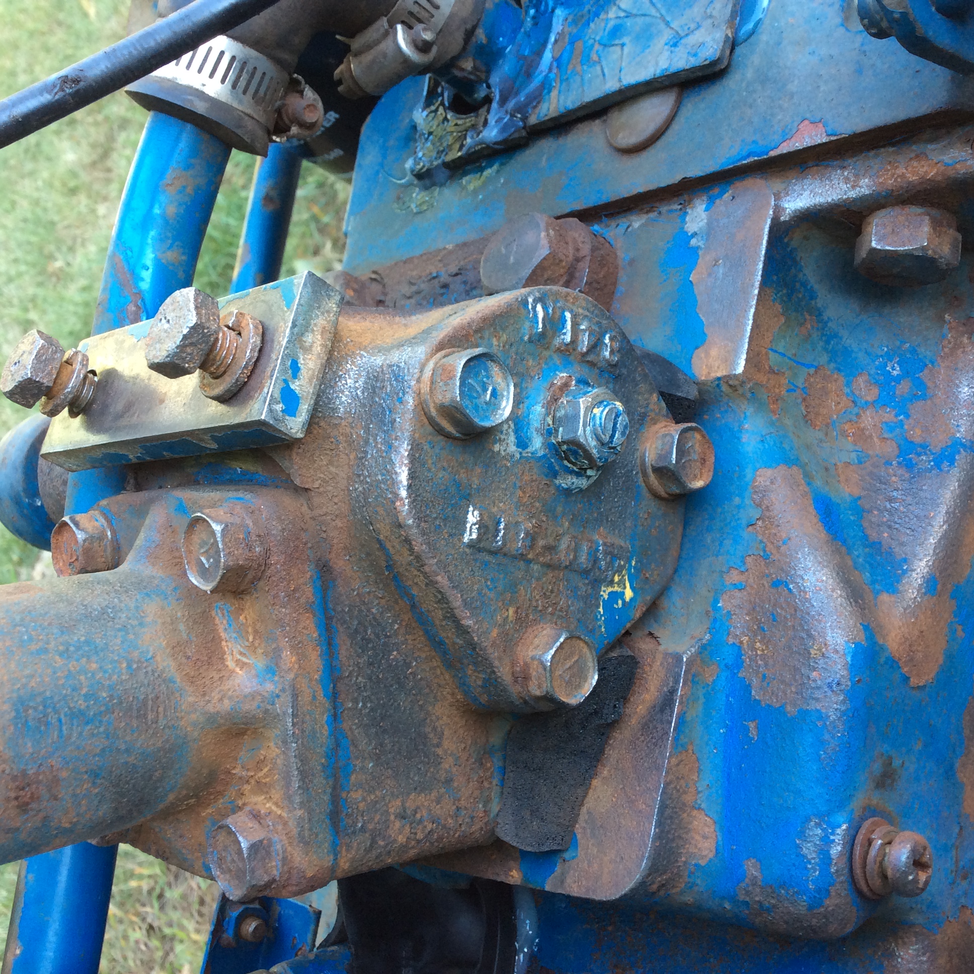

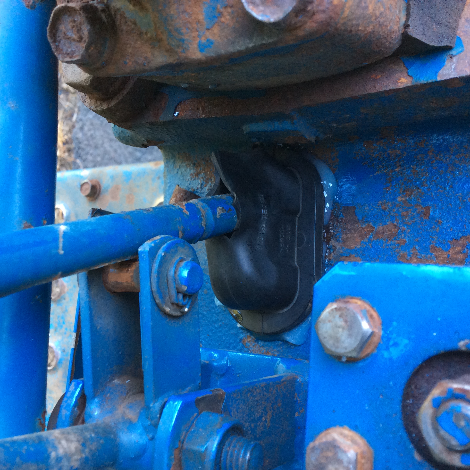

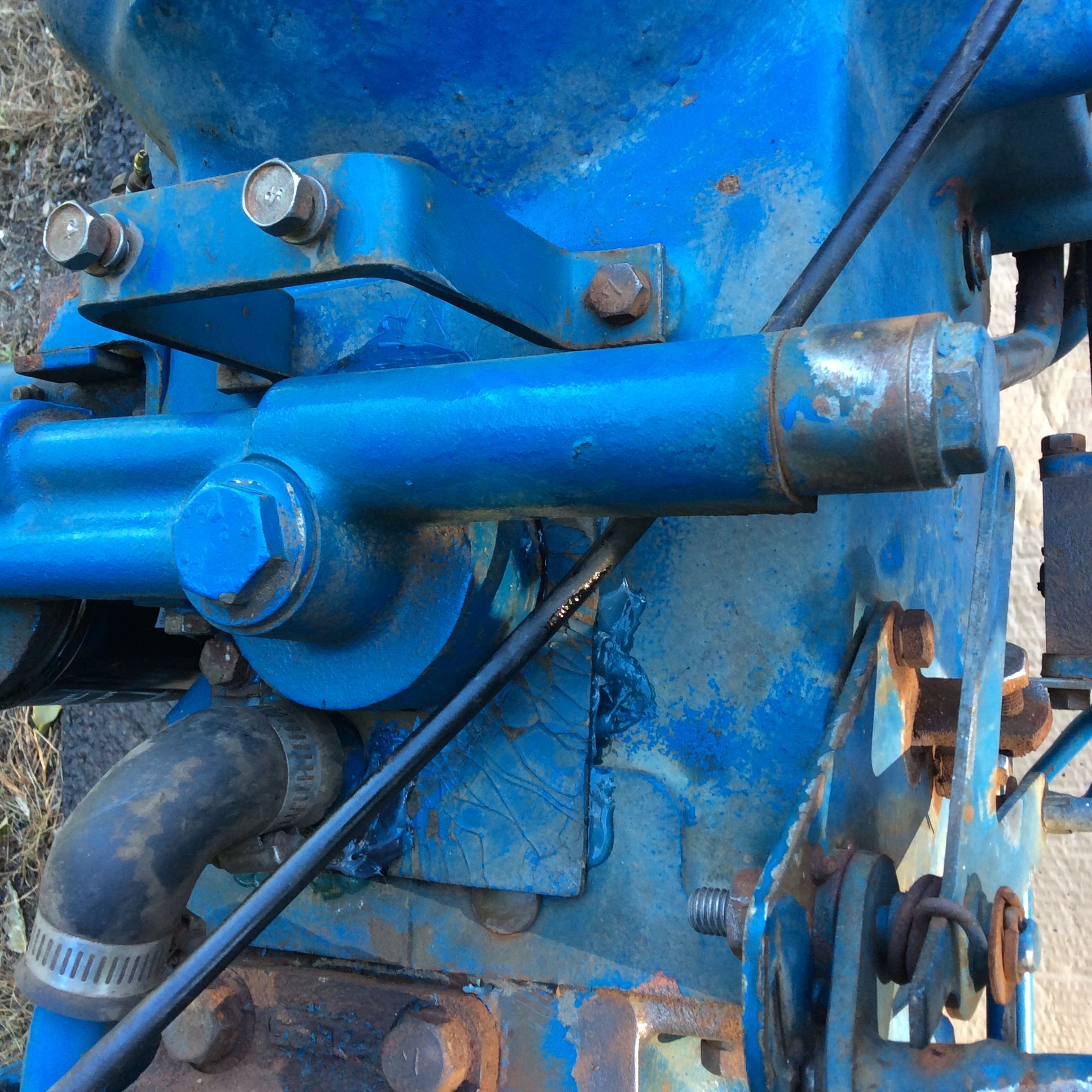

Took care of all my mice abatement today.
Used clear silicone to glue down a rubber boot over the speed control friction lever.
Stuffed a hard rubber into the holes around the steering box.
Used clear silicone to glue down the rubber seal around the hydro lines.

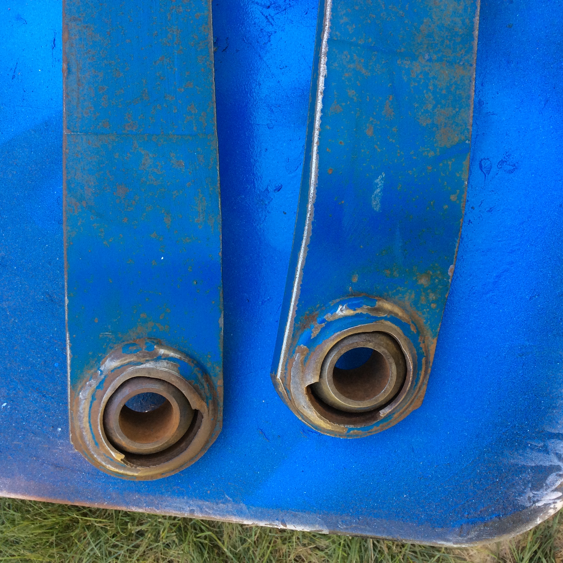

The 3 point arms and top link all painted up.
I noticed some steel missing from around the spherical bearing after cleaning. Is there anything I need to worry about with this? They don't fall out or anything.

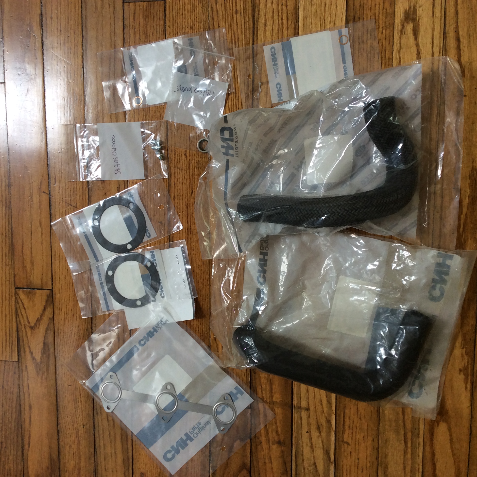

A package from Messicks!...yay!
Off to change the seals in the injector fittings.
