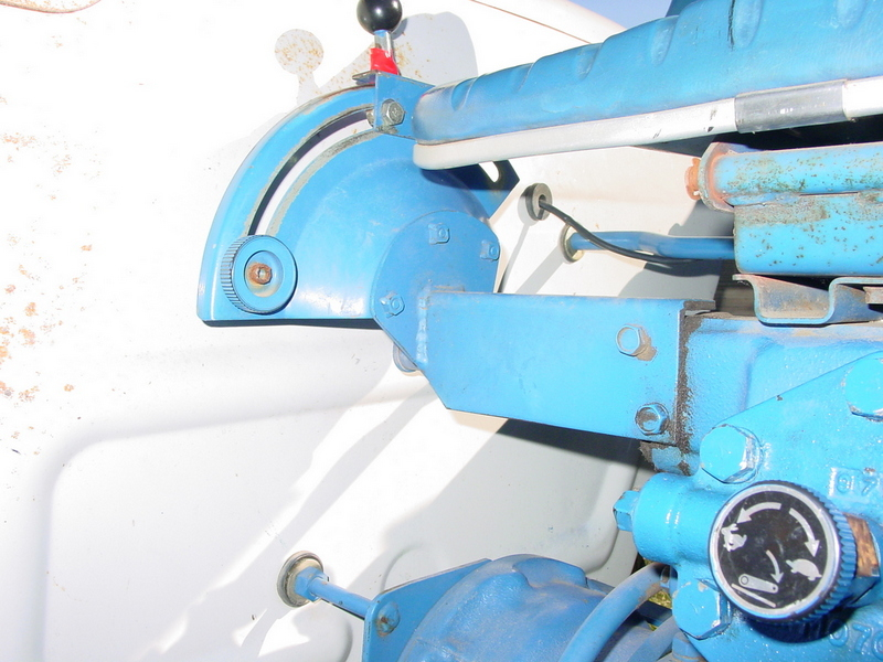

Yup . Agreed. You must have the main relief to work to protect all. Now, you do have max 3-point height lever stop (adjustable). I have adjusted that notch bracket thing just short of highest point. You can move the max rest up and down. Have you messed with that?
You can adjust the high and low resting place of the lift arm

I have set those movable resting places. Everything is fine with the 3-point if the lever is not put into the upper notch.
Good, I lowered the upper notch just a tad , or enough when I put the lever there the relief would not chatter. It clearly identifies limit without me worrying about it.

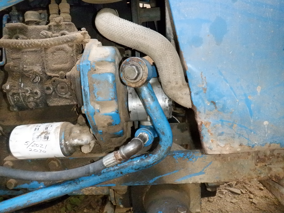

The photo is the hose connection to the hydraulic pump outlet. That hose runs to a T with a gauge and then into the loader valve inlet.

Ok. Looks good. One thing is if the oil leaks by at the relif, and if the rate of leakage is less that the pump GPM, then some flow would be available for 3-point. At what pressure? it would be just a guess unless you measure it. It is a great idea to be situationally aware of what's going on with the pressure by being able to monitor it live. You certainly are in a better place than couple of weeks ago.
