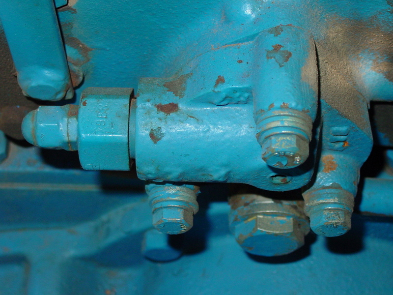

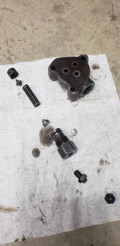

I have decided to trace the system from the pump forward. I think that the pump was putting out volume and pressure and for now I am assuming that is still the case. So I was looking at the cover relief valve. All the parts are there and seem to be in good condition. The only irregularity I see is the hole that the oil would have to pass through if the valve is relieving-dumping to keep the pressure from exceeding the 2100 psi. The oil should push against the poppet and go out through the holes in the side of the seat. What keeps the oil from pushing the seat out of the way instead?
It would be good to be able to run the loader and power steering and not the 3-point. I don't think there is a simple way to do that. But it would eliminate all the stuff under the seat. Maybe I could use that block to try something.
I wonder what that set screw on the side of the relief valve is for. It's called the "Taper Spring Plug."

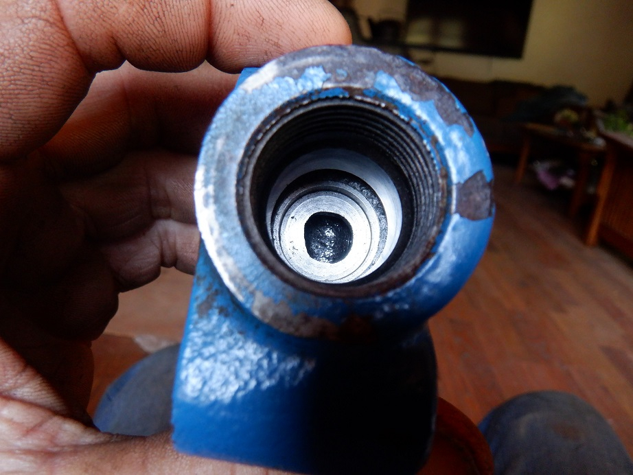

Here's a photo of the ragged hole.
Now this is not my picture. One of the guys posted as he was having issue and I was trying to help. I have not had a need to completely disassemble mine to get a closer observation. How it should work is spring is held against the poppet valve (cone shape) and then flat thick washer with cyllindrical piece at one side. The OD of that is the a bit smaller than ID of the spring. The OD of the valve (conical) is bigger that ID of the seat (with 4 holes). The seat is actually is in contact with the inner body of the relief device ( where you show a non-concentric hole on your picture), The valve seat has nowhere to go so oil can not move that as you were questioning. The poppet rides in and out of the seat (as they call it) but where the conical valve (the cone part of it) is against the gouged out hole. That is really the seat in my opinion. I think it has to be perfectly round as yours is not.
I think that is where it is leaking by perhaps without even lifting the poppet. so in that fix, you have flow but all is goes passed spring without lifting it. That is exactly why that you reported with the lift cylinder head removed you could see and hear splash of oil in the diffy housing. That's my story and I am sticking to it :D . I think on over pressure this thing chatterd for a long time and wallowed up the roound hole.
are you talking about a set screw above the banjo and top bolt of relief device? if so , I don't know any purpose for it , may be it was used to matching the port in to the valve body. I could not find a designation for "taper spring plug" on my manual. I don't reckon it does anything.

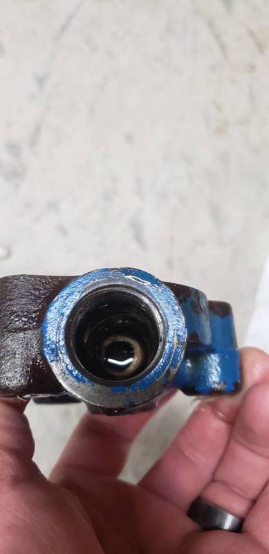

Yup , see it . I think it is jacked up. The the taped part of the poppet will have a round circumference at any depth since id it symmetric and conical. Tat has to mate with a perfectly round hole to make a tight seal and i don't believe that's happening. Now how do you correct it. Either you replace that part ,basically body of the relief (hard to source) or a long shot would be to machine that hole round and perfectly concentric in regards to taper of the poppet. if that can successfully done then spring tension can be increased for material lost (removed). that is a difficult task. I wished the mating seat was replaceable. On a lot of valves for HVAC application the seat can be renewed but not here.

Maybe the wallowed-out hole would allow oil to go around the seat or push it and the seat back into the spring with excessive pressure. I don't think the wallowed-out hole ever contacts the poppet. That seat has a tapered hole the fits the poppet--both of which are still in good condition.
That is what I said n my previous post. I do not remember to see if the seat has a conical shape machining to match the properly fit he conical poppet? can you verify that. Whatever damage the hole must be from repeated strike. Any time you raise the 3 point beyond the highest point you would have the poppet striking the seat or top of it the oil inlet hole. I wondered where the chars of metal ended up after coming off the metal.

I'm sorry, I must have misunderstood. The seat does have a conical hole for the poppet to fit into.

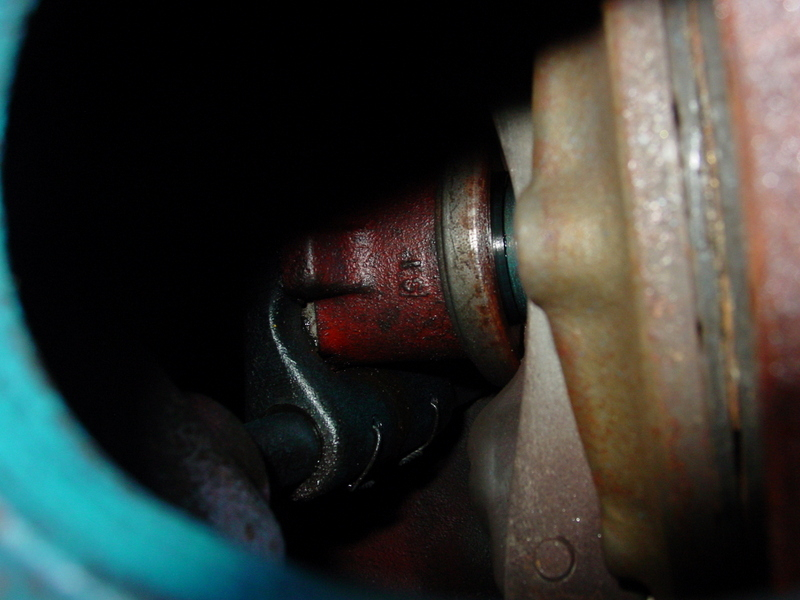

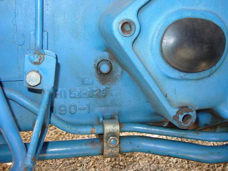

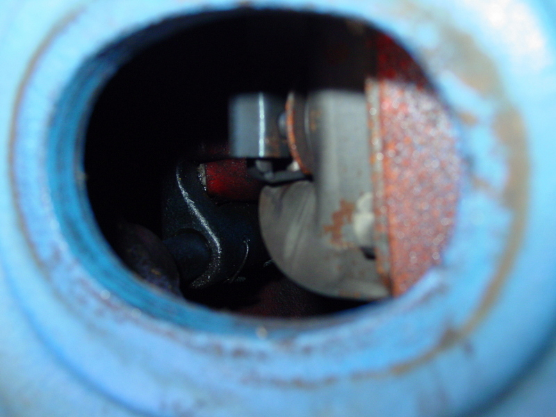

I think my loader connection must block that plug in the photos above. Are you looking at the clutch through that hole? Is there a release bearing grease zerk? I was thinking backwards--if the pump seal was badly leaking then the crankcase would fill up.
Now that I have the relief valve and the block off, I can understand it better. There are 3 holes in the relief valve and the cover, but only two come through from the block. So oil comes into the relief valve through the cover and the block (where the power steering and loader oil gets routed to the other block). But there is no outlet back through the block into the cover. The only way for oil to leave the relief valve is through the poppet and seat. There must a T in the cover so that oil can get to the control valve. But my picture shows the oil flowing through the relief valve and into the control valve.

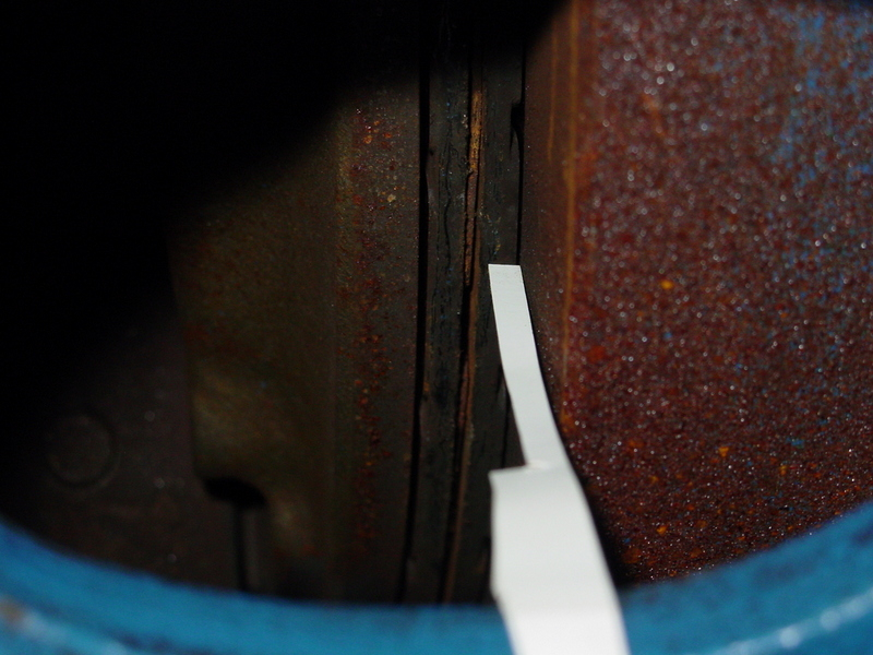

Yes I know the loader mount covers the plug. That plug is outstanding design. I wished more manufacturer duplicated that or at least put a peep hole to send a camera in. in a matter of two minutes, I can measure the thickness of my clutch disk, verify operation of release bearing, see if the release bearing touches the fingers (three in all) of the clutch spring plate and any seal leaking on the transmission or engine. No, you will never see grease zerk on the release bearing as there is no access to grease it up without a tractor split. All the release bearing that I have seen are per-greased for it's life.
My clutch is OEM one and after 40 years and 1300 hrs I still have %90 of original thickness left. That is impressive for an old rig.
Yes. My understanding is that the oil comes from block and enters the relief and at that point normally routed too 3-point from one hole and the other hole routes the over-pressure flow back to tank either thru spool valve or just an opening on the diffy cover. I have not opened the system that far.
