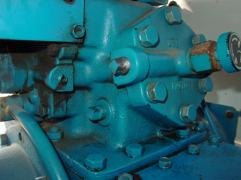

I like it on principal (y). How are you going to mount and plumb it? I wondered if you can remove the guts out of your relief device, plug the relief to the tank on the relief valve and then plumb the relief of this device to return to diffy using the square top plug on the diffy cover as pictured below. That could be done with a 3/8" high pressure hose. in that way, you keep the oem relief to cover all the holes on the side of the cover but can only act as a passage way to supply oil to the lift spool. I think that's doable. What do you think?
That square plug on the left and lower than the gauge just opens up to diffy so that could be perfectly used to return to tank.

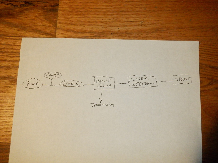

After several failures plumbing the new relief valve in, I tried it with only the loader and 3-point and got good results with both. The attached diagram gets everything to work. The 3-point and power steering work fine, but the loader is slow and jerky. I think the power steering may be the fault because it runs through 1/4 inch connections and everything else is 3/8.
I have tried running the power steering off of a T, but the the return line went to the transmission and nothing worked unless the steering wheel was turned slightly.

Ok. I see. overall you have to have the relief after the pump. Saying that if the loader valve has a relief that is set about or lower than the main relief i Think it is okay specially when that relief over pressure is routed back to the tank. Power steering require less flow so 1/4" probably is okay and then 3/8" for the rest. what happens when you steered and stationary and then use the loader , is it jerky then also? any possibility of having trapped air in the loader cylinders? on my kubota I have actually two pumps with a common input shaft. the smaller pump is for pto and power steering so it is dedicated from loader and 3 point. I know if on one circuit they will have a priority valve to separate the circuits a bit. your situation is like having shower and a flush valve for the toilet on same circuit where one can affect both if used simultaneously.
I think I would just be okay with it as long as it works.

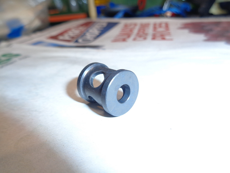

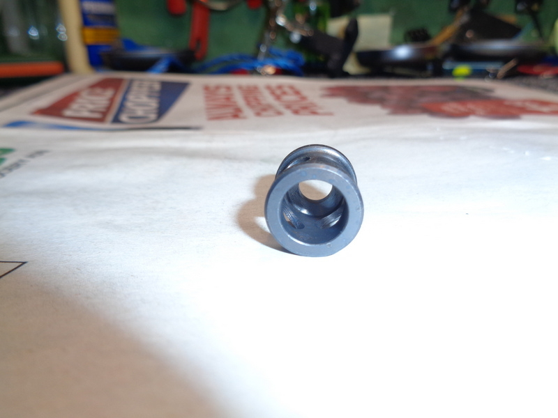

On a separate item, we were trying to figure out the wallowed hole in the relief device. I kept all the old hyd part from when I overhauled my pump in a coffee can. I went and looked at what i had. A that time my NH dealer was close and the counter part lady was very nice and they had everything in stock. I ended up buying a seat for the relief device in case i needed it. it was very cheap, the dang thing now is $146, can you believe that? Anywho, I ended up not using it, so I took a close look at it. As the pic might show below there is a conical seat on the inside that faces the wallowed hole. it is perfectly round and conical against the poppet and unless the tip of the poppet hits the body of the valve, don't know what else could have messed the hole? the poppet is hardened where the body of relief device is not. At any rate it should not matter as the seat and poppet are doing over pressure control. I just let the relief be. As an assembly that relief is $460, yikes.

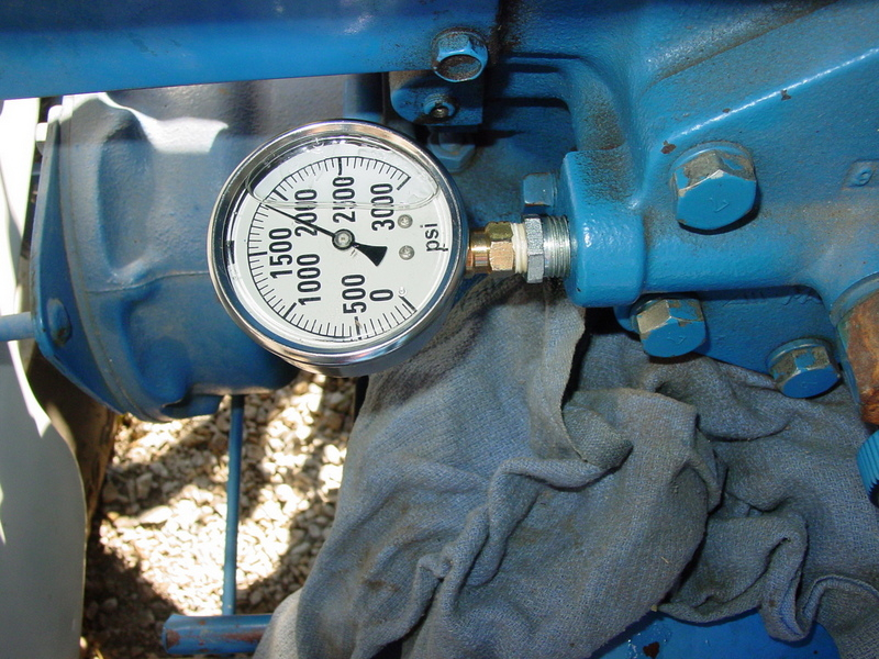

One question, what fluctuation do you at the gauge when you raise the 3 points all the way up and down, loader up and down and curl all the way while steering? if under all those condition the pressure does not exceed 2000 psi I think you are good. Damaging the pump is not the last thing you need to do.

Earlier, I took a close look at that relief valve seat and it looked in good condition--definitely cone-shaped. I thought that the ragged hole and surrounding area may be allowing oil to get around the seat. I was still able to hear that valve making some noise while trying to figure out the best way to configure the new plumbing. I adjusted it all the way down, and that did not stop the noise until I added an O-ring under the seat.
The gauge never exceeds 1600 psi that way it is set. With normal use, it is usually under 500 psi.

Good , I think you are gaining on it. As long as it works and now you are well aware of the limitation. If 1600 psi picks up your heaviest 3 point load then there is no reason to exceed it. Remember lift piston has a relief on the piston head which is a good thing when you hit a bump or depression as you drive with a heavy load on the back. it just momentarily releases some pressure spike and then pump will fill it right back. persistence almost always pays, good job.
P.S. good idea to put an oring to seal the back of the relief against the seat to limit leak by, something to remember.
