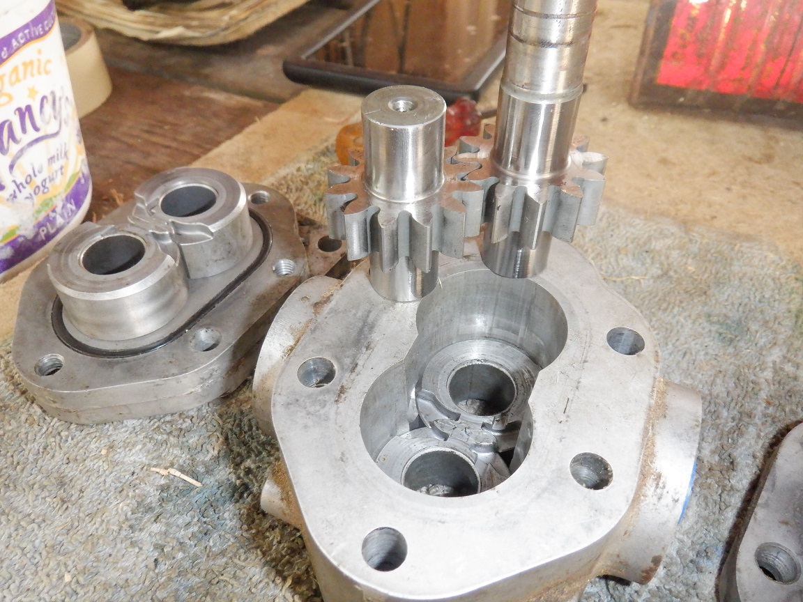

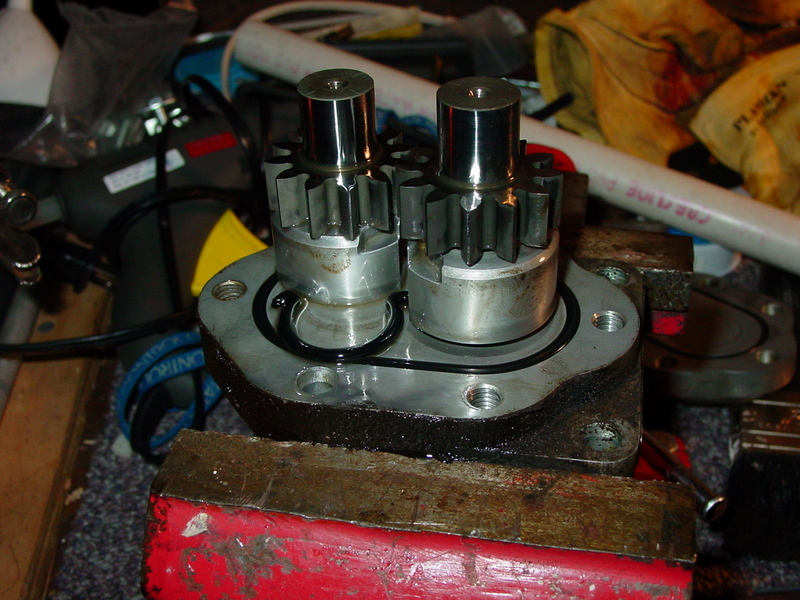

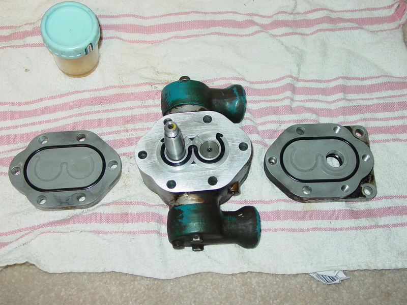

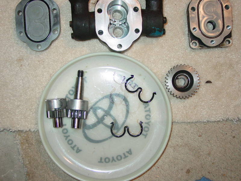

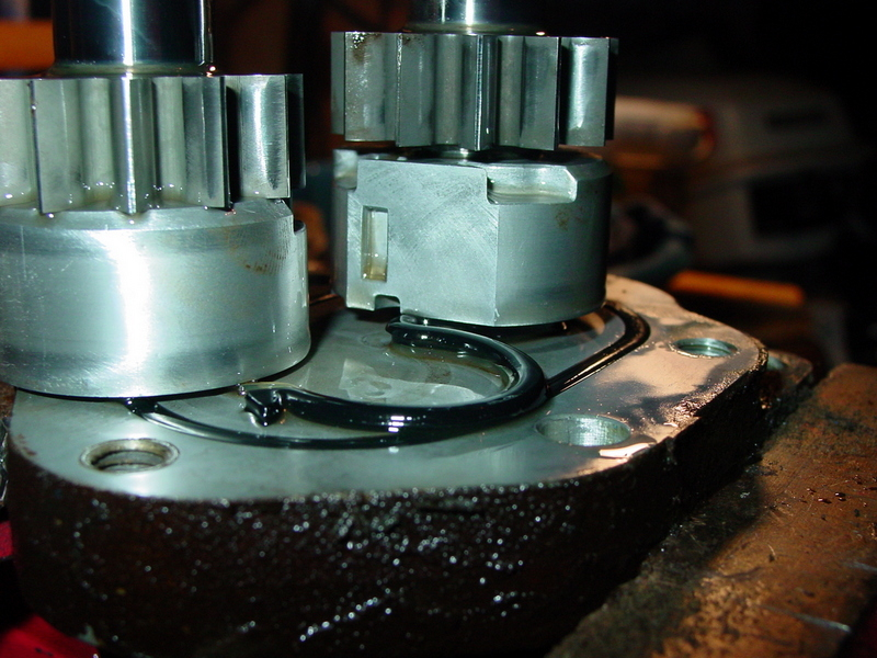

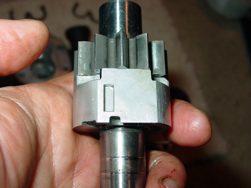

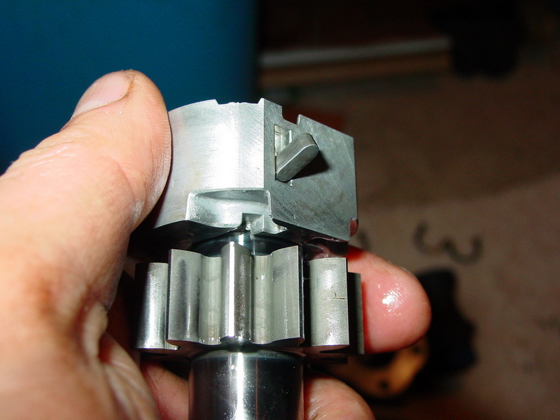

Below is the what a good pump should be like. I ended up overhauling it because I was able to source the kit. My shaft seal was bad that was not art of overhaul kit. At this point it appears the simplest , least costly attempt is to change the oil with something batter perhaps. That would be around $60 perhaps and even it that does not solve it still it is money not wasted. The only thing with the pump inspection is you can do it non-destructively. What you see on the pic where old seals and they really did not look bad on mine and I bet it would still worked. if you can find the old pump then post pocs here to take a look at. May be overhauling it without messing with your existig pump would be a good option.

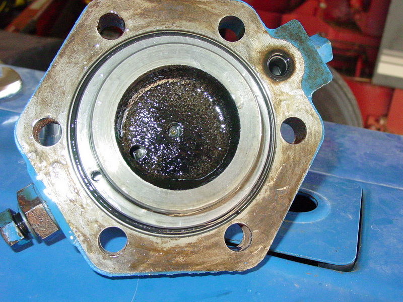

Ijust thought of something else. look at Post #39 and the second picture. That is the spool on the inside of diffy. The hole on the block is where hyd fluid is routed to the lift cylinder. if you remove the head and turn the tractor on, then there should be some fluid coming out of that hole but you will have an steady flow of fluid dumping off inside the diffy. Reason behind that is the spool is in it's neutral position for the given height and the rest of the flow , like in my case without loader constantly is dumped back to the tank. You have an open center hyd system and the fluid is constantly pumped without stop as long as the tractor is on. it is either used in my case only when I use the lift and 99.9% of time dumped back in to the tank to complete the circuit. That could be one other alternate method to test the pump for flow. Make sure the ram rod that pushes the piston up does not hit the inner housing, in other words don't manipulate the 3 point by raising and lowering, the purpose here is just to check the flow.

I'm thinking that hole in the cover should have an o-ring, but there is none. it does have an o-ring look at the pic below of cylinder head.

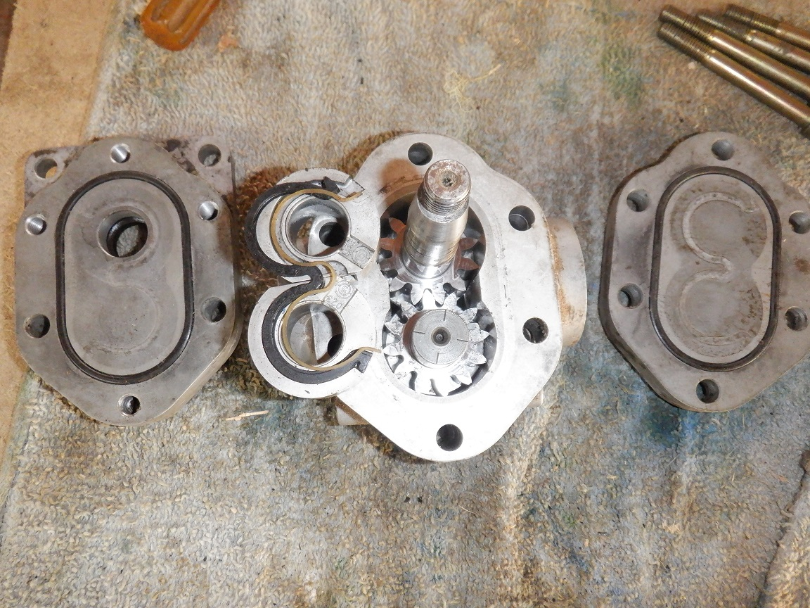

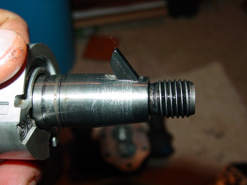

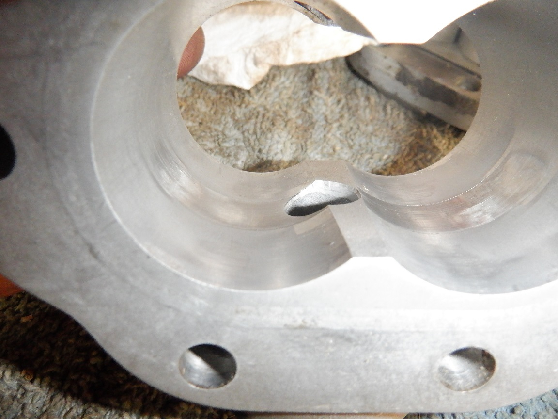

I did get into the old pump and posted some photos. Mine does not have that key (like in your photo) that fits in between the bearing pieces--although there is a place for it. Not sure why it would be needed. There's no place for the pieces to go. There is some wear in the body where the gears run on the inlet side. You can just barely feel it with your finger.

I did get into the old pump and posted some photos. Mine does not have that key (like in your photo) that fits in between the bearing pieces--although there is a place for it. Not sure why it would be needed. There's no place for the pieces to go. There is some wear in the body where the gears run on the inlet side. You can just barely feel it with your finger. it does not look that bad. Make sure put witness mark on bushing and gears and how they all went together. Those parts are mated together and have a better tolerance. use highest grede emery cloth and some hyd oil and very gently smooth out the pump inner body where the gears move against. Take off any burrs that you see. be extremely gentle and take as little as you can. Hopefully you have enough tolerance and oil film to give the pump good efficiency. The pump is better looking than i anticipated. I don't know how many iteration of that pump were there but keepers mayor may not be necessary based on design.Main input sahft and gear for sure need to have a keeper as the torque is high.Most other pump othetr than hysraulic have the shaft keeper.
