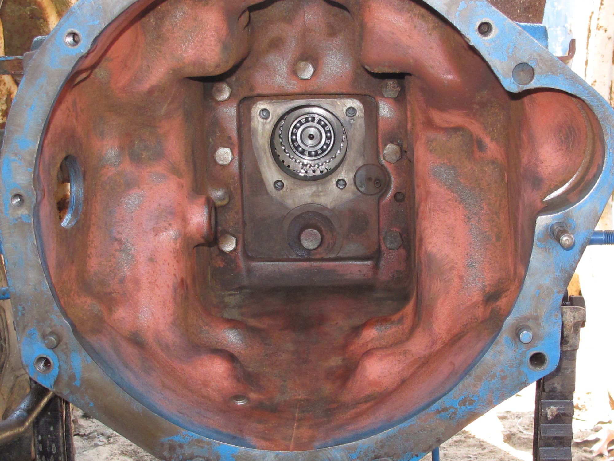

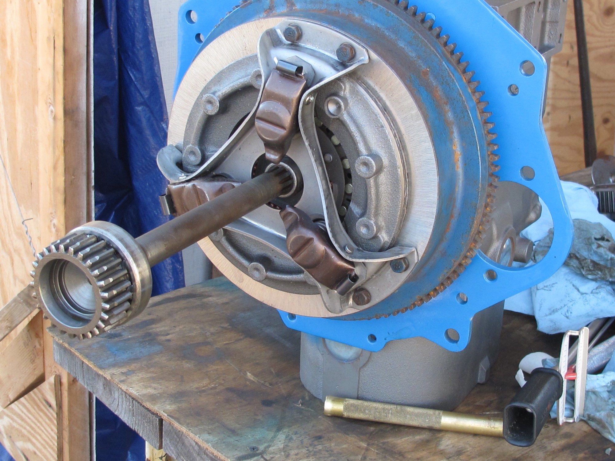

Yea, the clutch does sound suspect. Have not had to change the clutch in my 1700, but maybe one of the other 1700 owners can chime in. Hey JC, have you split your 1700 yet? I searced the forum and found a post and pictures courtesy of jones6780 of his disassembly. He can probably give you some advice. Here is a couple of pictures he posted (thanks jones for the quality pictures) of the clutch assembly and bell housing. Good Luck TB

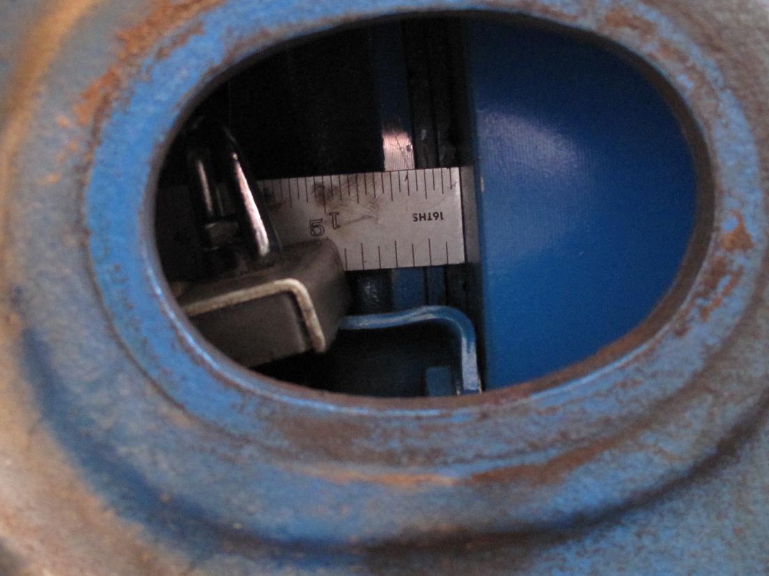

Here is a picture looking in the inspection port with a scale to measure the clutch thickness. It measures 5/16" thick for a new clutch. If you have free travel at the top of the petal travel, the petal is not causing the throwout bearing to engage, then there is no adjustment that will correct the slippage.
Russell

Dittto on what Russell had to say. in addition to it if you take the inspection hole cover off you can see if throw out bearing is touching the 3 fingers of the pressure plate or not. if you are not riding the fingers then for sure yu are slipping. the squeal at times can be a dry bearing making noise due to occasional or constant rotation (ie, riding the fingers of pressure plate).

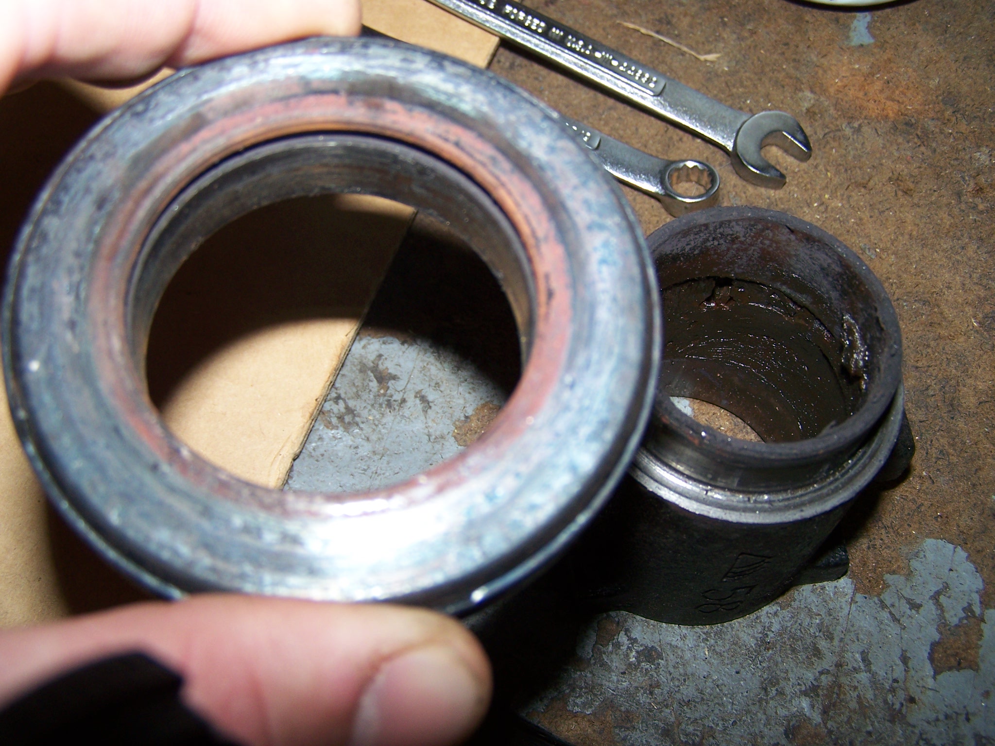

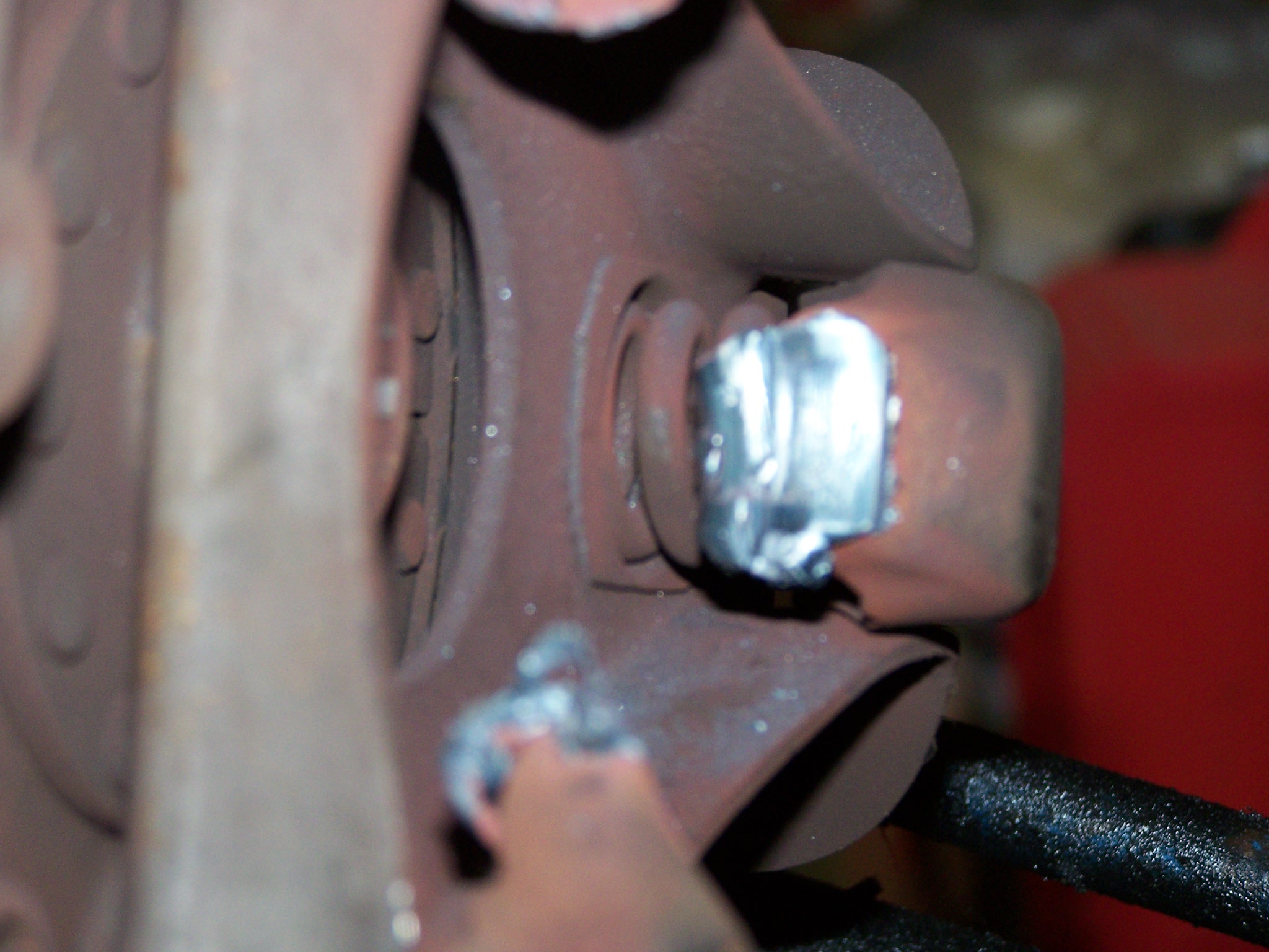

Here are some pictures of my clutch job. Just an FYI- my 1700 is a greasy mess from being used and abused. I have a hydraulic control valve leak and the engine seams to leak oil, but it runs great (other than the clutch :p)! I took a bunch of pictures just to make sure I knew how to put it back together if I got stuck.
The clutch failure is a mystery. It was making a little noise before it failed but nothing major. The pilot bearing may have stuck (it is really rough when you spin it) and caused the throw-out bearing to lock up on the clutch. I'm not sure....guessing. Either way the clutch fingers were ground down to nothing and the throw-out bearing was stuck out. I had no resistance on the clutch and could not put the tractor in gear at all.

Maybe the throw bearing was getting stiff and didnt spin freely enough. Or maybe the clutch was adjusted to tight (not enough freeplay in the pedal). And also maybe the clutch had been ridden too much. Make sure the throw bearing sleeve has free travel on the input shaft housing, and the return spring assists it. Either way, its plum wore out. Good thing you caught it before it got worse and caused more damage. Once you replace the pilot bearing and clutch assembly and throw bearing im sure it will be fine. Just dont adjust it too tight. Nice pics, keep them coming! Good Luck, TB

Ditto on all the stuff Tex had to say. It has to be one of them and I lean toward bad adjustment where the throwout bearing was constantly riding on the fingers. How did the clutch disk itself looked like? Condition above could also adversely effect the surface wear as it slips and grabs rather than grabbing all the time.
