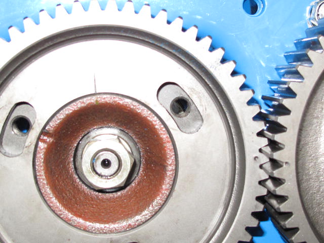

Hi 53, did you ever get the information on the markings for fuel pump timing for your 1700?
   / Ford 1700 injector pump timing #49
Russel does the injector pump have timing marks to set with crank gear on the 1700?, the pump was removed by previous owner and never made any marks to where the gear is suppose to align with.
thanks

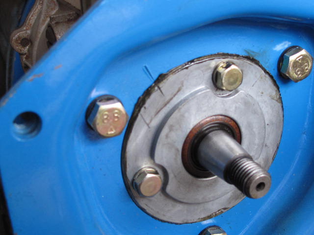

   / Ford 1700 injector pump timing #50
I posted photos before on the injector timing. Other than the actual timing of the gears with witness marks the injector gear has slotted holes for adjustment and the injector mount holes are slotted. There should be witness marks.
