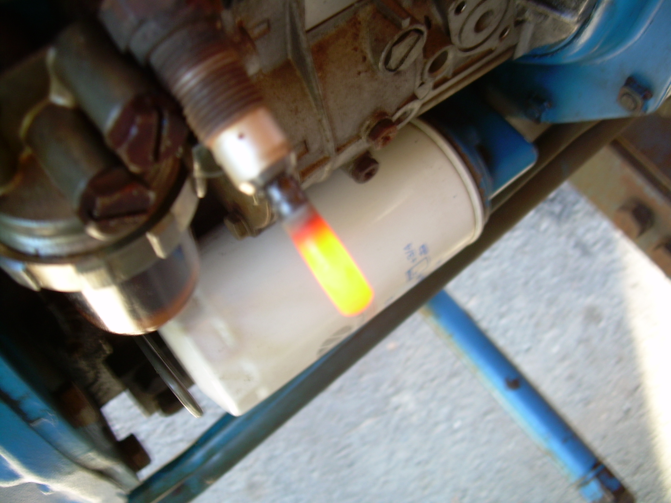

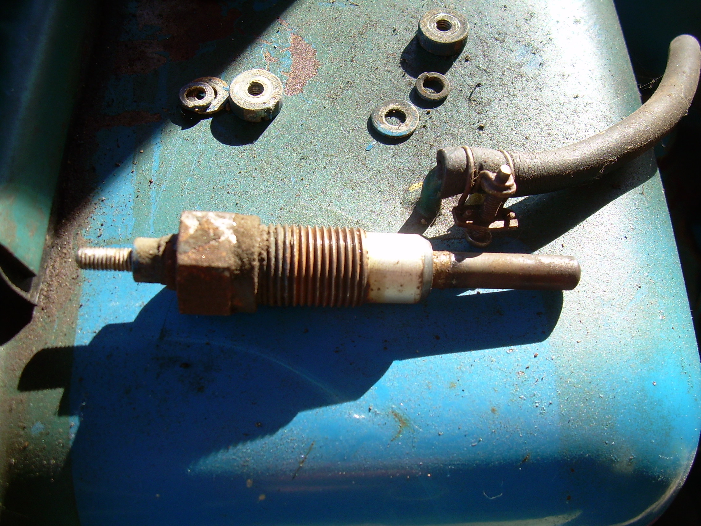

Checked my GP's today and both are good, so I guess my hard starting is due to old age/high hours (2600+) Since I've never seen one I took them right out to test them and man they do get hot, that little coil thing in the dash is very mild compared to the glow plug, I envisioned a little coil similar to the indicator.

I'm sure that you're right. For the sake of satisfying my curiosity I'll check it next time I go to my place. What puzzles me is if you take a look at the pic below, When i turn the key to heat the current has to go thru terminal 19 as It heats the glow plug and the resistive element. Going thru 17 can for sure heat the glow plug but totally bypasses the 19 hence no indication. I'll put a test lamp between terminal 17 and ground and see if it light up when I crank.
