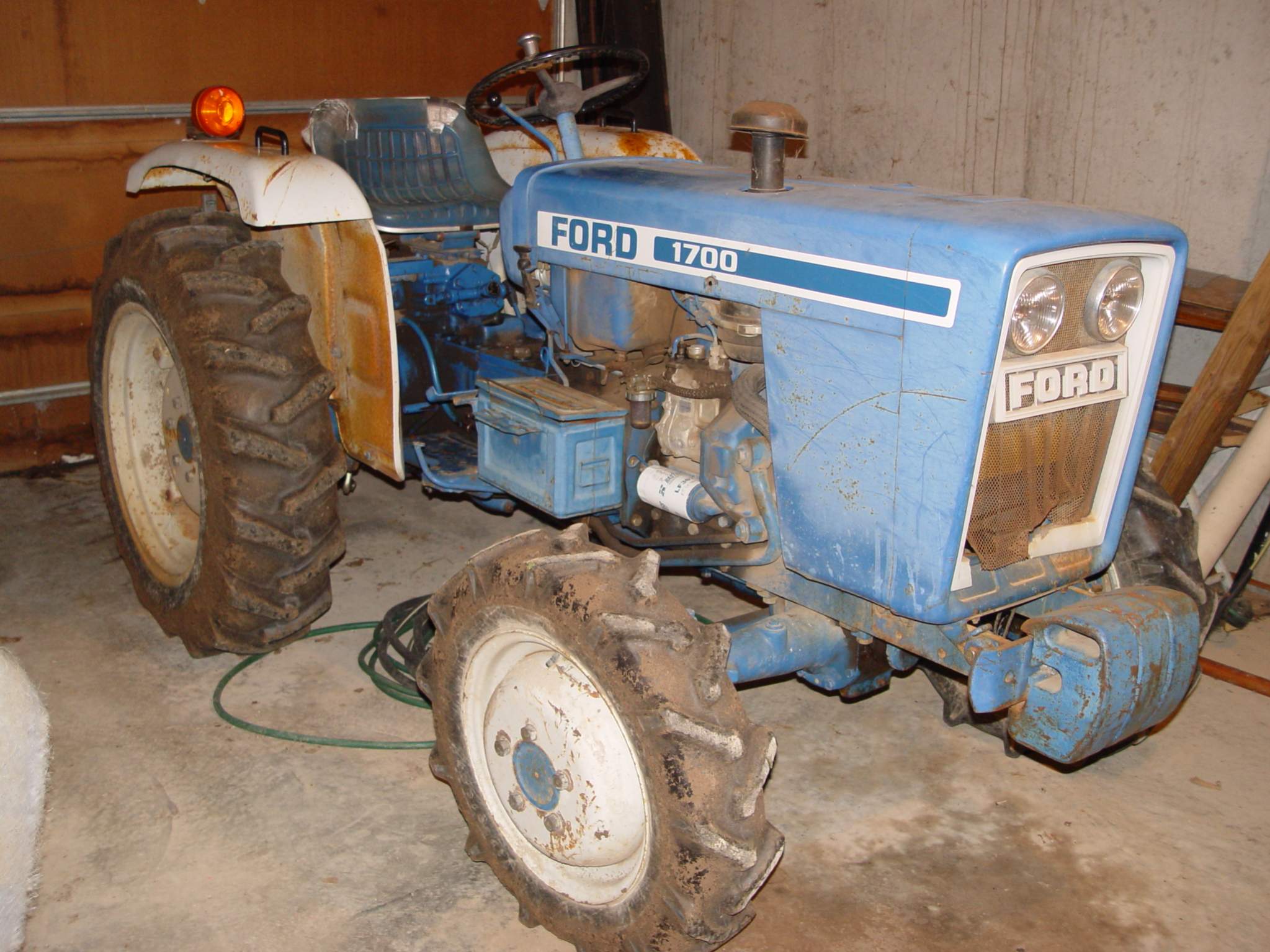

Greetings, JC,
I'm sure that's a typo, I think you ment to say "without" the clutch pressed in, that's what prevents the starter from cranking. Makes sense to me.
Ray,
I'm interested in your block heater, mine has been a little rough starting in this mild weather even with my GPs working, so I know it's gonna be a problem in the winter when I want to use it for some plowing, is yours factory type internal or some after market external device.
PS, I do run out to take pictures sometimes! I took this today getting ready for some winter use like I mentioned.

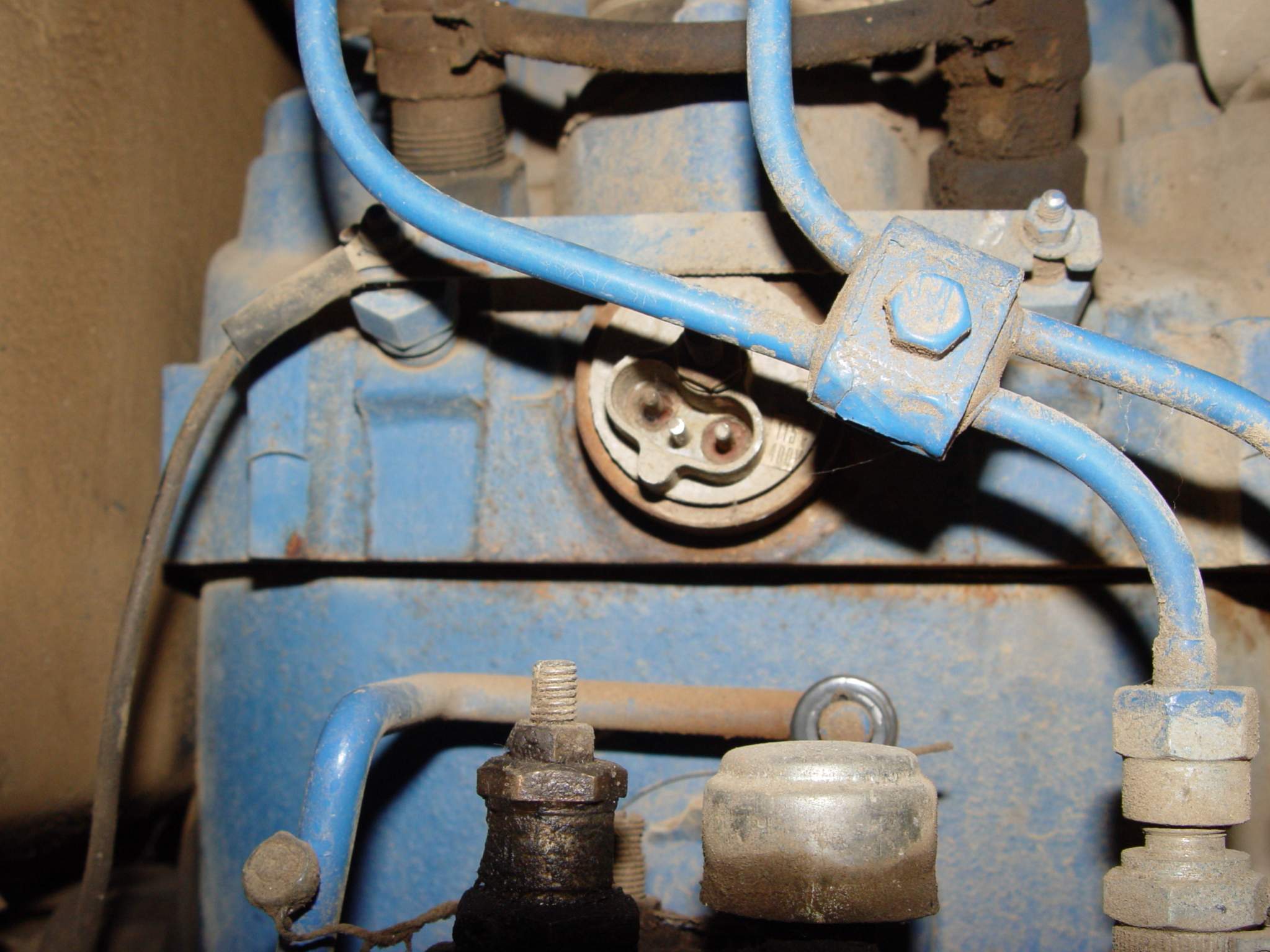

JC, My engine block heater came with the tractor when new so I assume it was factory installed and would be available from the NH Dealer as a parts order. Check to see if yours has the soft plug installed with the plug in reciever, if so all you would need is the cord. See attachments:
I have tested my glow plug problem and found the glow indicator is OK. Took the wires off and tested it for continuity and it was not broken. Reattached the wires and turned the switch and it worked. Problem may have been either a bad ground or could still be an ignition switch problem. I will watch it to see if it is still intermittant on/off. Ray
