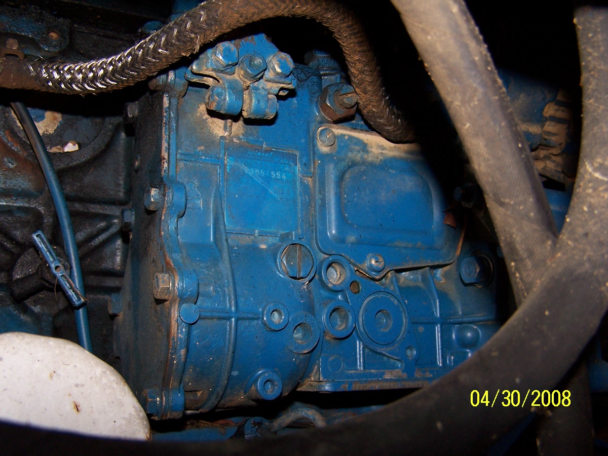

JC,
Thanks for all your help, but am I missing something? I don't have the oil-level screw or drain screw. I see the fill plug on top. I keep reading the instructions and they are very simple, but I don't have the drain and oil-level screw on the side of my pump.

Bob,
Post a close up pic of the pump and we'll go from there. I see that fig 129 from IT FO-44 does not show the entire pump for 1710. The lower part of the pump that should have drain and level screw is not shown. May be there is something to it.

BOb,
See what I found in FO-44. As they say devil is in the details. If you read it closely it does say the darn thing on 1710,1919 and 2110 is lubricated by the crankcase lube. I reckon when you drain the engine oil it somehow drains the injector but oil new oil fill does not fill the pump. it is a bit confusing though. it says how much oil to put in it also (5 oz). I still like to see the pic. No wonder why Randy's manual says just fill it.

JC,
Hope this picture comes through.
As for the oil, where is a good place to purchase this oil? What about the oil at Walmart. I know they sell 5 gallons of hydraulic/tranny oil for tractors. If not recommended, who sells the Mystic oil you mention?
I also found where it is leaking. It is coming out of the housing that holds the hydraulic filter. Looks like it is leaking where it mounts to the transmission case. A simple gasket I'm assuming.

Bob,
Picture came through just fine. Well.. well .. How about them apples?:D On the lower left corner of the pump you see two holes that are lined up vertically. I have one screw in each, top one was the level hole and bottom was the drain hole and oil fill on top as you know. The darn pump looks exactly like mine. My pump is only connected to the engine from the front where it is coupled to the timing gear housing. It is yet a mystery to me how the oil gets drained after you filled the injector pump. The normal engine oil level must be the same as normal oil in the injector for the physics to work (siphon principal), if the oil in the engine and pump are connected by a drain line they should seek same level. If the engine oil pressure lubes the pump then, injector pump can be higher and should be a drain to the crankcase that is continuously draining.. if that is the case, why fill the injector pump separately. This is giving me a bit of headache you know... :( by the way I meant to say it in my earlier post. I bought my oil from TSC (Tractor Supply). if you do not have the store I recalled soundguy mentioned some universal UTF sold in Walmart that meets and exceeds Ford 134.
