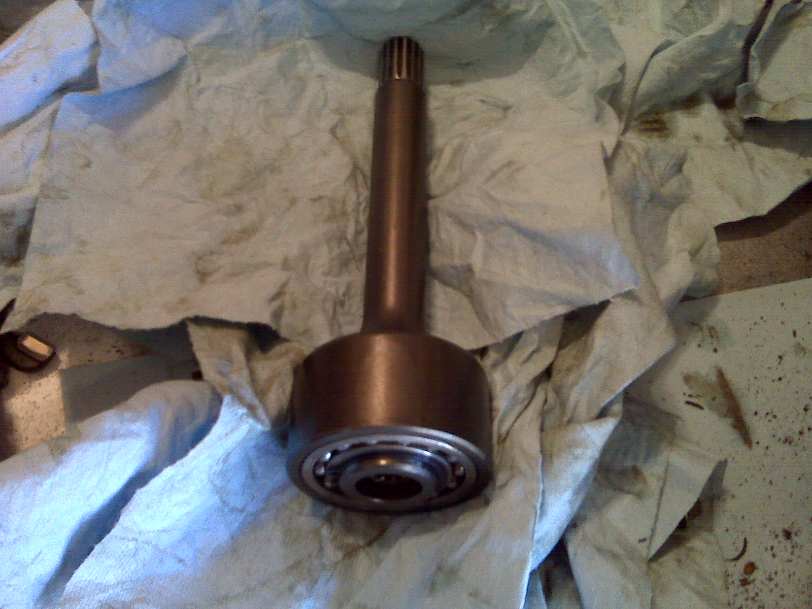

Thanks for the update. I'm pretty interested on how this is done. I have not myself heard anything about the pto internal ORC clutch issue on 1000 series tractor. I have used both brush hog and tiller while I owned the tractor and seems to be working just fine even under very heavy load. Just let me know if the differential need to be separated from transmission, or if it can be done from the end where pto output shaft is. If you can please take a few pics. Below you have a pic of the internal ORC clutch for the 1700. Does your new one resemble that? If you go to NH website they show all the components of the ORC but the pic below is the whole assembly.
JC,

Did you investigate if one could use a sliding coupler directly in lieu of internal ORC. With option like that a guy would be able to buy an external ORC from TSC for around $50 and have exact same functionality, At least you don't have to take the darn differential separated if ORC failed.

I did, but here is a picture (more to come). I would need a very long coupler (~14") or two couplers and a custom shaft. Both of those were more expensive than the ORC, and the parts guy at the New Holland dealer said he has never "replaced the replacement" part so I should feel fairly confident I will not have to tear the whole tractor apart again due to this specific issue. Only time will tell.
Thanks for the suggestion for the external ORC. I am considering an external "slip clutch" just to protect this internal part as it is supposedly the drastically varying torque loads that a tiller puts on the older, weaker, clutch. I don't want to test the new one quite as hard....
Audo
