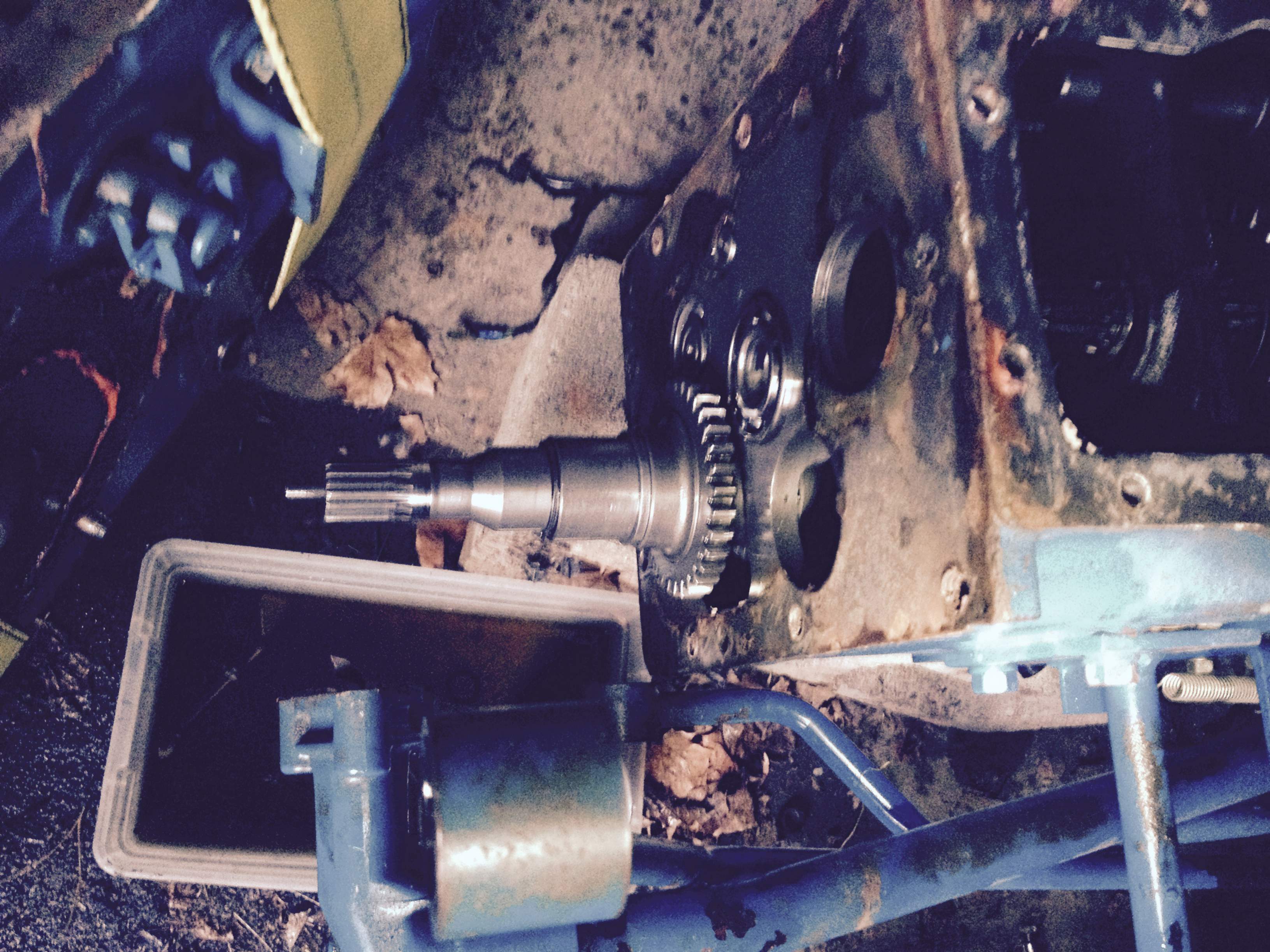

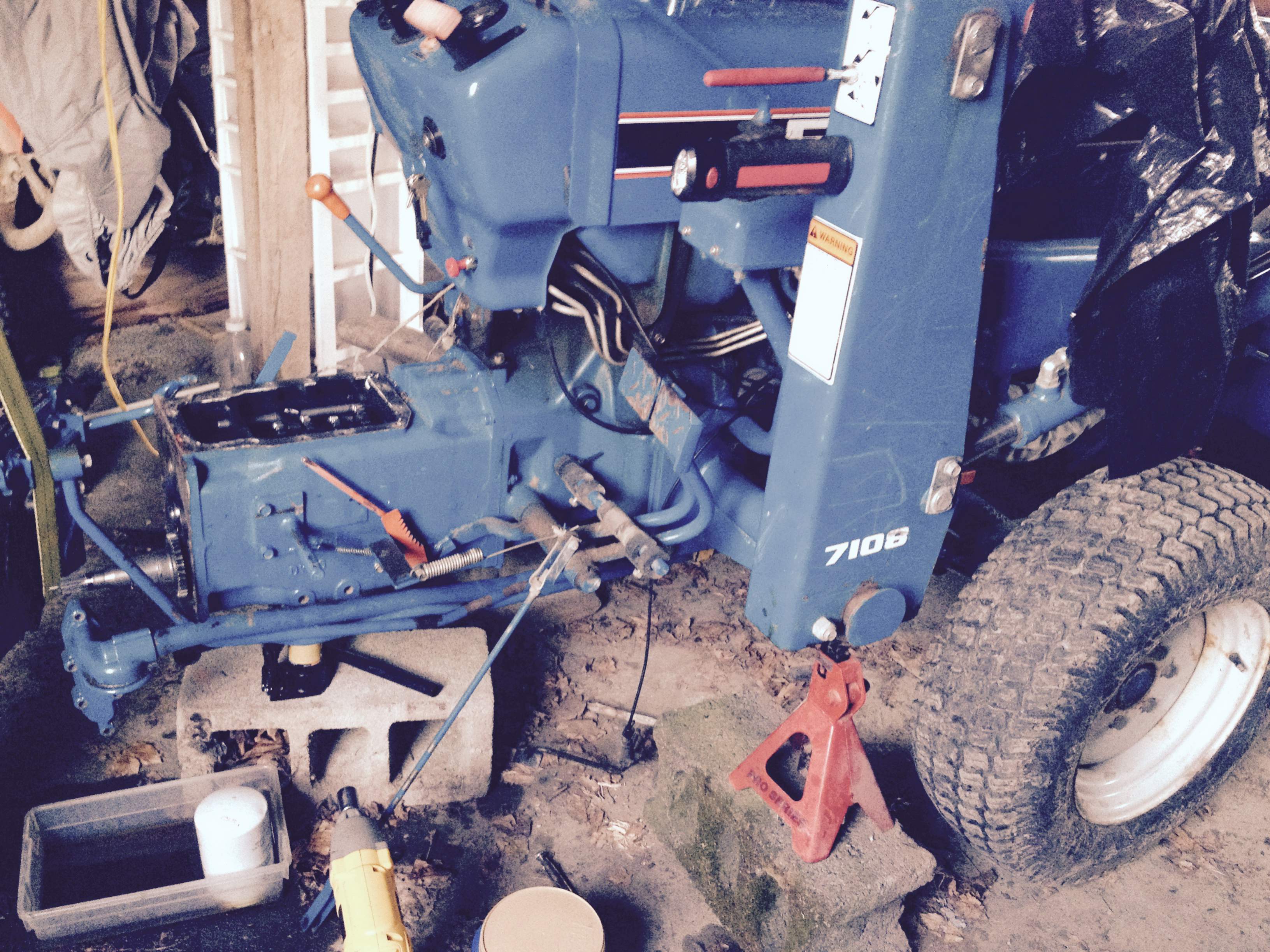

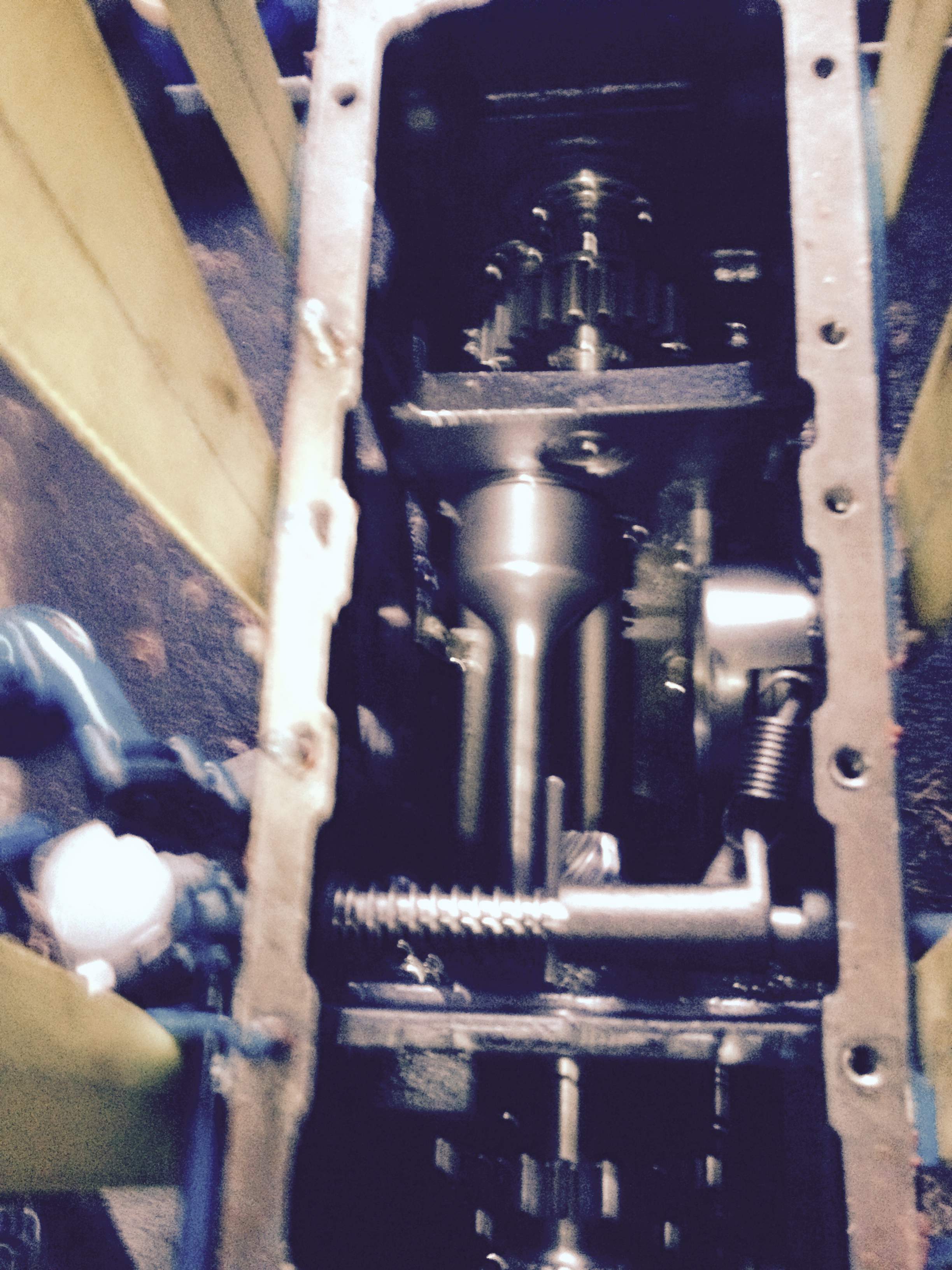

Just looked at your pictures and realized you dis not split at the clutch housing. On your 2nd picture there is a metallic funnel shape device and that is your ORC. I think that is an aftermarket or replacement , just kind of remember from a very old thread, not 100% sure. What I'm sure is that is your orc and you need to verify it's operation like I suggested before.
JC,
   / Ford 1715 PTO Clutch Adjusment -- Help #34

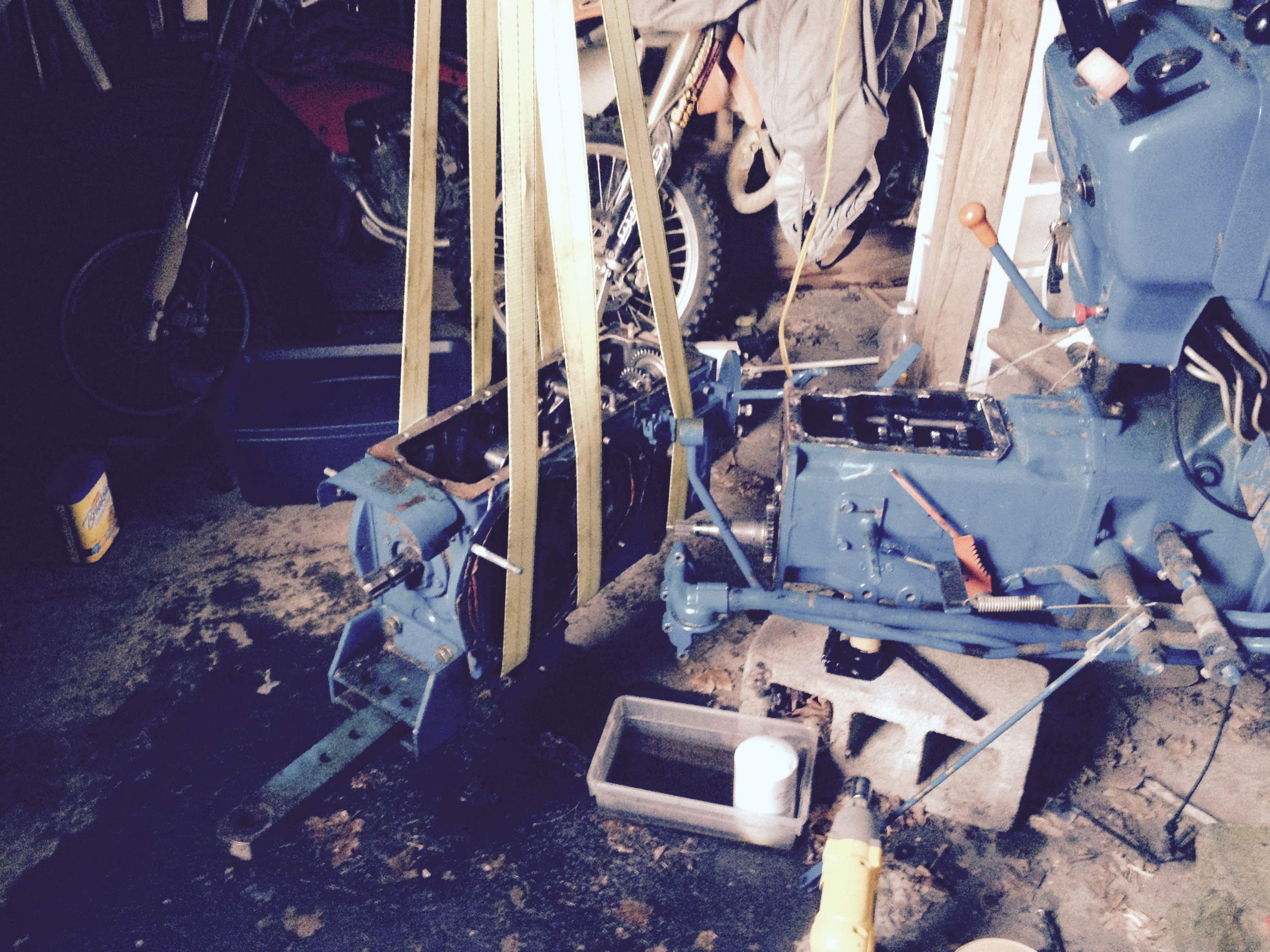

Thank You for your reply, the ORC works correctly by hand, I reassembled the rear end and filled it with the old fluid and the pto spins fast for about 1/2 a second then very slowly and I can stop it with any resistance. I drained the fluid and tried running it with the engine and the pto cannot be stopped, which leads me to believe that I either have the wrong fluid or the ORC is worn and only works properly at low RPM's. the ORC in my tractor resembles the replacement part in the TSB that was provided by the local dealership. (there is a pin in the center of the shaft that drives the ORC from the countershaft that is driven by the input shaft from the clutch.) I included 2 pictures of that countershaft, in the TSB the old one does not have that pin it is in the list of replacement parts. the shape of the ORC also resembles the replacement part, not the original. I saw in another thread that there was a detent pin that holds the pto engaged and there was a suggestion to use a bungee cord, I tried this last year holding the pto lever in the engaged position by hand and that did not help. I think I have a single clutch based on the information you provided the power comes in from the clutch, is transferred to a countershaft which drives the ORC shaft and on that shaft there are gears that engage the ranges and from there the power is transmitted back into the transmission. I can drive the various pieces of the PTO out, but I was hoping to avoid extra work if it was unnessassary because the problem is elsewhere, also the "one way clutch" described in the TSB and service manual is a special order part non-returnable that is $262.00. that old post you remember was probably this thread page 3, that is how I knew what I was looking for when I tore into the tractor. the other post I found that gave me the idea of the detent pin is titled "Need advice on NH 1715 PTO Issue"

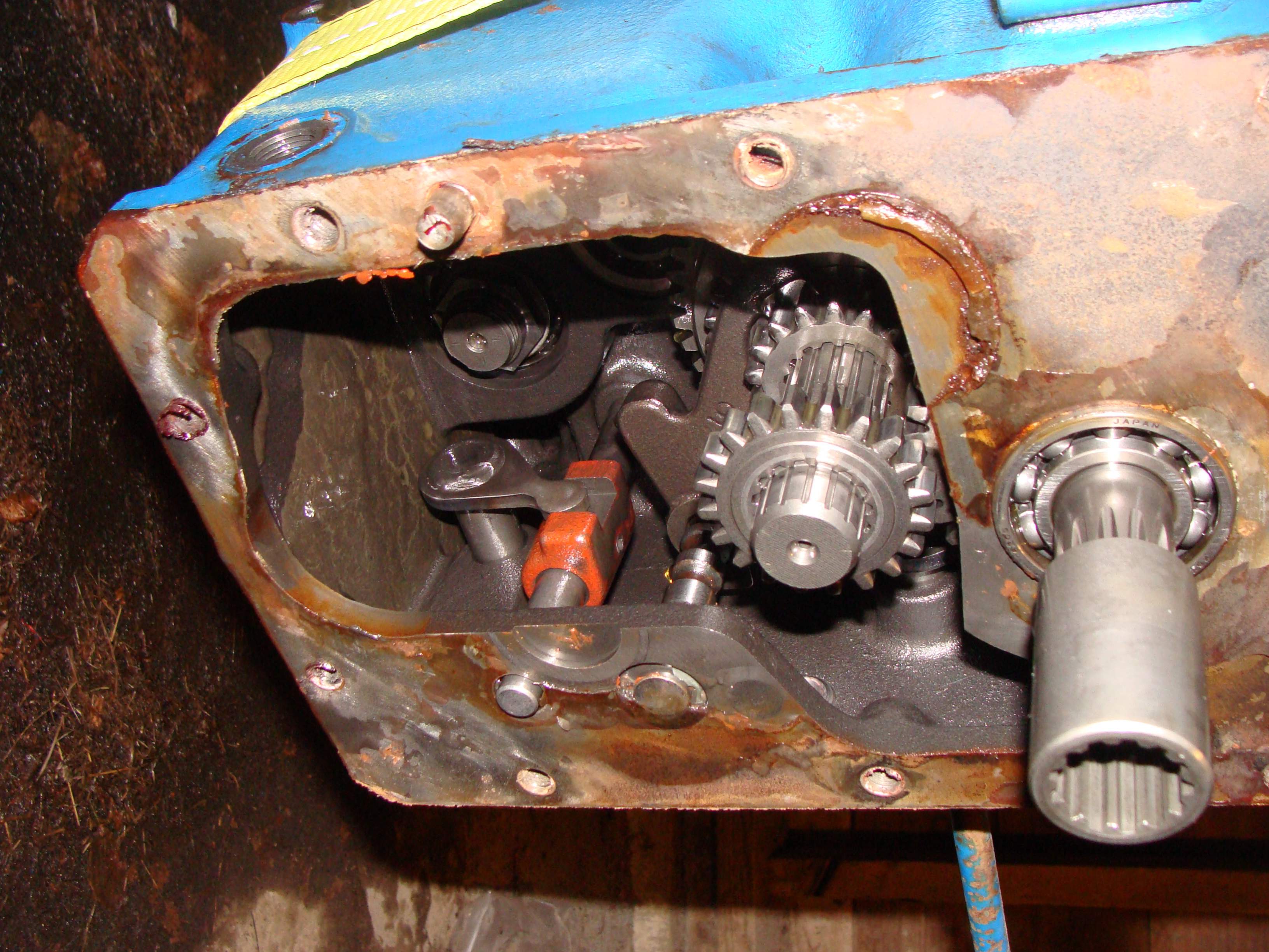

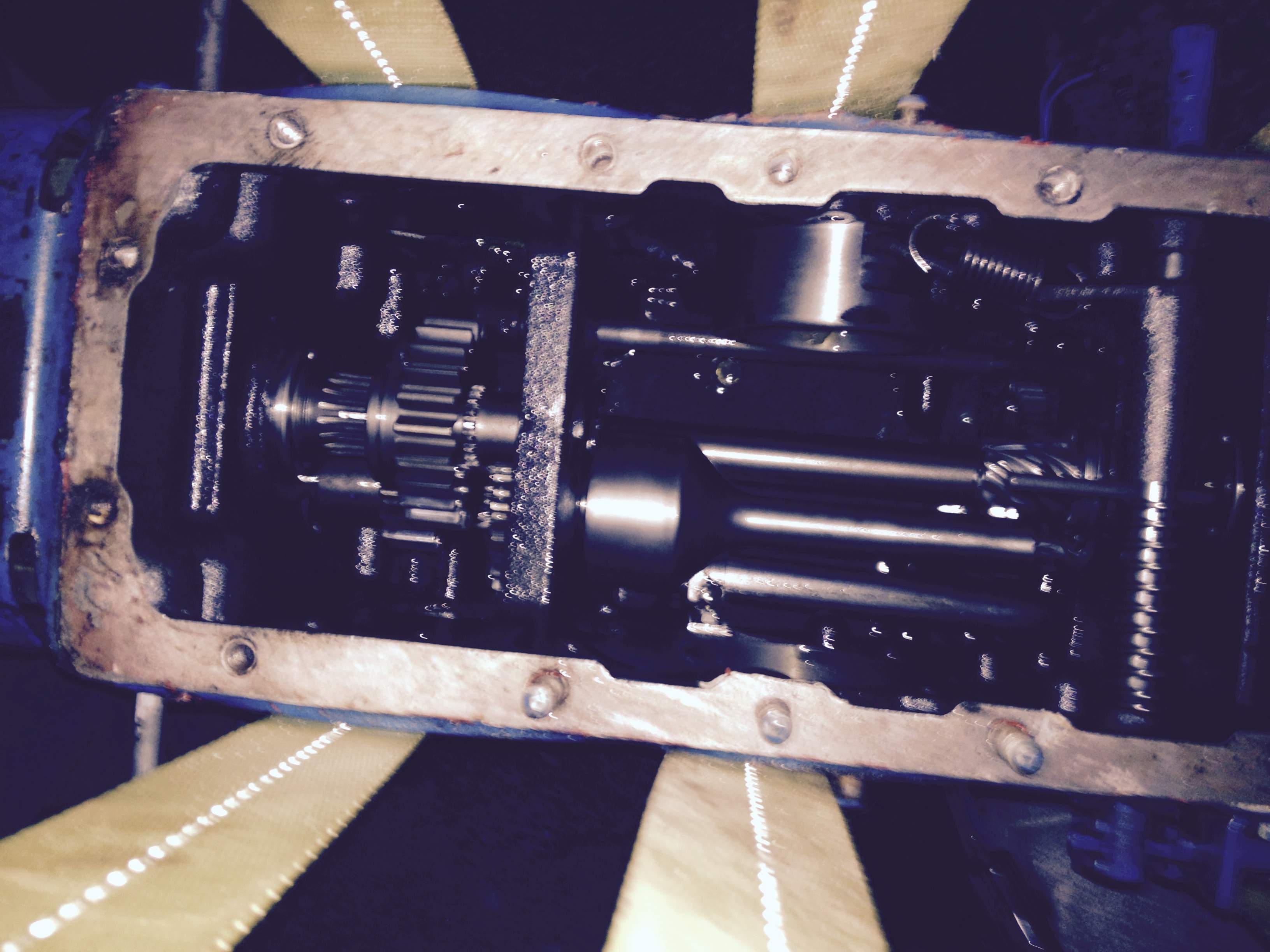

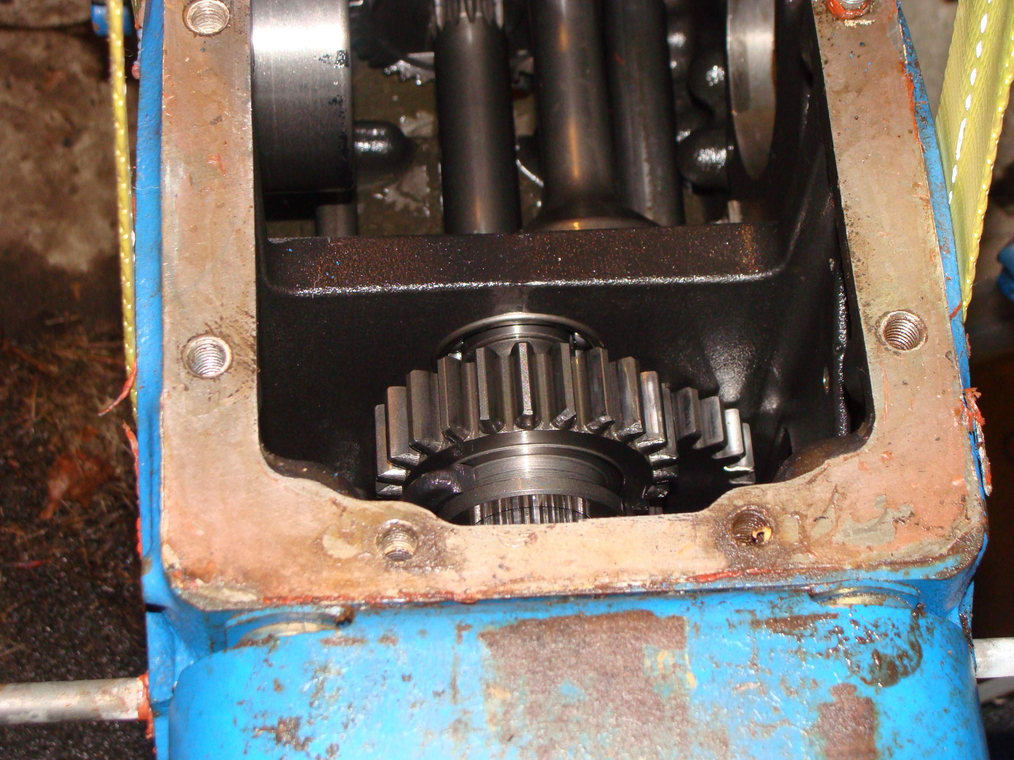

I think I ruled out the "detent pin" issue, the pto engagement lever and sliding gear seem to be working fine (I don't really see where there is a "detent pin"), I did notice some wear on the sliding gear, but seems pretty minor, I will add pictures of the internal pto engagement lever, and the sliding gear to this post, used a better camera I think so they should be better quality than the other ones I posted.

when you fill the diffy with oil and PTO turn and slows down might be what is called "hydraulically coupling". The oil between the gear specialty when cold helps with the engagement but lacks torque and the warmer it gets it has less viscous force to help with the coupling. Your ORC is entirely mechanical in nature and type of oil should not matter for it. I would have wedged a piece of wood in the gear with diffy separated and tuned PTO. It should turn okay in one direction and if it is wedged properly it should not at all turn in the opposite direction. If it does I think PTO internal gear (one way clutch) is chewed up or damaged. Did you find tale tell sign of grounded up metal shaving in the bottom of the diffy?

There is actually a detent ball and a spring that holds the engagement lever in engaged position. There is access to it on the side of the diffy when I last looked the diagram. Again , you said you used a bungee cord to keep the lever in engaged positions and it never jumped out. Did you see a pin on sliding fork to the shaft it is attached? usually there is a pin that attached the fork to the shaft and piece of wire wrapped around the shaft and the pin hole to keep the pin steady in place.

I held the lever in the engaged position with my hand, did not use a bungee cord. The pto stopped working even when I did this. I did not find metal shavings in the fluid, I drained the fluid originally last year and it was almost all grey that was when I replaced it with the TSC fluid and changed the filter because the bucket was not working because of the cold. I found the detent ball and spring under a cap screw just behind the pto lever, removed them and the lever functioned without resistance, I replaced them so they did not get lost. then with the pto in the engaged position, I jammed a stick in the gears so they would not turn and grabbed the orc countershaft and tried to turn it both directions, it would turn only one way so i assume it is functioning properly. These tests lead me to believe that everything is functioning properly (the ORC works smooth, no grinding of any kind). I know that the clutch is working good because plowing snow this winter I was able to stall the engine when the traction was available pushing snow banks back. The pto engagement shaft is connected at both ends with pins and the connections are solid. I'm Stumped. The only thing I can think of is the fluid because the entire system seems to function correctly as long as there is no fluid in it. Pondering reassembly and purchase of FNH134 fluid to see if that makes a difference, does that seem like a dumb idea at this point?

3-I suggested to jam a piece of wood to check the rotation but I think it is a good idea to get a wrench and try to apply maybe about 20 lb-feet ot torque ro so to see if it spins. May be hand pressure does not apply enough torque. Obviously you do not want to turn so hard to damage gear.
I might suggest another reason, all things check out but if you did have a dual clutch then for sure it might be your second stage of the clutch that operaates your pto. On live (dual clutch) situatin some time they have ORC and sometimes they don't based on make and model. I might check NH website to see if your rig can have ORC with double clutch or not. IF it is your double clutch it might just need adjustment.
