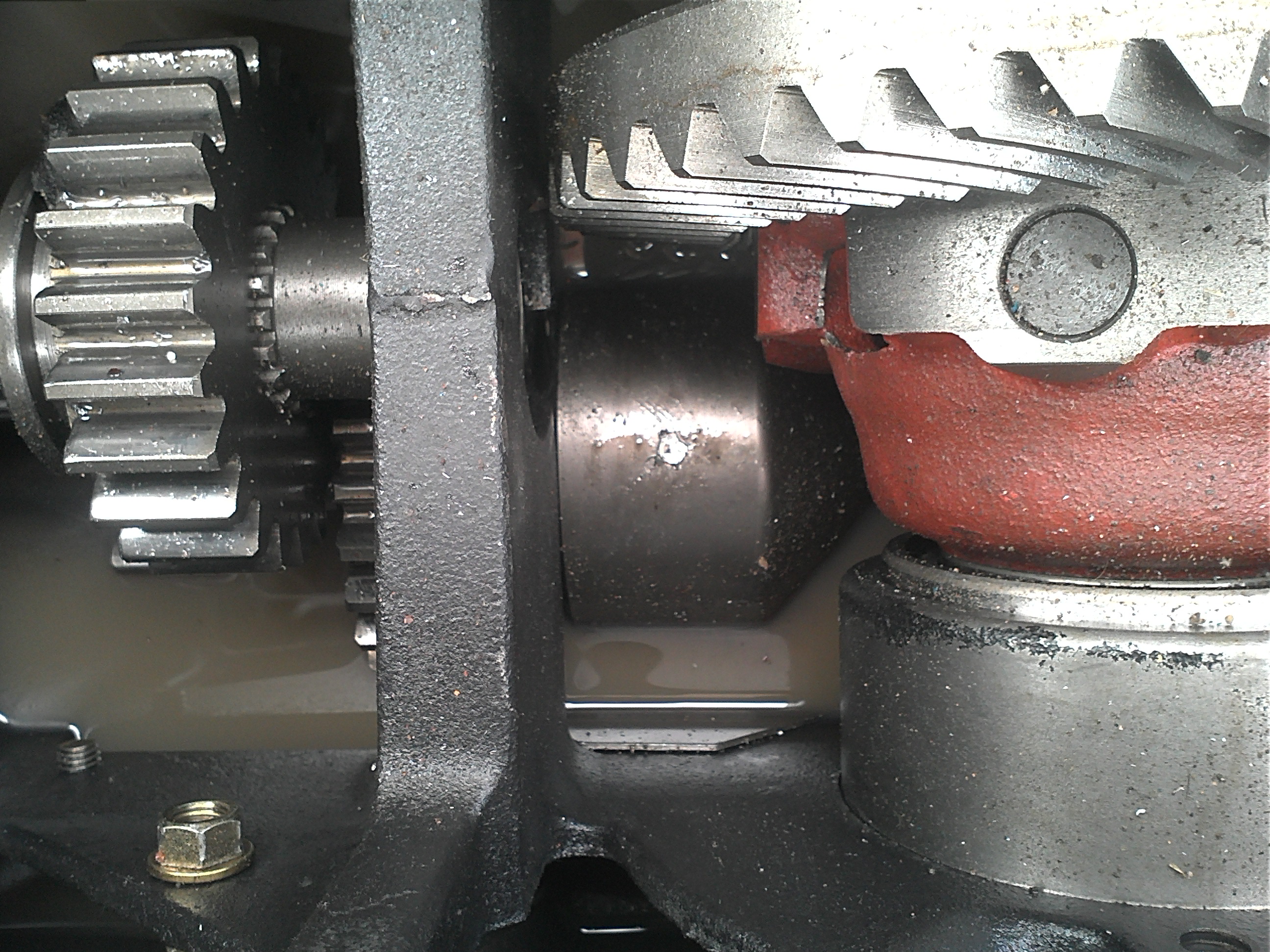

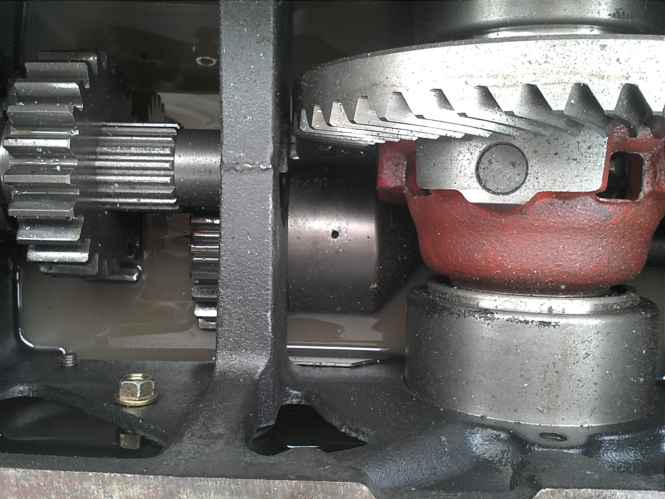

A little late to the thread. I bought a 1715 with 2400 hours this winter, and it has 'the' problem. Of course they didn't tell me... :( Parts are about $600 to 'fix' the problem, if it's the overrunning clutch. I only need the PTO for a tiller, and I can always add an clutch outside if I want to cut weeds. I'm a pretty decent machinist, and IF I can get at everything from the top without splitting the tractor, I'm tempted to either A.) carbide drill through the bearing and press in either a roll or dowel pin in place right thorough the bearing or, B.) if there is room, make a pair of split collars to go around the over running clutch and clamping it out of commission, in both cases making this a solid shaft. Can anyone who has opened up the case tell me if this is outlandish or not?
   / Ford 1715 PTO Clutch Adjusment -- Help #73
I'm updating my own post. I drilled a 1/8" hole through the overrunning clutch assembly with a carbide drill bit. Use solid carbide; anything else will dull quickly. You can get a cheap bit on ebay. You will be using a short bit; it's very close to a clearance limit depending on your drill. Turn slow. I'm a decent machinist, but if you do it, go slow and expect to break a bit or two. Also, keep the drill turning while you back out of the hole; that's the only time I broke a bit. I drilled about 10 mm to break through the outer race, then drilled to about 17 mm to hit the bearing carrier. You will likely hit between two rollers. To go deeper will be very slow because as you drill you are spinning the roller on each side of the drill bit. You can stop there or go deeper; just don't break the drill bit or you get to start over, AND I wouldn't want a piece of carbide falling out in the gearbox. After you stop, drive a spiral type roll pin (these are stronger than a normal roll pin-- I ordered them from Grainger) and drive it in until it stops. Beat on it. Grind off any excess. The 1715 can put out 650 ft-lb of torque at the PTO, at this diameter, that roll pin will see about 1000 lbs of shear. It may never break BUT... If it does, the roll pin will eventually ruin the bearing race and jam the clutch solid, which is what I want anyway. If that fails, I'll drill a 3/16" hole and use a bigger roll pin; I already have a good pilot hole. If I ever need overrunning protection, I'll buy an external overrunning PTO clutch.
Pictures below. It's the least work fix I could think of. I didn't even have to split the tractor.
