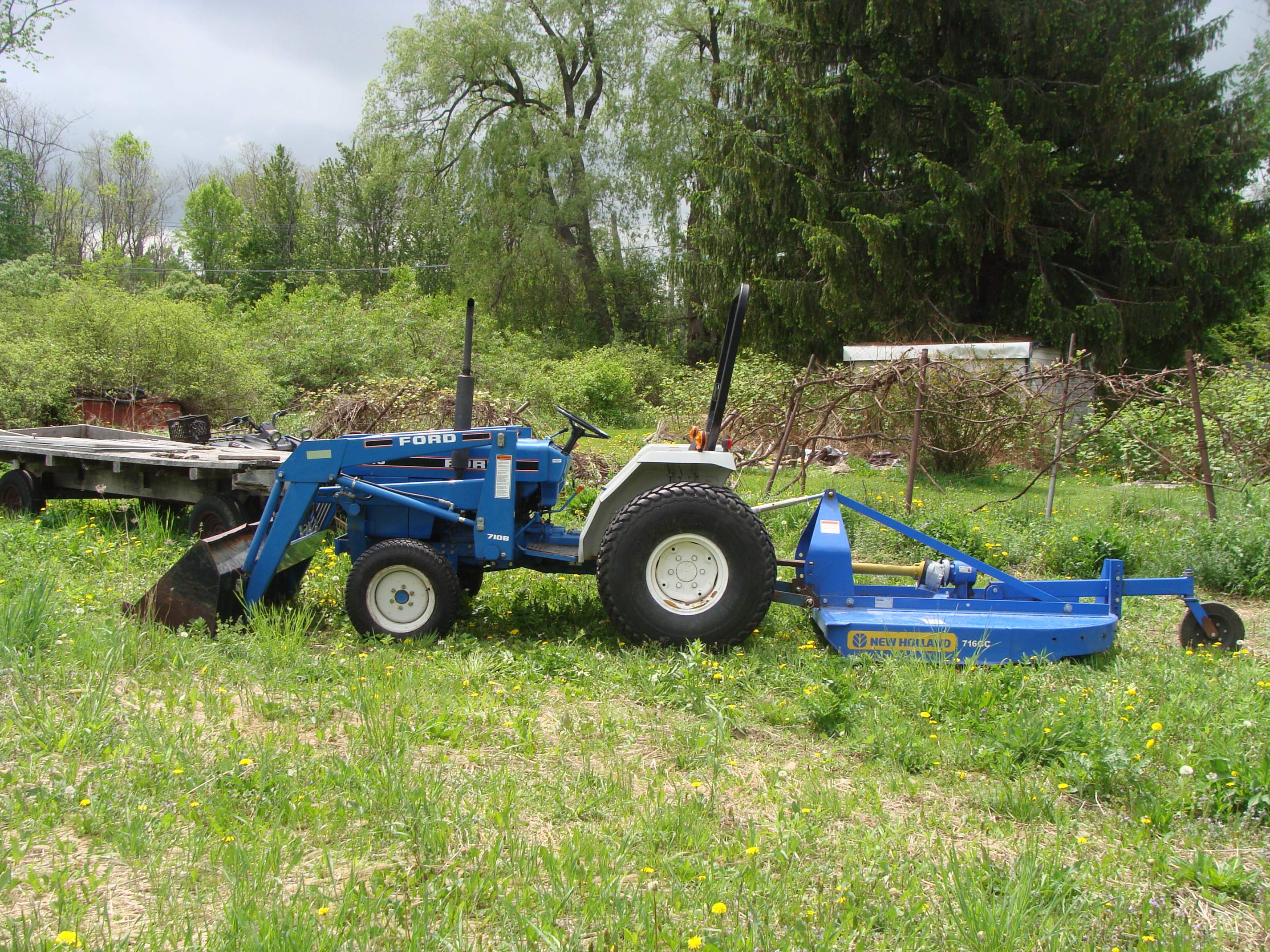

I have a 1715 and had similar pto orc problems. I read all the discussions regarding this issue on this site plus a few others and was convinced that I needed to replace the ORC so went to the local NH dealer to check availability of parts and to get price estimates. I experienced the problem of the PTO disengaging while using a rotary mower, however, one thing I noticed was the warmer the tractor got the less the PTO would disengage. I saw no mention of this in all of my reading. After discussing my problem with the shop manager at the dealership, he seemed to think that the problem was not the ORC and that I should start disassembling the tractor and look at everything closely as it was removed. I got to thinking about it and realized that this whole problem started about the same time that I did an oil change on the transmission which was about a year and a half ago and I didn't use NH 134, so I changed the oil again using NH 134. I recently completed two weeks of mowing and had no PTO disengagement problems. An oil change it a lot cheaper and easier than replacing the ORC so it's a good place to start.

I reassembled the tractor on Saturday, had to wait for the gaskets to come in and the liquid gasket to cure. Today I picked up the gaskets and installed them, filled the tractor with NH 134 and reassembled the rest of it (The dealer even tried to talk me into some cheaper fluid he had there I respectfully declined his suggestion). Surprise! no more disengagement issues! I hooked up the brush hog and everything worked as it should. Boy am I glad that I didn't bring it to the dealer, saved myself a good chunk of change by tackling the project myself, maybe the wife will let me buy another implement with the money I saved :eek: (NOT)!

I ran the 60" New Holland 716GC today for over an hour and everything worked perfectly, only thing left to fix is a burnt out light fuse because I hooked up the fender lights backwards, I hate electrical crap lol.
