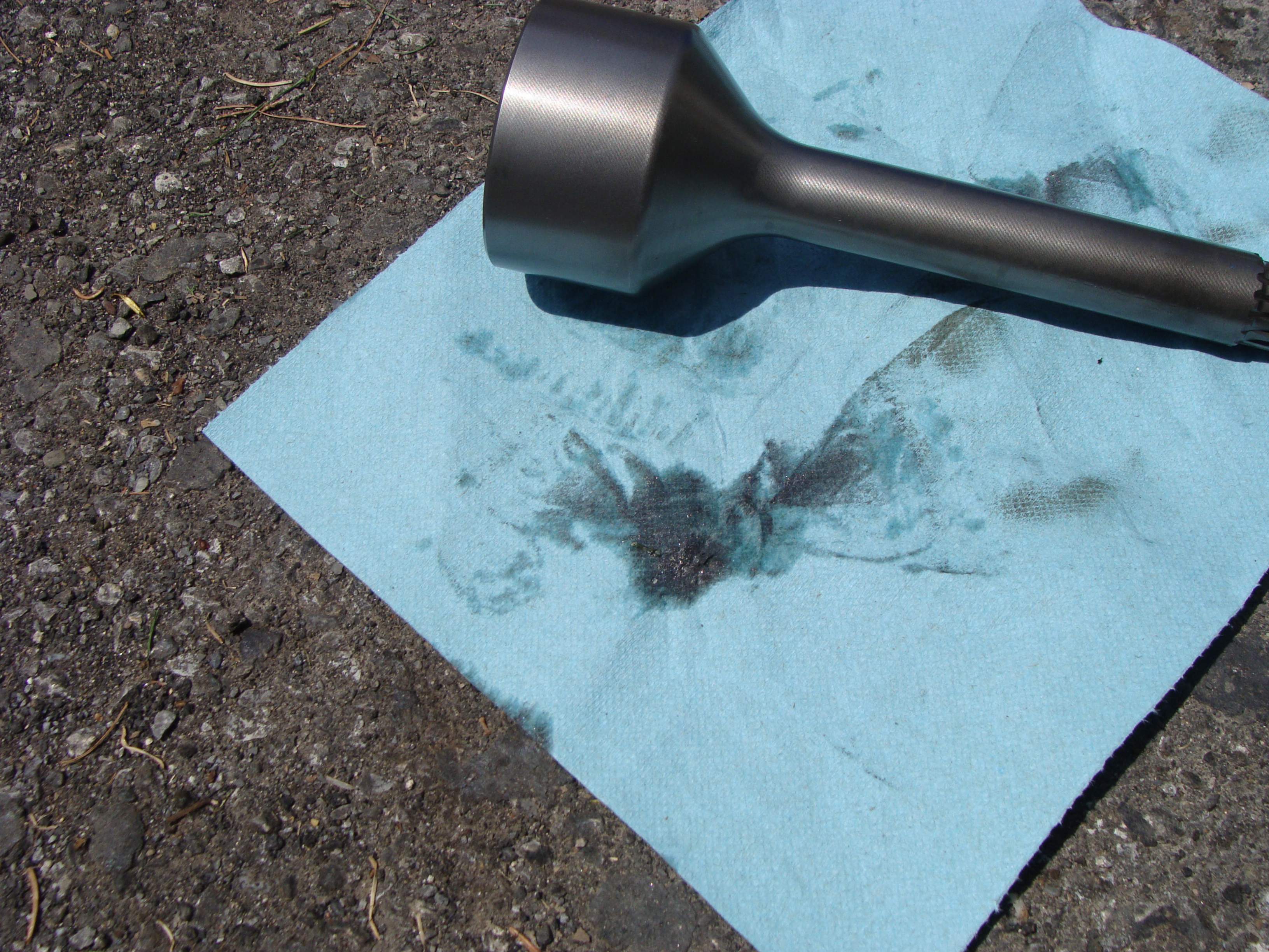

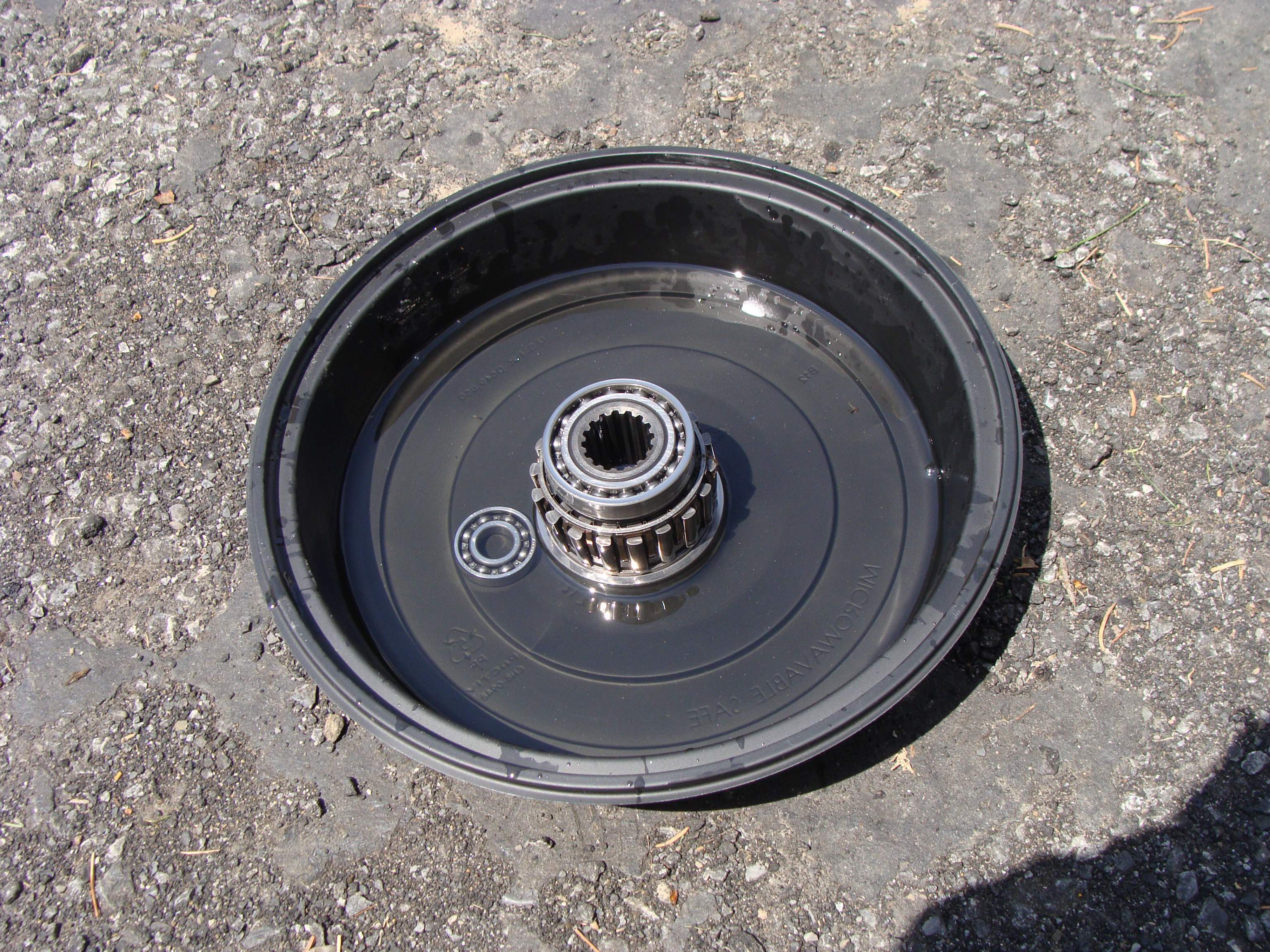

I rinsed the parts in some k-1 kerosene, the bearings seem perfect, however when I rinsed the sprags very fine metal chips came out, I tried to capture them in the sunlight. I also wiped the outer race out with a towel and the towel was shiny when I was done, I am not sure if this is a indicator of wear of the sprags, outer race or inner race or all 3. I am wondering if the fine metal shavings were causing the orc to slip when it was immersed in oil? As I stated earlier in the thread the orc seems fine when not in oil, however as soon as I fill the rear end with fluid the pto does not work correctly. I am curious what your take is on this, and do you think this is the source of my problems?

Joe, can you put the orc in a vice sandwiched between tow pieces of wood facing up. Can you then fill the inside full of oil and then try to rotate the inner race. it should turn in one direction and not on the opposite, that might give us some clue.
I there a retaining snap ring inside outer race of ORC for further dis assembly. I can not see the metal shaving is picked up from the bottom of the diffy housing to the inside of ORC. I wondered the grab teeth (don;t know what they are called) are rounded off.
JC,
Edit . just notcied you broke a part the ORC. I take my question above back. we'll go back to review the pics closely.

I'm bamboozled sitting in my chair, can you see tell tale sign of metal eroding from the sprags. Can see by hand if the the sprags makes interference with the outer race? Can the sprag move in and out by centrifugal force to grab. Everythig looks so pristine. I wish I could have something more solid to offer.

If you expand my picture of the sprags in the black tub of kerosene then zoom in you can see the glint on the metal shavings in the light, and now that I think about it I bet the fluid I changed last year had the same metal in it and that was why it was a kind of sparkly grey color. On the shop towel is in the first picture from post #51 you can see what a quick wipe of the inside of the outer race turned up, expand the picture and zoom in you will see the shine of metal shavings. I think that there must be some wear on either the inner of outer race, I have yet to inspect the inner race, I bet if I just replace everything in these pictures it will fix the problem. I bet that the inner race has worn to the point that when the pto spins at operating speed the sprags cannot grip it firmly enough and the pto looses power. the bearings are pressed on the inner race I need to be able to pull one of them off without damaging it to inspect the inner race, then I can measure the races with a caliper and see if they are out of spec, provided I can find the dimensions somewhere. I will post a picture of what I find when I get that bearing off.
