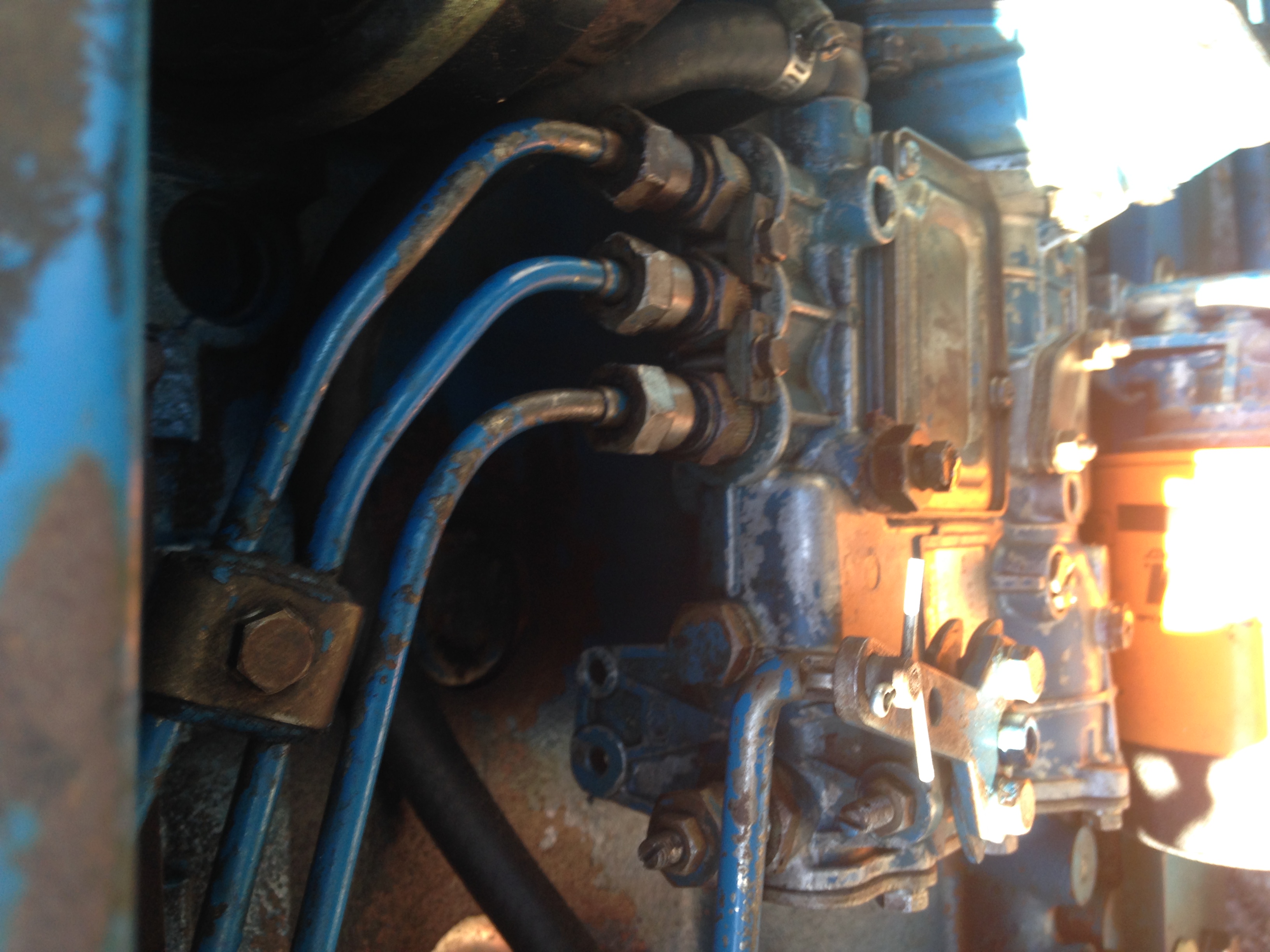

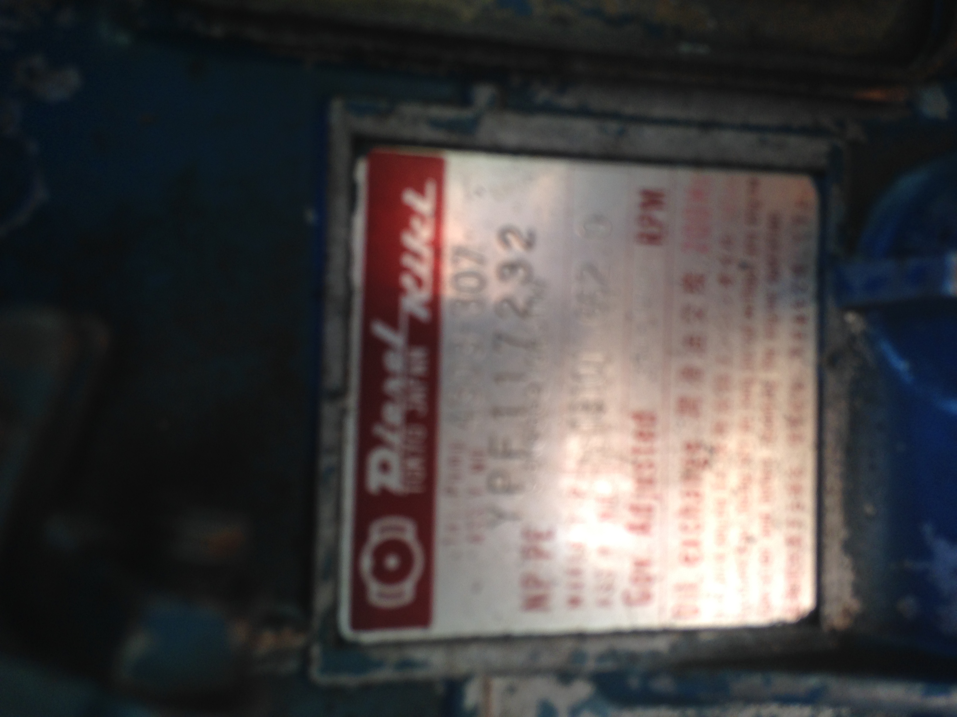

Ther is no air shut off. The air filter goes directly into the valve cover. I will replace the fuel filter but thats not the issue. IMG_0261.JPGIMG_0262.JPG. Could I buy the tools to rebuild the pump? If its not sucking air and getting fuel what else could it be?

Theres nothing in the pump you can fix.. just make sure the top nuts[delivery valve holders] are torqued to 30-35FTlbs.
Did you bleed the air out AT the injection pump bleed screw??
/ ford 1900 injection pump help #10
When I rebuilt the engine on my 1700 it was **** getting the pump primed the first time. I had to remove the lines from the injector pump and then remove the nut on top that was under the line, it has a spring and plunger type check valve. I then rotated the engine until fuel flowed from each check valve. Put it all back together and cracked the line at the injector, cranked until fuel sprayed out, tightened the line and it fired right up. If that don't work I would say you are sucking air before the pump.
/ ford 1900 injection pump help #11
I've run my 1900 out of fuel a couple of times in the 10 years I've owned it. And it's a real PIA to get going again cause these things do not like air in the system. I'd bet like others have mentioned you are drawing air in somewhere. And I would suspect a stripped bleeding screw on top of the fuel filter asm (which is $300 to replace). Mine is messed up and I've just sealed a bolt into position there and if I need to bleed it I'll take the line off first !
