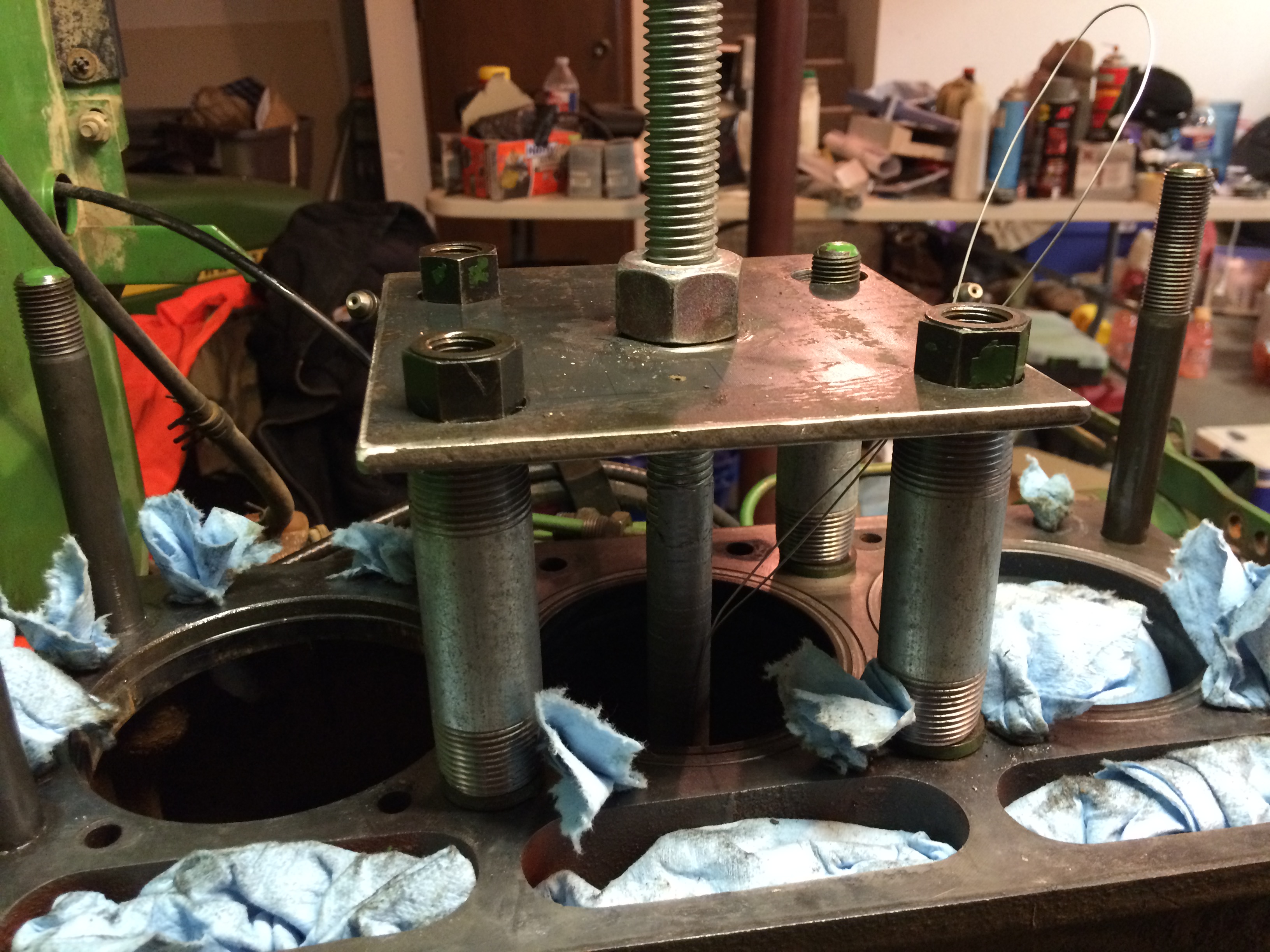

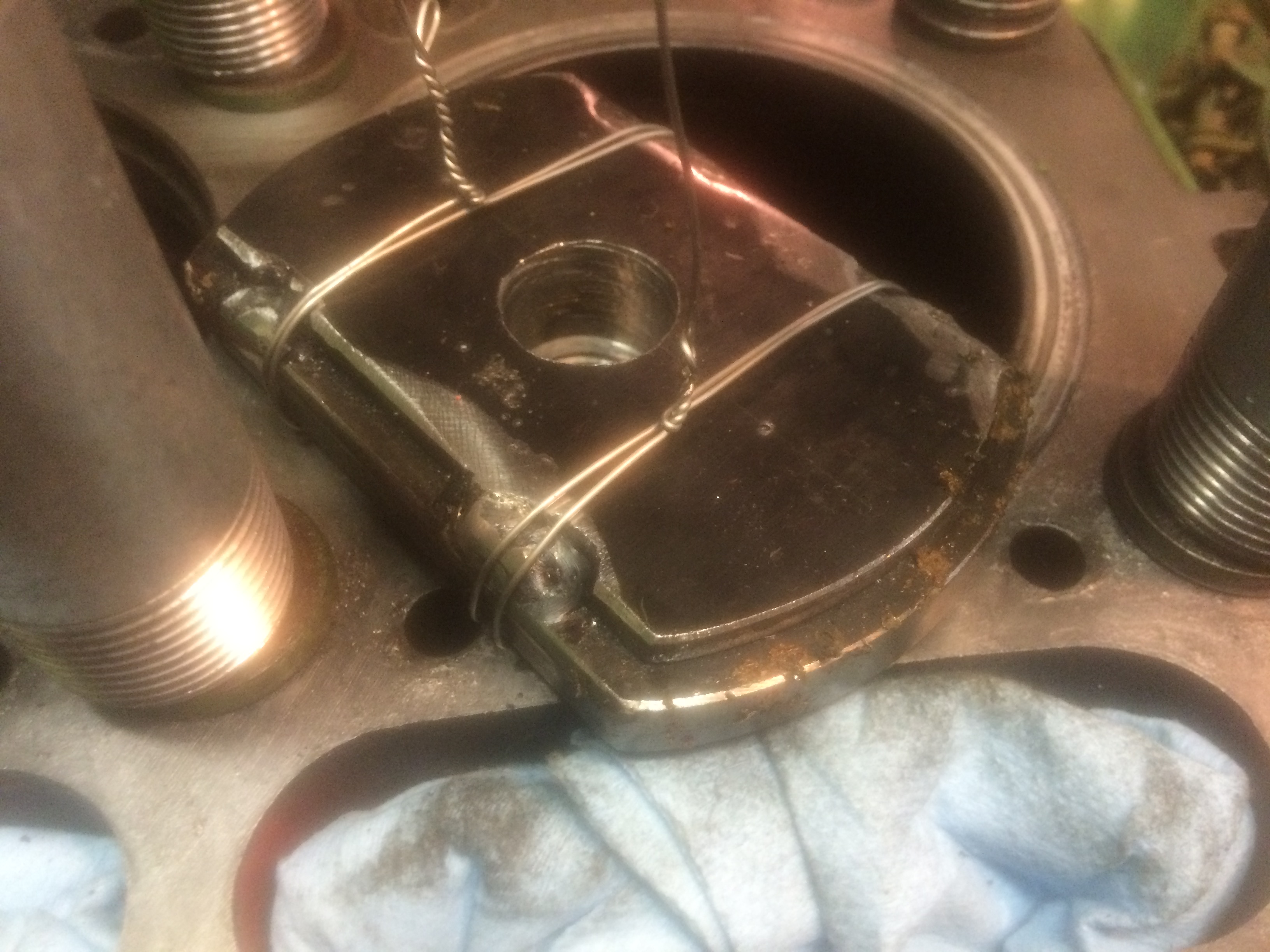

I made my sleeve puller from a couple of plates about 2 -/2" wide. One is trimmed just shy of the sleeve od and the other is trimmed just shy of the sleeve id . Tack the plates together, drill a hole in the center, add a piece of all thread and you have a custom puller.

Nice, I wish I knew how to use my camera and post photos. This is similar to my idea, the lower plate idea I have, because the lower plates I have are 3/8 thick and curved as I cut them from a steel pipe almost the exact diameter needed. I cut a one inch section out of the pipe and then cut that in half. I then trimmed a 1/4 inch off of both these and I will be welding nuts on the inside of each so I have an adjustable diameter to use on other jobs. a nut will be welded in the center for the center post up to the puller. I know this sounds hard to understand so I will get a friend (kid) to show me how to post photos. LOL What are the wires doing that I see in your photo?
   / ford 1910, can't find parts #45
That overhaul was in frame so the crank was still in she engine. The wire allowed me to drop the plates in from the top and then screw in the all thread. This puller won't go in the hole with the all thread screwed into the plate.
#46
I am doing the same thing, engine is still bolted to the tranny in the frame, with the crank still in the block. This is what I was thinking when I started this, drop it in from the top and then spread the two pieces to catch the bottom of the sleeve. I have never seen one or done this as I usually take the block to "my guy" to remove and replace the sleeves. This my first attempt to do it myself so it is a big learning thing for me and any excuse to use my welder is fun. I never thought about the crank being in the way to do this so the two piece thing I am building will make this possible ( it was not thought about at the time, funny) I still have not removed enough of the ring groove to get the pistons out, there is a very deep and sharp groove at the top of the cylinder.
   / ford 1910, can't find parts #47
The factory puller is similar in style to what you describe. I think you will want something to keep an outward pressure on the jaws. Mine were wet sleeves and it doesn't take that much force to pull them. I was also concerned that my puller didn't score the block as it came up thru the hole. I ended up just tracing the liner on the plate and using a hand grinder. My plates are a bit crude but they work well.
#48
Mine are wet sleeves also, they just came in today. the pieces of steel I will be using are a perfect fit with the outside diameter of the sleeves. I plan on welding something on the inside so they can't go out wider than the sleeve but I will be able to make them smaller by turning two nuts on the inside that will pull the two sleeves together. . This I will be using with a very big puller I already have only the jaws will be grabbing the new piece I am building. I am glad to hear that the wet sleeves come out easy.
#49
I finished my version of the sleeve puller yesterday, I wish I could post a photo but I am still feeling very stupid with this technology and cant seem to post photos. I will attempt to pull my sleeves today. A friend told me I should have used a fine thread puller rod and not the course thread I used. I used it because I had it and it is the same as you have, did it seem to work out for you? How much force was needed to pull the sleeves?
   / ford 1910, can't find parts #50
Course thread should work fine. In my experience it should only take about the force exerted by torqueing/turning the course thread nut with a long rachet. If it doesn't move I would put a good tension on it and tap the puller with a hammer. You'll be able to detect a little movement as you will ba able to turn that nut just a tiny bit. Once you get it moving it will come out pretty easy. Personally I would avoid using an impact.
