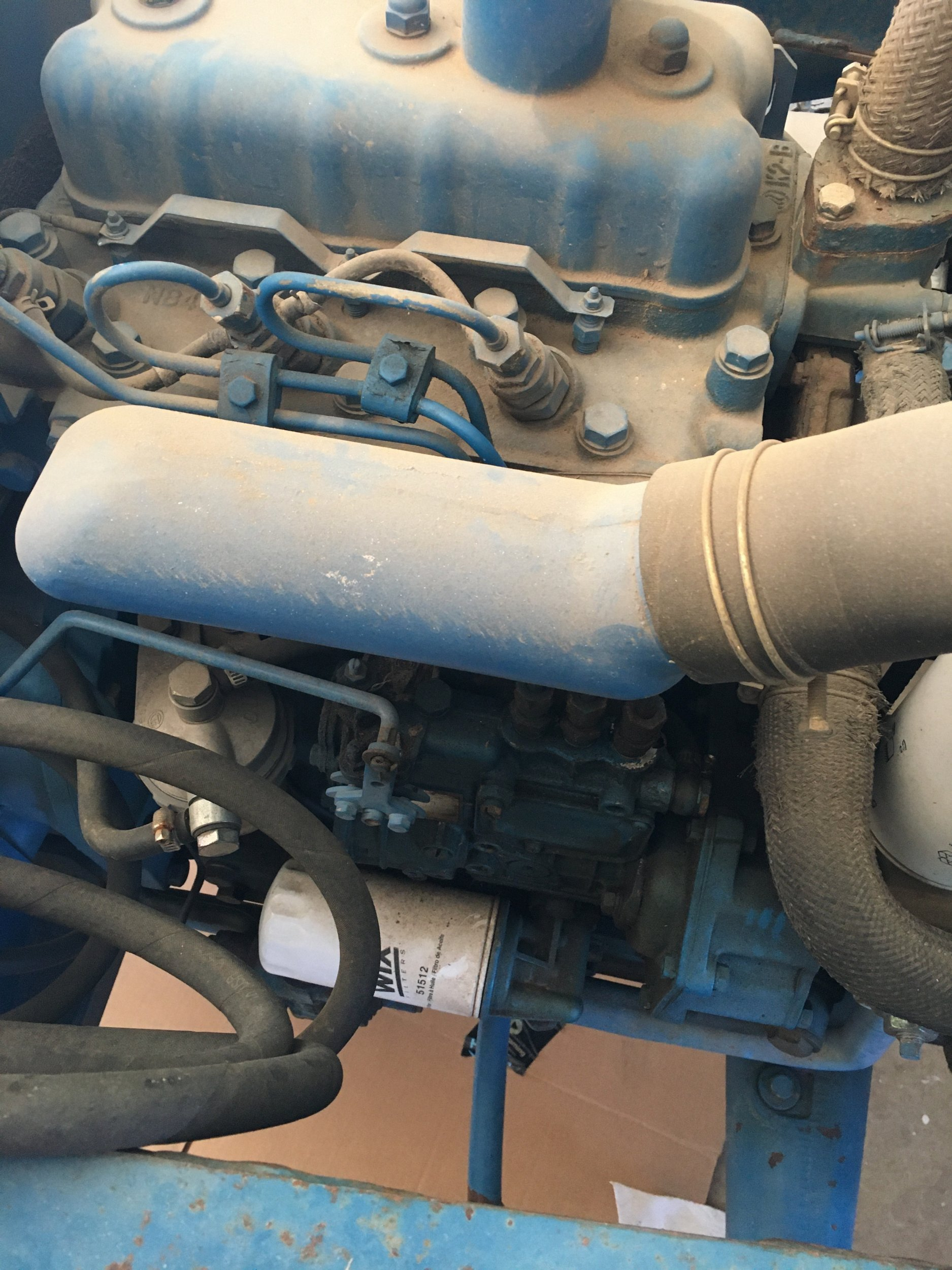

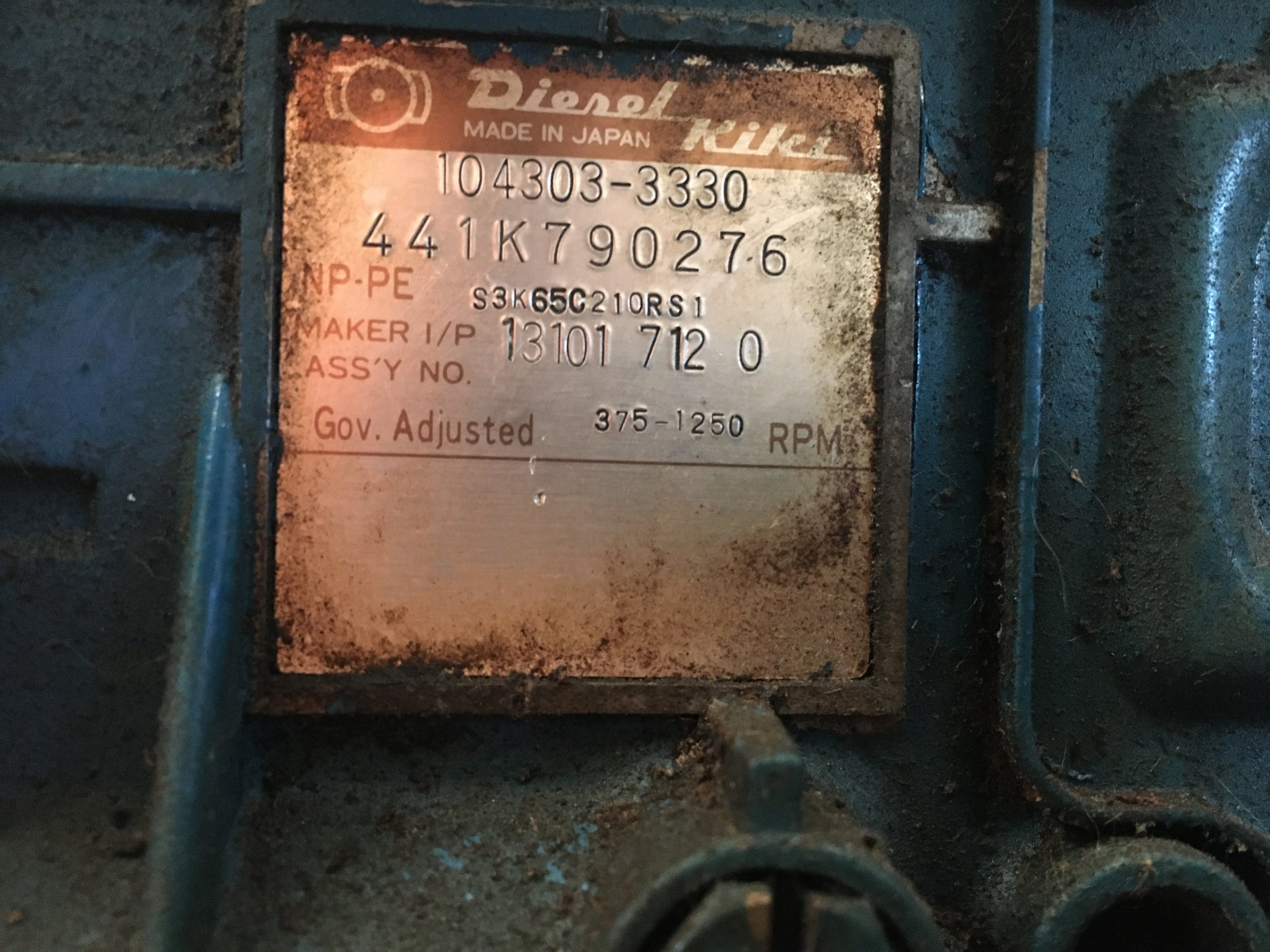

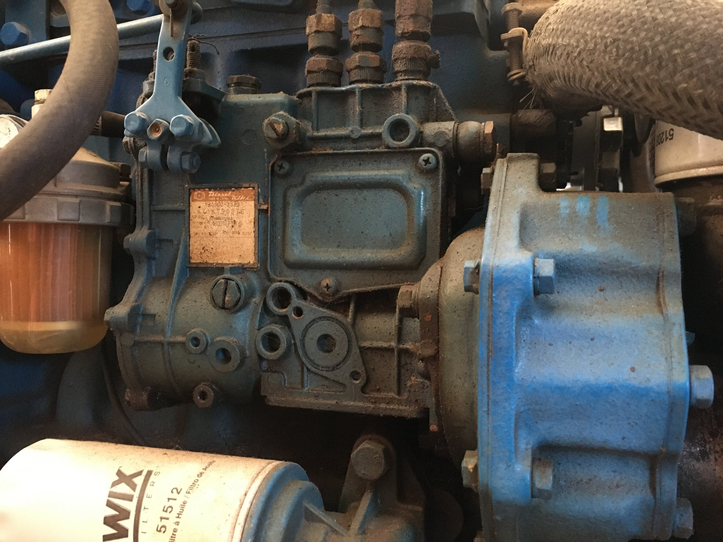

Okay. Doesn't look like there's something I can identify as a lift pump, but here are a few pics to give you an idea.
-Jim
   / Ford 1910 Fuel in the Oil and Puking Out Breather Tube #12
-Jim
View attachment 764554View attachment 764555View attachment 764556
Have you ever checked the oil in the injection pump itself? We check six tractors every time we bale hay or use for an extended period.
Never mentioned a lift pump. Fuel is gravity fed on mine. It has oil in the injector pump. The big flat head screw under that tag in first pic is upper level oil check. Lower left is drain to change it

There isn't a lift pump on that model. As for the starting on those models, you have to always use the glow plugs.
Check the resistance of the glow plugs and make sure they are getting power.
If I remember correctly, there isn't a oil overflow line connected to that injection pump. Could the diesel be leaking out of the pump by the gear into the crankcase?

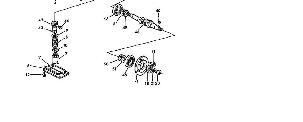

Item #18 is shaft seal to keep oil/fuel out of the crankcase. Need to pull the injection pump to replace. Sounds like fuel is leaking past the plungers in the pump. Will over fill the lube oil in the pump and force it past the seal #18. Would suggest sending the pump to a pump repair shop.

Well, that's not great news, but sounds like what my issue may be. Bummer.
Is there someone on this site that folks here trust to do such repairs?
