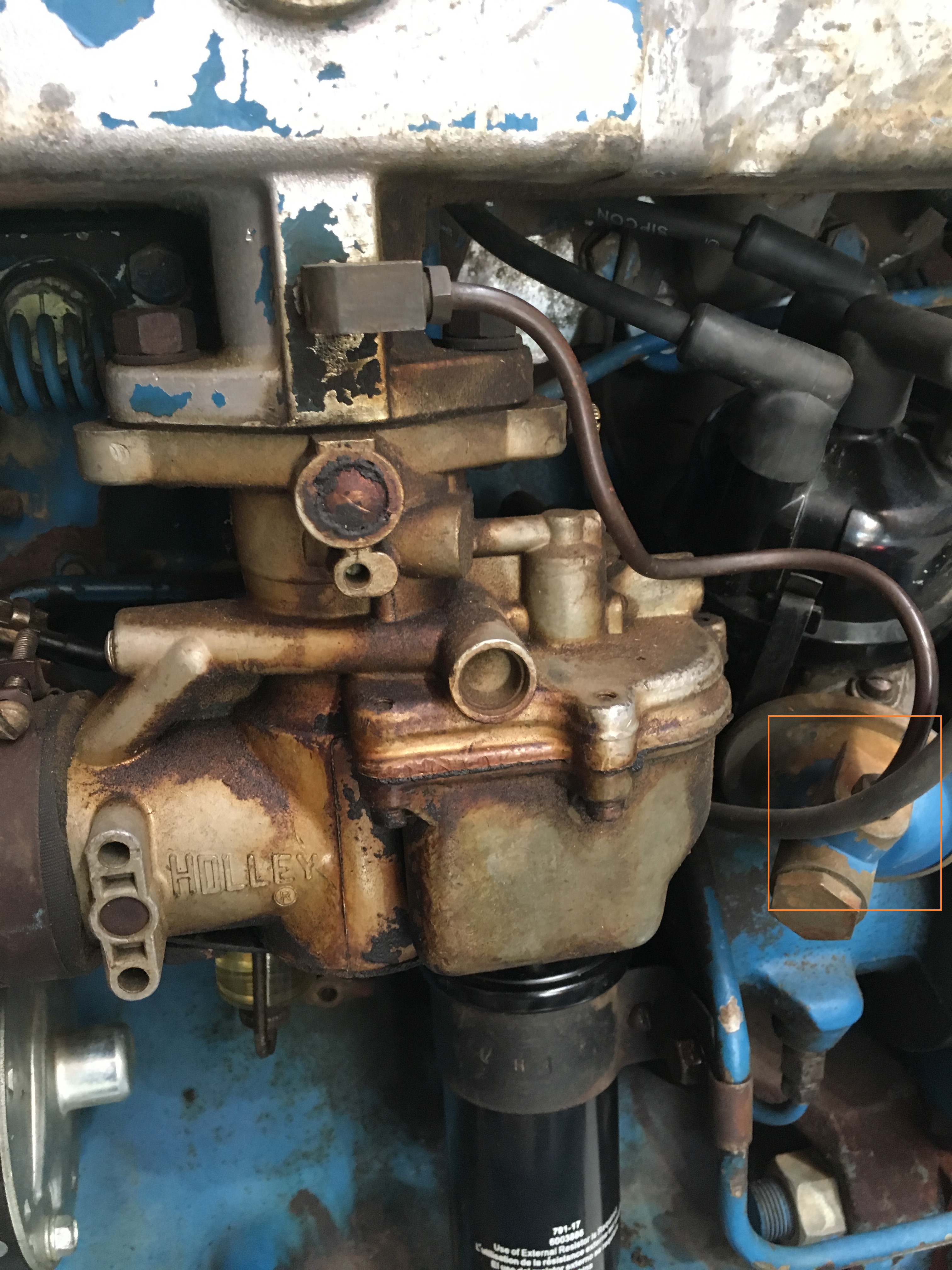

One more question:
When the manual suggests "pulling the vacuum line to the distributor" to test the timing, I assume they mean this metal hose (indicated by orange rectangle in picture below), correct?

someone not on a phone will have to look at the pic it's only about 2" for me.
but yeah, look at your vac advance. I'd forget about the gov for now, especially if it pulled back well when you manually goosed it.
   / Ford 2000 3-cyl gasser losing power with any load on PTO-suggestions needed to fix #24
Yes. That's the one. My guess is that the timing is probably o.k. I was thinking the vacuum line was rubber and had deteriorated. The rubber diaphragm in the diaphragm assembly may be shot. I would use a mity vac to check it.

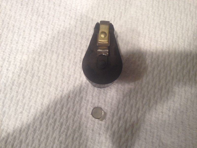

As soundguy suggested, doublecheck that rotor. My machine started running funky, still firing on all four but lacking in power. Pulled the cap today to find this:

Let us know on the rotor. A loose one will cause erratic timing.
