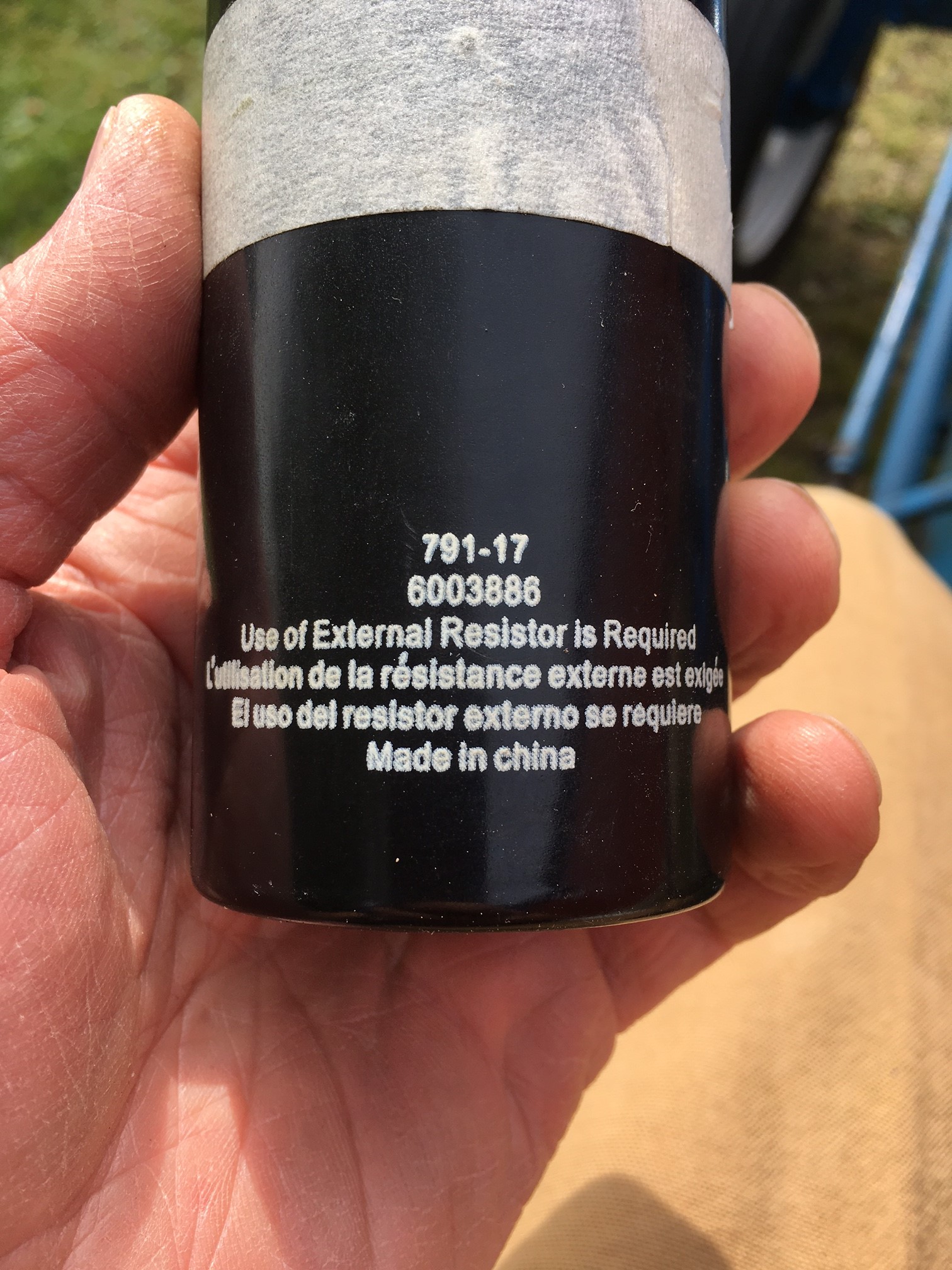

Well, the tractor has been fixed by the local dealership. The source of the problem was a bad coil. Yes, I had replaced the coil early in the process with this new coil:
The problem, as was explained by the mechanic, is that this is an alleged 6V coil which requires an "external resistor" which is stated on the print outside in order to work in a 12V tractor.
I never paid attention to it as this coil was supplied by another dealership's parts man whom I have worked with very successfully for years and whose track record has been stellar getting me proper parts.
Once a "12V" coil was installed, the tractor runs like a top.
Chalk this up as a good learning experience. I'm just glad I've got my tractor back.

Odd one. Back in post 15, when asked if spark was good, it was stated yes.
As for the coil.. 3 cyl fords were supplied with 6v coils and resistor wire in the harness. If the wire is removed, a 12v coil must be used, or a ballast resistor added.
Yes, we had spark at all three plugs, but, in retrospect, maybe it was a "weak" spark compared to what would be produced by a properly resisted 6V coil. In my ignorance, I wouldn't know the difference.
I wondered where the resistance was hiding. I didn't know if it was in the wire to the dissy or elsewhere. Thanks for the feedback.
   / Ford 2000 3-cyl gasser losing power with any load on PTO-suggestions needed to fix #47
the resistor wire is normally balled up and will be inline from key switch run, to the coil primary.
