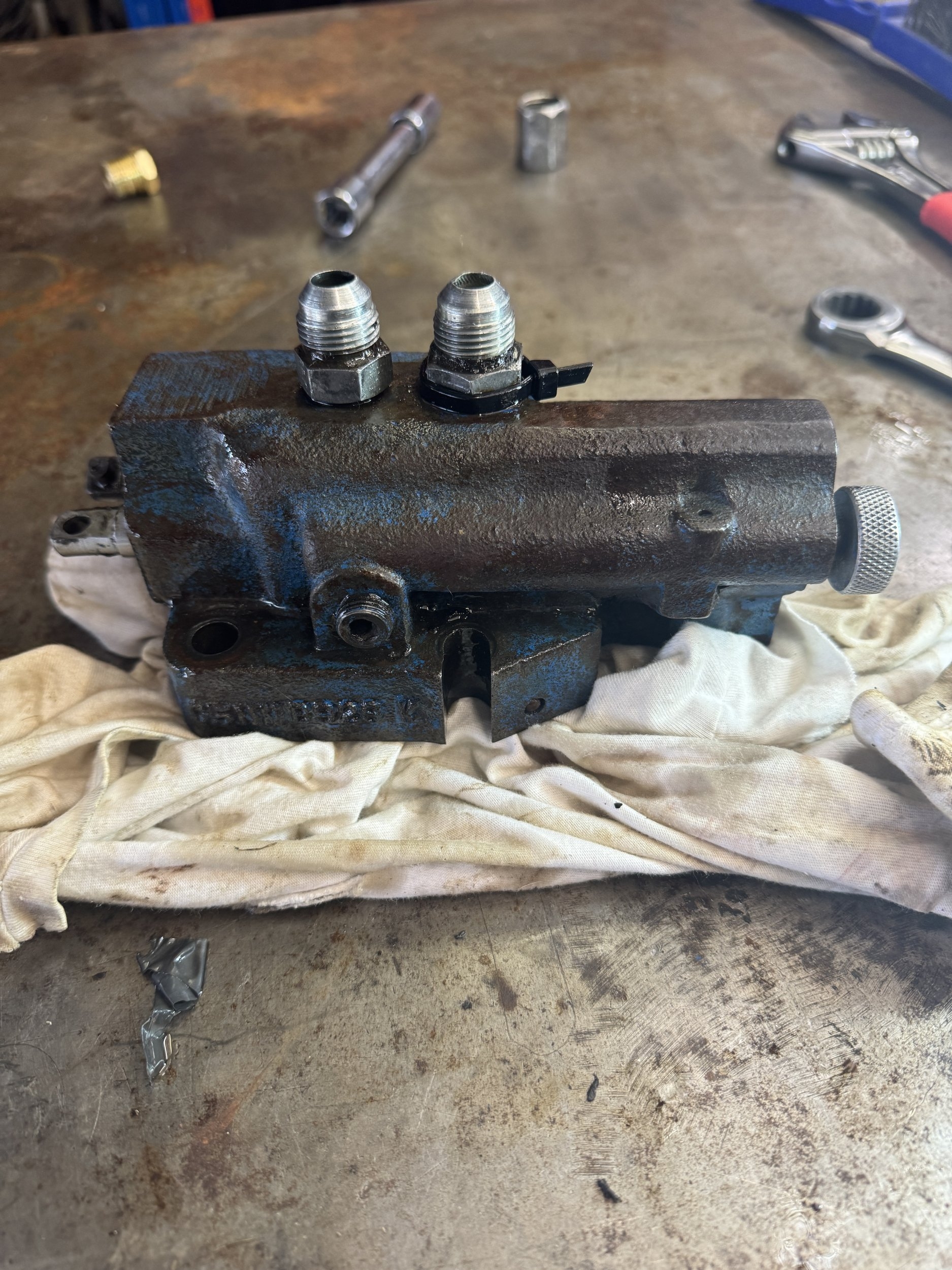

Hello all,
My tractor is a 1968 Ford 2000 3cyl diesel. I've finished rebuilding the top lid and now my 3ptl is working as it did beforehand. New piston, honed cylinder o-rings, safety valve and relief valve. Oh and a very worn cam pin too.
Even when I first picked up the tractor around 7 years ago, the front end loader always struggled lifting a round bale (around 350kg's+). I had the cylinders rebuild as they were leaking, however didn't change its power. Now that I have the back end working correctly I'd like to look at the front end.

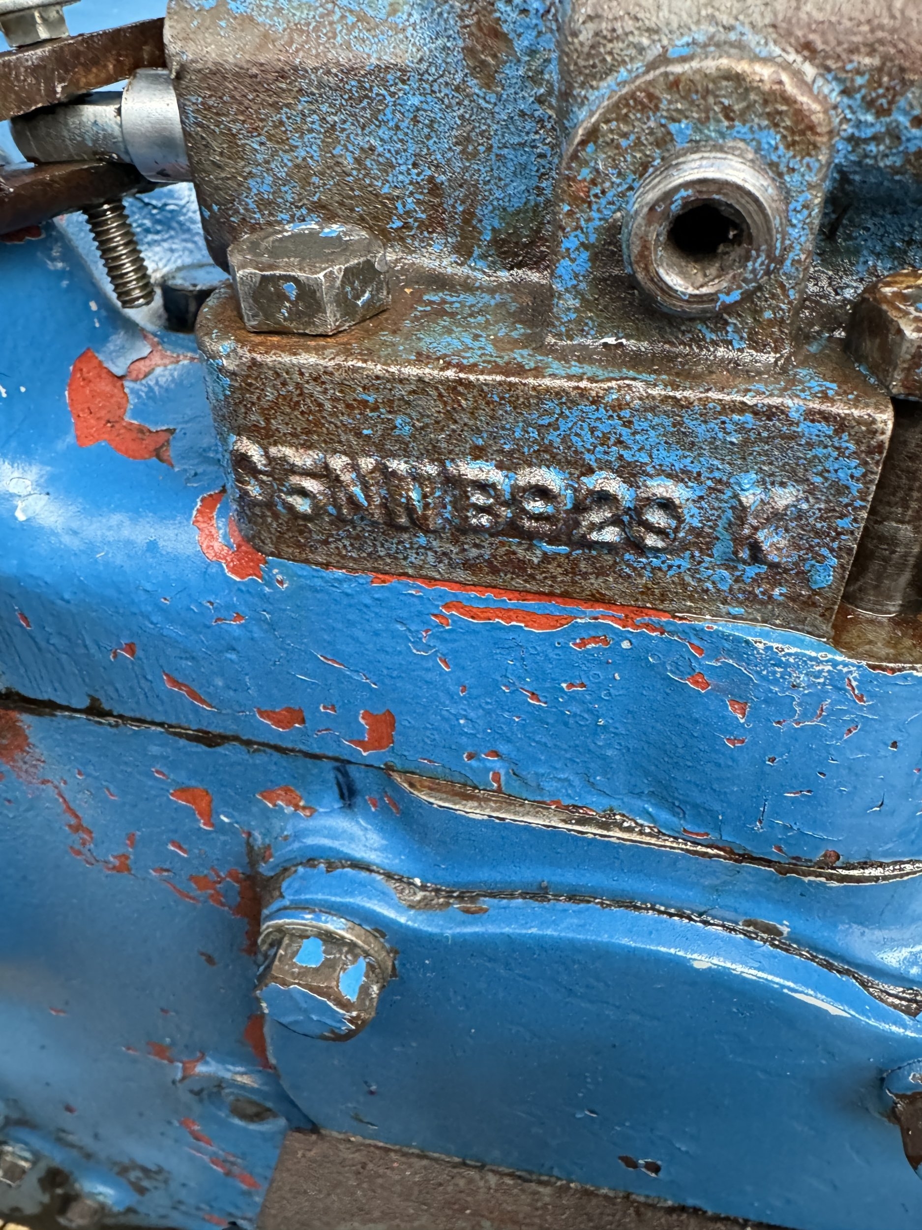

Under the seat is the remove valve control (I believe) which has two lines coming off it which supply fluid to the control valve for the FEL setup. I attached a pressure gauge to this and getting around 1000 psi only. The remote valve control unit has a casting number of C5NNB929. I replaced all of the o-rings on this when rebuilding the top lid. - The rings which meet the face of the top lid.
Is there any parts inside of the remote control valve (ie O-rings) which may have gone? I did see a video on YouTube for a later model Ford tractor which that fixed the low pressure.
Or is it likely I need to rebuild the hydraulic pump?
Any help would be appreciated..

I do not know for sure, but I think you should be seeing closer to 2,000 psi on your pressure test. This service manual is from 1964 and may not be 100% relevant, but I'll offer it in case it can provide some answers to you until someone more experienced can respond: https://www.ntractorclub.com/manuals/service-troubleshooting/Servicing Single and Double Spool Valves.pdf

Thanks Ed. Unfortunately my remote appears to be different. Had a good look at it today and not sure about it. I'm starting to lean towards the pump, however I think I forgot to replace the o-ring on the main check valve which goes in the front of the top lid.......Looks like I'd have to remove the whole lid again to get to it.....But not sure its related.

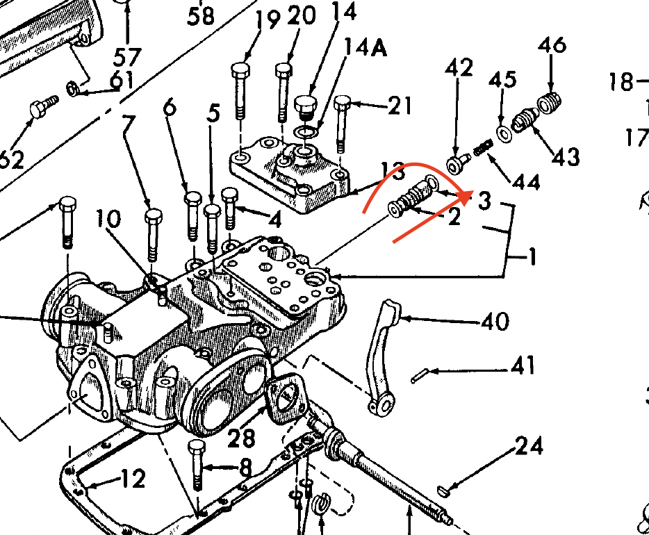

According to my information the pump should be giving you 2000 psi at 2000 rpm. lt recommends replacing the hydraulic relief valve and checking the flow control valve, for scoring, excessive clearance, ect., as causes for low pressure.
Hi John,
Certainly replaced with a new relief valve when I did the rear lid. In respect of the flow control valve - is this the one in the centre of the top lid?
