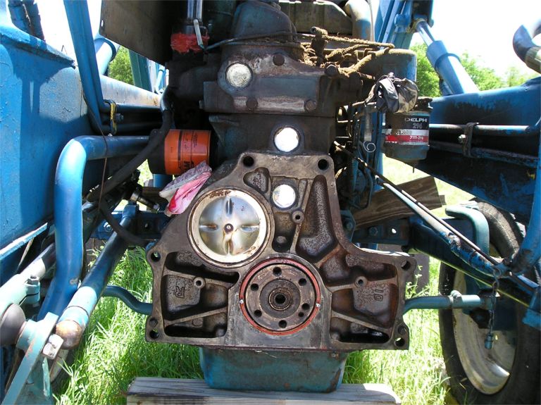

Just did the freeze plugs on my 73 3000 during a clutch job. If it's the two on the rear of block you'll have to split it. If it's the one on the back of head I suppose you can do it without a split but sure seems like it would be hard. I recommend you use permatex 2 as a sealer on the plugs. freeze plugs.JPG
   / Ford 3000 Coolant Leak - Bad News? #12
i agree.. a micro smear on the plugs and core hole is never a bad deal.. just don't overdo it..

Hey I was wondering if you ever found the source of the leak. I just found a leak in my ford 555, and am hoping it's not the lower rear freeze plug, but it looks like it might be. Coolant behind the starter like you. Will try a run or two of bars leaks 1109 first, hopefully that does it. Just looking to some good news
   / Ford 3000 Coolant Leak - Bad News? #14
uck! bars leaks is just good at plugging up narrow passageways.
if you have a core plug leaking.. bars leaks is NOT the answer!
   / Ford 3000 Coolant Leak - Bad News? #15
Yea I don't really want to separate the whole machine. Any suggestions?
   / Ford 3000 Coolant Leak - Bad News? #16
some times you have few choices.
   / Ford 3000 Coolant Leak - Bad News? #17
Well looks like I'll tackle the split then.
I've read through it in the service manual. Hope it's not a cracked block
   / Ford 3000 Coolant Leak - Bad News? #18
ps. if you find 1 core plug bad.. consider they are likely ALL the same age!
   / Ford 3000 Coolant Leak - Bad News? #19
Yep ill do all 3 on the back while it's split. Side freeze plug looks good.
   / Ford 3000 Coolant Leak - Bad News? #20
i'd do it too. :)
