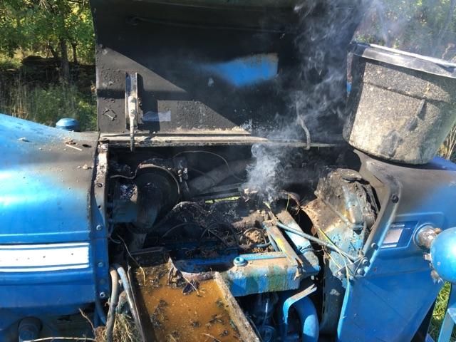

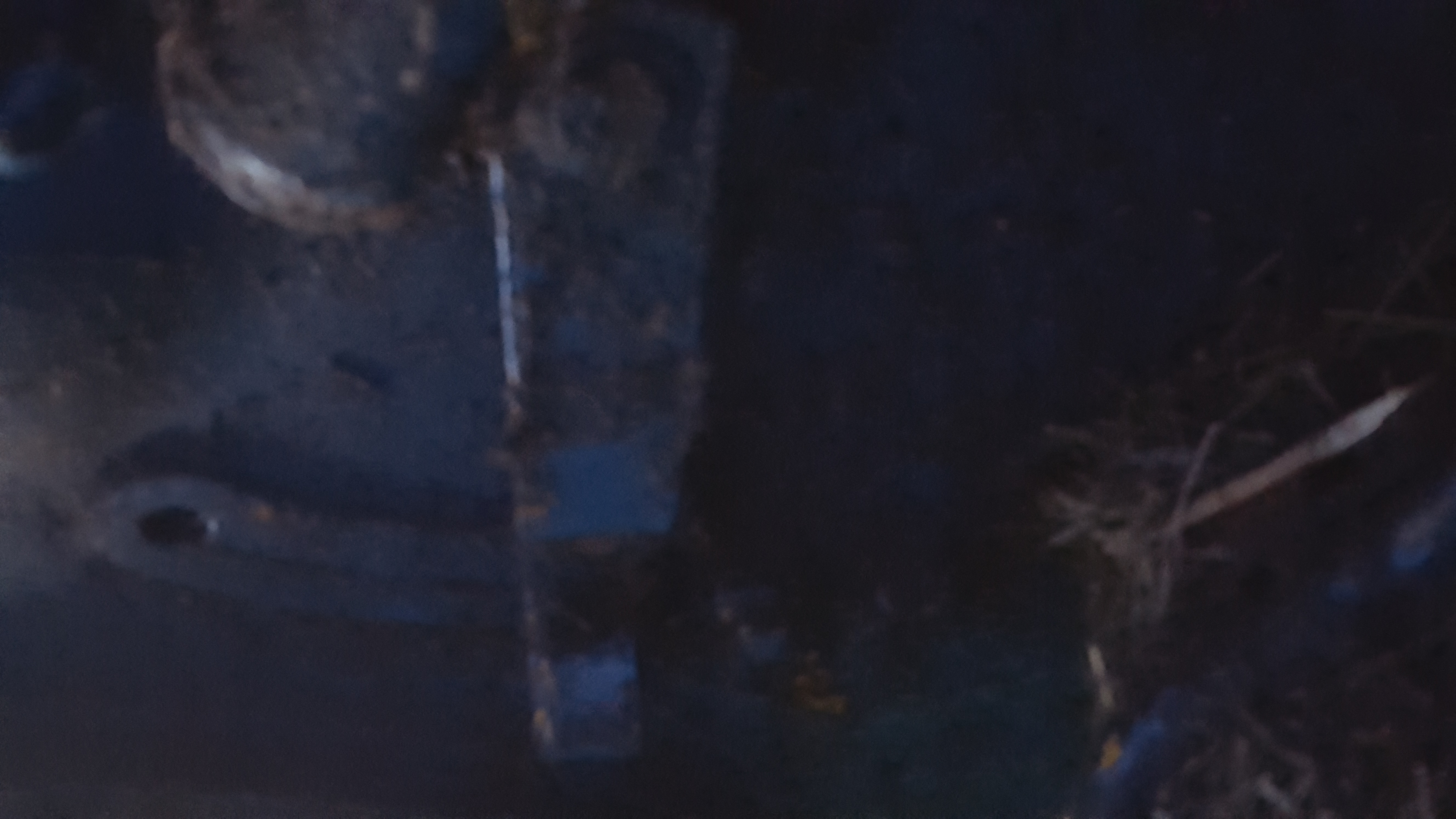

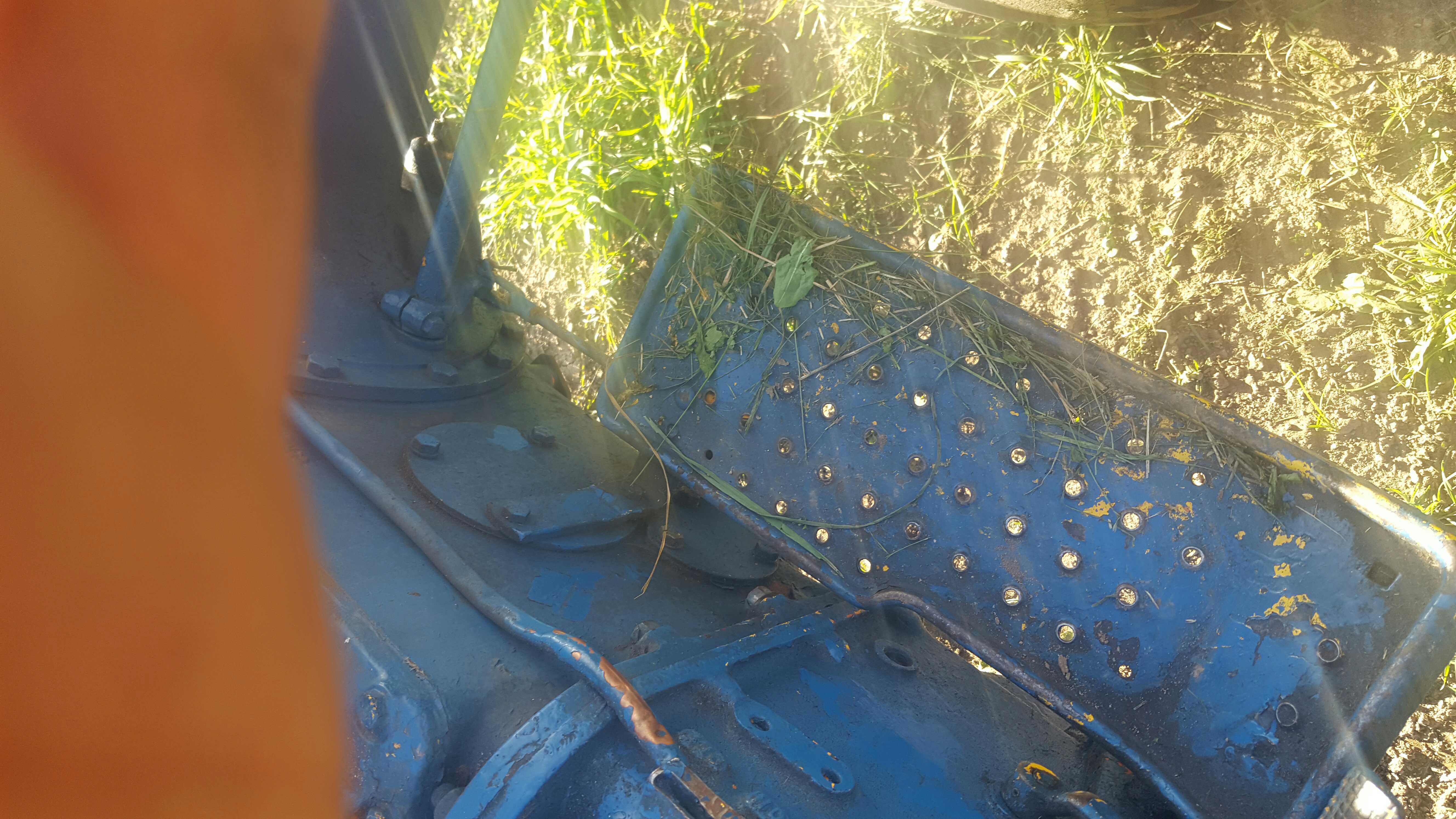

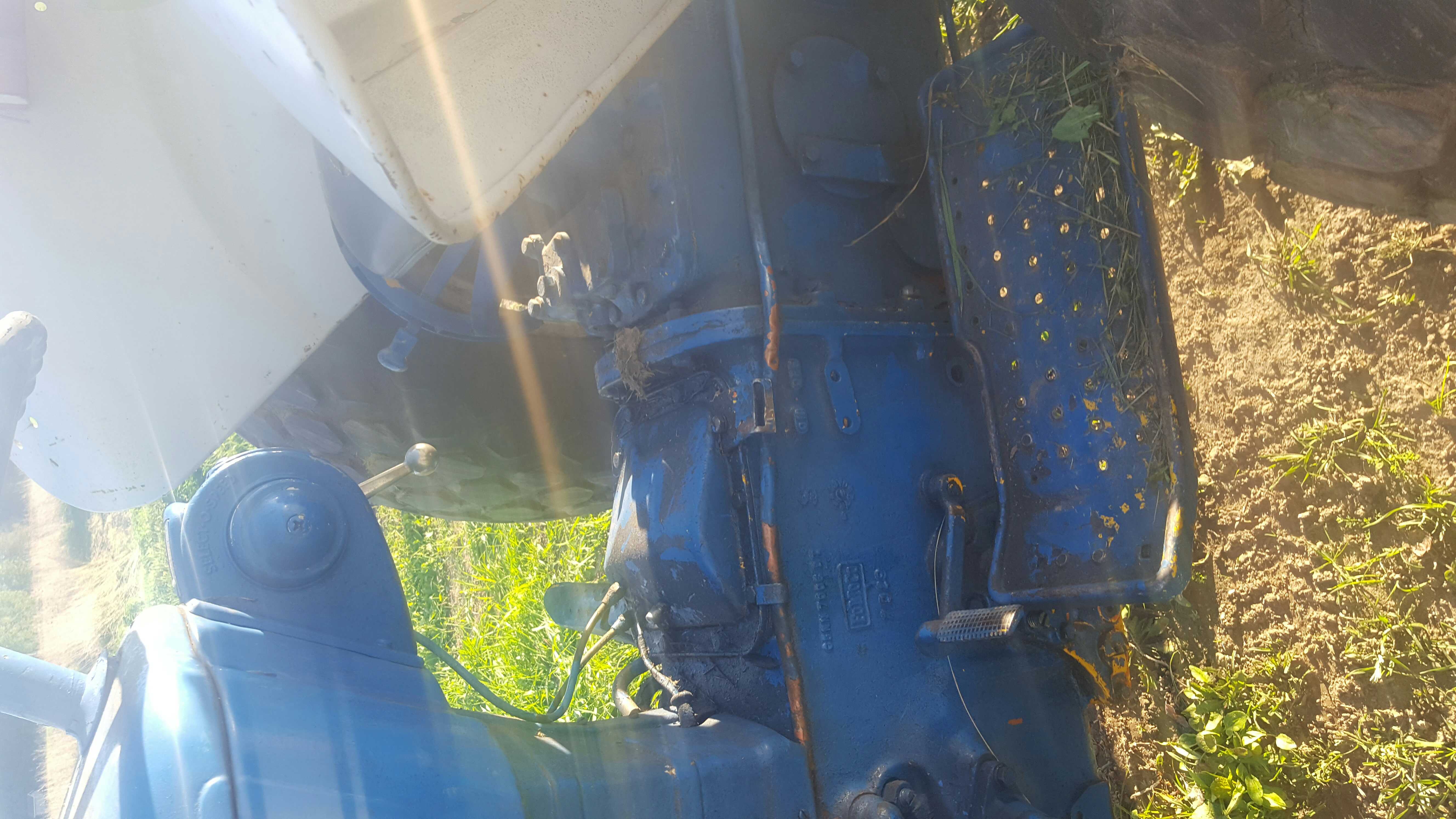

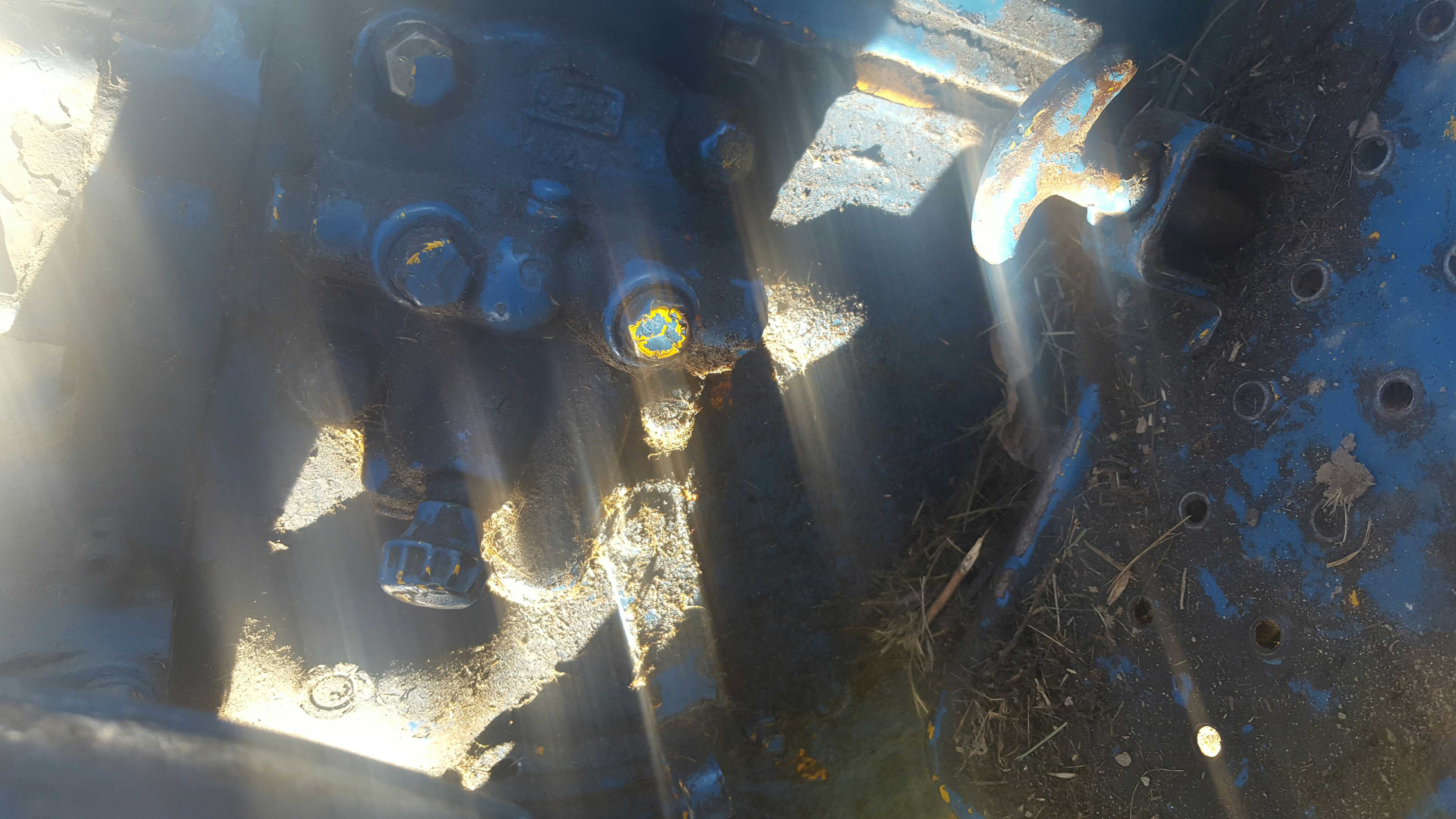

Posting this here instead of ford forum just for fast answers. Got a ford 3000 that I'm trying to find the differential lock. Renters just bought it this weekend and it caught fire but I need to tow it in the shop to work on it (getting paid) but even in neutral and clutch the rear tires are hopping and not disengaging.
Wondering if any of you guys know how to disengage it or at least where the lever is. And tractor is out of service so i can't play with it to try and disengage.
Attached a few pics of the tractor and the levers 1476136697946.jpg1476136710814.jpg1476136725894.jpg1476136740044.jpg1476136755764.jpg

That is a SOS granny, a powershift trans. The trans and diff are locked down unless running.
There is a traction disconnect that slips the pinion coupler off to let the rear end free wheel when you tow it. Back on the diffy inspection cover is a short strap/lever held with a bolt. Flip it.
Sorry about the darkness. Battery too dead. Should have said but it's a select o speed tranny
/ Ford 3000 differential lock
That lever must been it. Moved it into other position and it rolled easy

Soundguy. Is this what your talking about?? View attachment 484183
Sorry, but that picture doesn't show me anything...
the disconnect is on the differential inspection port. not on the transmission. if that's what's in the pic, you are good. I vew the forum on a phone.. so that picture is dark and 2" x 3" :)

Yeah, one of his pics removed all doubt concerning transmission type. :)
/ Ford 3000 differential lock #12
2 really.
the one with the cowl shifter was the smoking gun. the previous pic that showed the domed tranny top cover edge was good enough though.

New battery blew up. My best guess for cause is that the voltage regulator over charged it.

Thanks a bunch sound guy. I will get a better picture of the lever that disconnected the transmission
/ Ford 3000 differential lock #17
no need, You've already found it.
I just couldn't see the pic well enough to tell you if that was the lever or not. if you threw the lever and it rolled.. that's it. :)
