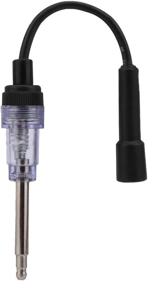

   / Ford 3000 Gas #18
Coil was changed already
How about a tester?
When I was working on my father's 4400 it was acting similar. My brother produced one of the above and we had it running in no time. I don't recall what we changed but believe it was the coil. Ours was old, but they do have bad units from the factory.
At any rate for ten bucks you might spend a lot less time scratching your head.

   / Ford 3000 Gas #20
How about a tester? View attachment 801153
thank you
