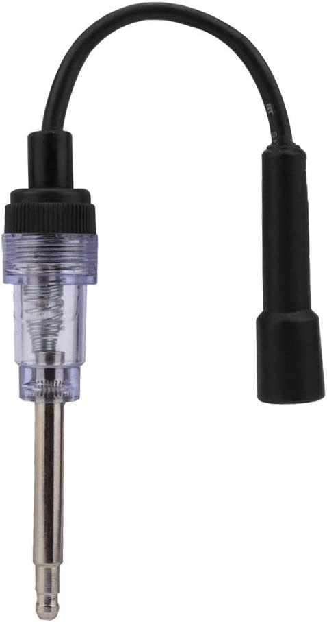

How about a tester? View attachment 801153
When I was working on my father's 4400 it was acting similar. My brother produced one of the above and we had it running in no time. I don't recall what we changed but believe it was the coil. Ours was old, but they do have bad units from the factory.
At any rate for ten bucks you might spend a lot less time scratching your head.
I bought a tester about a week ago. I plan on trying it as soon as I get a minute.
