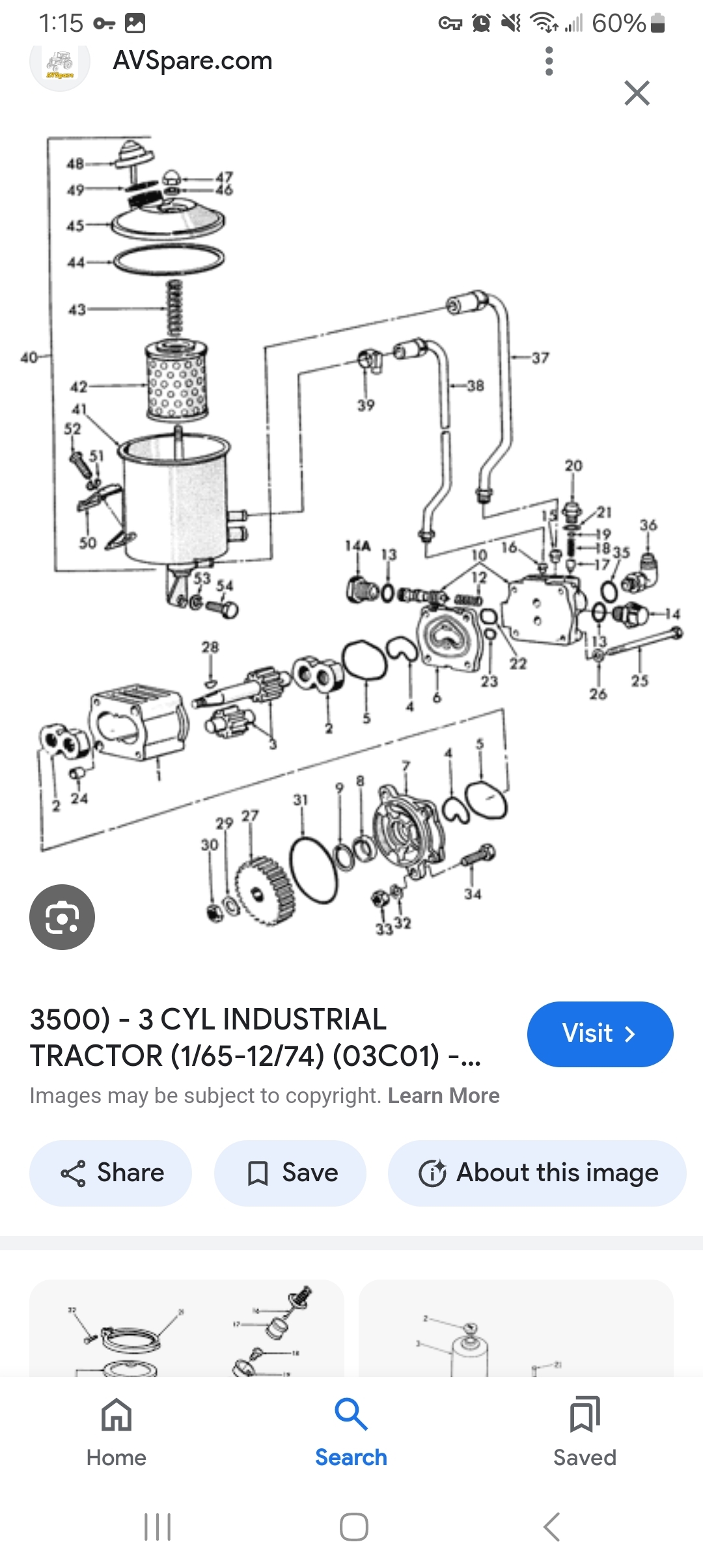

Thanks I found it the seal kit for the pump, also I'm needing seals #s 44, 46,& 49 for the reservoir (i attached a diagram) do you happen to know the part #s or where they could be found?

Ya what is the directions of flow? In/out on which lines? & does the fluid flow Into the center of the filter & out the side or vise versa? I have found a very inexpensive oil cartridge filter I can easily modify & make work it fits good but fluid still looked like it was coming out of the top around the stud that mounts the filter & resivour cap together
/ Ford 3000 power steering fluid bubbling foaming #18
The flow goes to the pump from the bottom of the reservoir, so from the outside of the filter to the inside.
