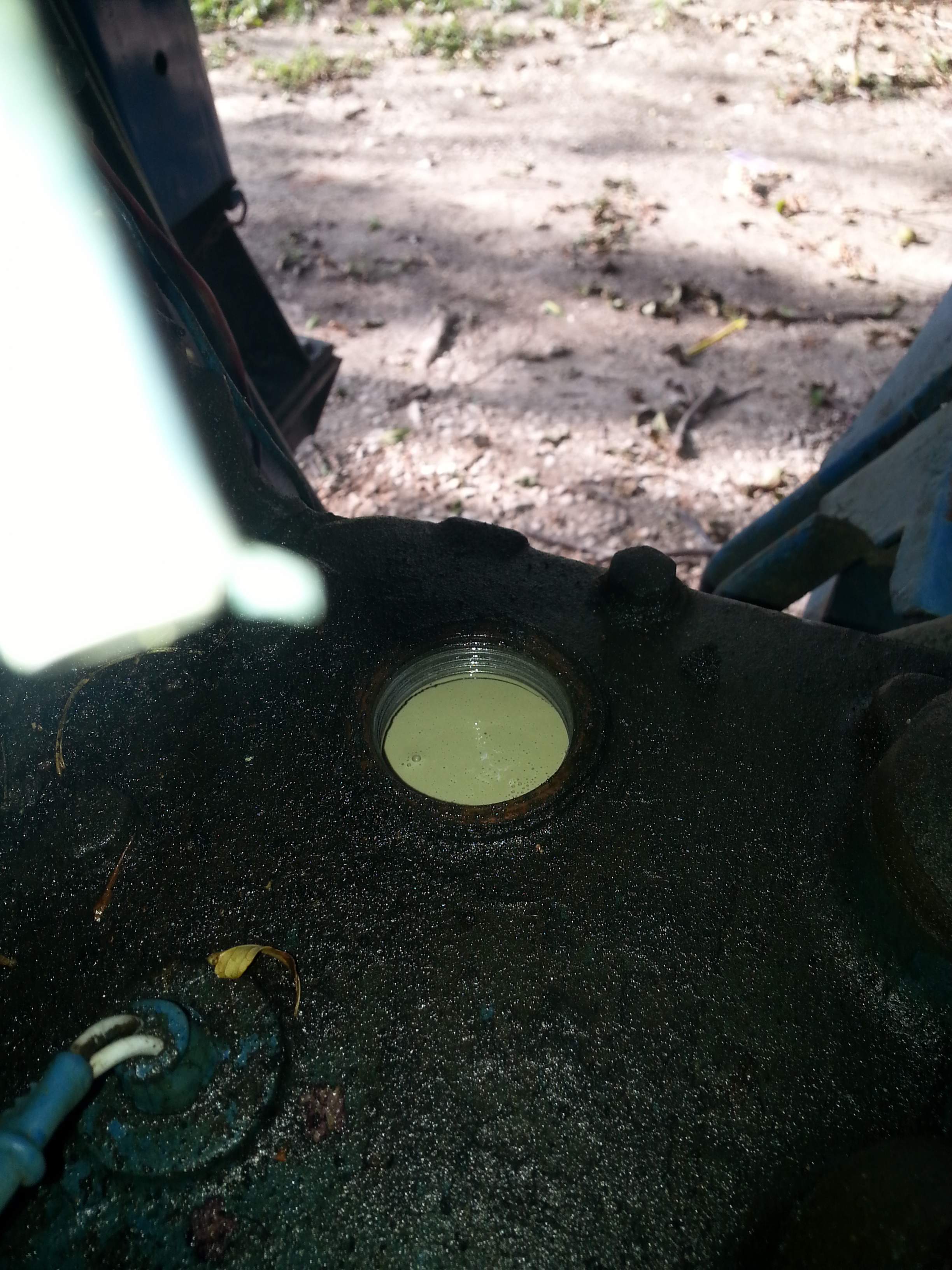

Ultra, Yes I know i need to bathe the poor girl (her name is Blue BTW), been on my list of to do's! I know where it is leaking by the clean spots!There is no question it is leaking from that cover, only one flat head screw holding the plate on... It is more of a gushing flow than a leak. Seriously here is a vid of the leak in action No joy on the vid.... This is getting odd now, I popped open the fill cap bolt on the tranny, and it is almost to the top of the transmission now. It is 2 inches higher than it was this morning, no one has added anything. can old UTF expand like crazy? maybe has water in it? I smelled it again, and I am sure it is UTF, smells "sweeter" than diesel, also oily feeling.
Oddly enough I drove it just a minute ago and the clutch is acting fine, no slippage. See vid and pic. Ooh never mind cant post mp4s from my phone...

You have water in the oil. The transmission case and rear axle are normally separated. I think you have got water mixed fluid in the rear axle that somehow is getting into the transmission.
How is the level in the rear axle?
Do you have a separate pump for extra hydraulics?
Have you been connecting any extra hydraulics that could have been adding fluid?
Have you been connecting any extra hydraulics that has there own valves, maybe borrowed equipment?

The poor girl was left out in the rain last week though. I will go check level in back axle. Think it would be prudent to drain it and start over? What are the odds the seals are ok and it is just blow by from too much fluid and water?

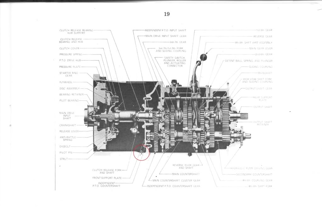

I have looked at the video, on a proper screen now. I was wrong about a leak that made diesel running behind the starter and down. Now it looks as diesel is coming pass the inspection cover, or from above it? If the fluid was water, then a leaking freeze plug could be the answer, but diesel? I have no idea.
How is the water level in the radiator?
Water in the rear axle is mainly from humid air condensing on the inner surface of the rear axle housing. Extra hydraulics may add water to the rear axle as well.
You have two shafts going out of the transmission case into the rear axle, both sealed.
Here is a picture, the red circle indicates the draining hole in the belly, it usuallly has a cotter pin to keep it cleared:
