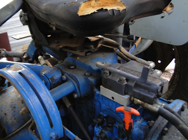

This is the remote valve that is leaking. There are two hoses coming into the aluminum block (the manifold). Then there are two hoses leaving the valve to the two remote connections above the 3PH.

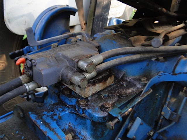

This is the other side of the remote valve; here you can see the two hoses leaving the actual valve to the remote connections above the 3PH.

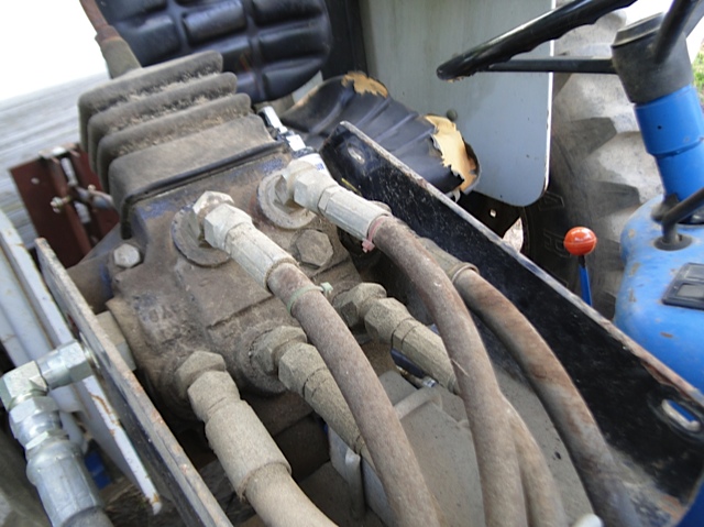

This is the FEL valve for reference. There is a hydraulic hose that enters the rear end of the tractor, you can see it in the first picture I posted in this message. I think this comes from the FEL valve, but I'm going to go out and double check that now.

Ok here's the plumbing diagram after scraping some grease off to figure out which hoses go where. Part of my confusion is that I assumed the plumbing started at the FEL valve, then went to this manifold/remote valve... Obviously not, everything starts with this manifold, then the remote valve, then the FEL valve.
Starting at the manifold (1st picture in my last reply):
Two hoses leave the manifold. Looking at the picture above: the hose on the left, (which is the right side of the tractor from a driver's point of view), goes to the BYD plug on the FEL valve.
The second hose on the manifold goes to the IN plug on the FEL valve.
The two hose coming out of the remote valve go to the two remote connections above the 3PH.
Then from the FEL valve there are seven hoses:
Four go to the FEL.
The IN and BYD come from the manifold.
The OUT goes to the sump return.
Is this correctly plumbed? Not sure from your diagram ETpilot...

It all sounds correct to me, providing the two hoses between the aluminum block and the in and byd ports of the loader valve are correct. The flow from the block should go to the in port of the loader valve. If that's the case, your plumbing should be right, and the leak comes back to the fit of the orings under the remote valve.
