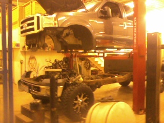

If the 6.0 has not been bullet proofed it's a time bomb.
   / Ford 6.0 diesel; the good, the bad, the ugly? #10
Sorry hit wrong key. You would be much better served with a 7.3 . Bulletprofing a 6.0 will run you 5 -7 g 's and its still no garrentee . Bullet proofing consist of EGR delete and oil cooler relocation . Problem with 6.0's is the EGR gets clogged which overheats oil cooler which overheats engine . The 6,0 has only 6 head bolts per cylinder and that with over heating leads to warped heads leaky head gaskets . Lots of people buy 6.0 cause you can get them cheap and they do produce more hp than a 7.3 But it's gona cost u . You can get a nicer newer truck with a 6.0 [ king ranch or Harley davadison edidition ] but with a time bomb for a engine what good is it.:drink:
