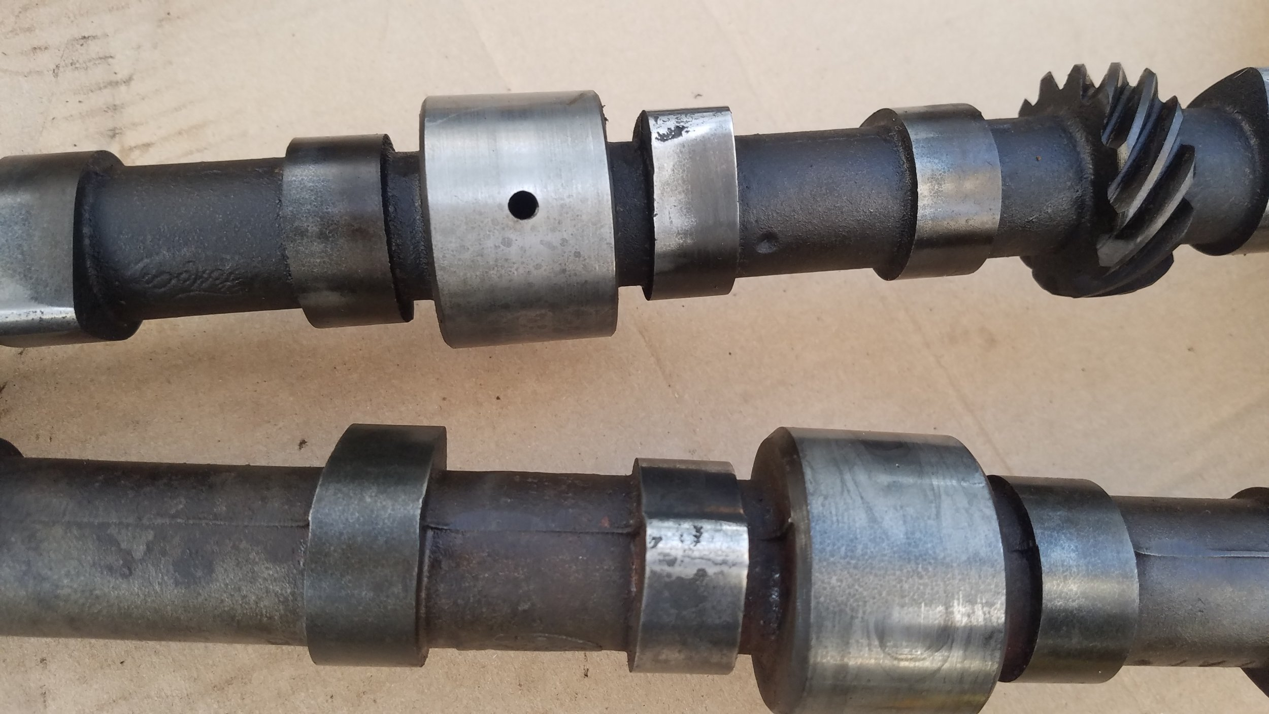

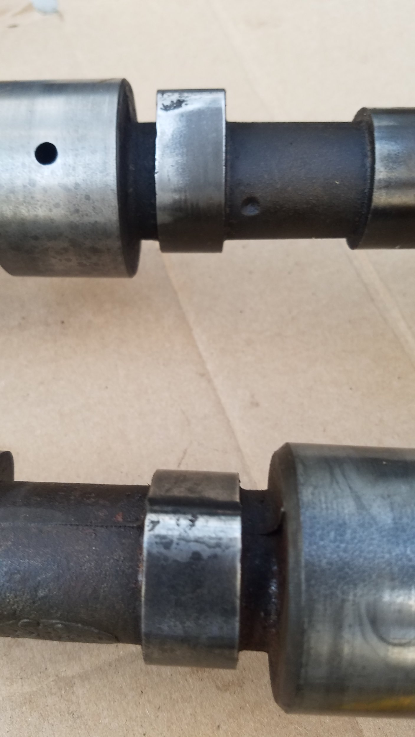

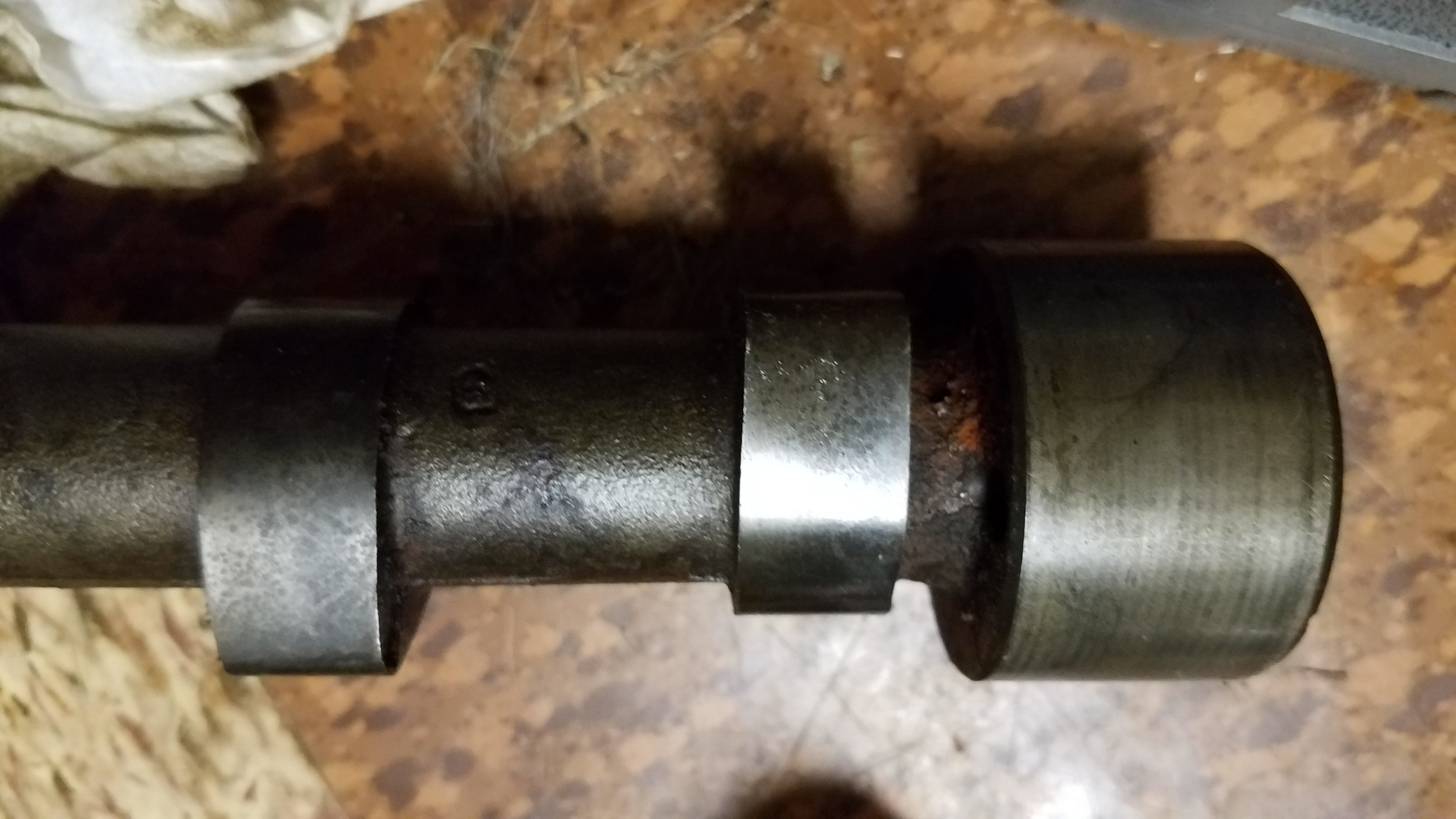

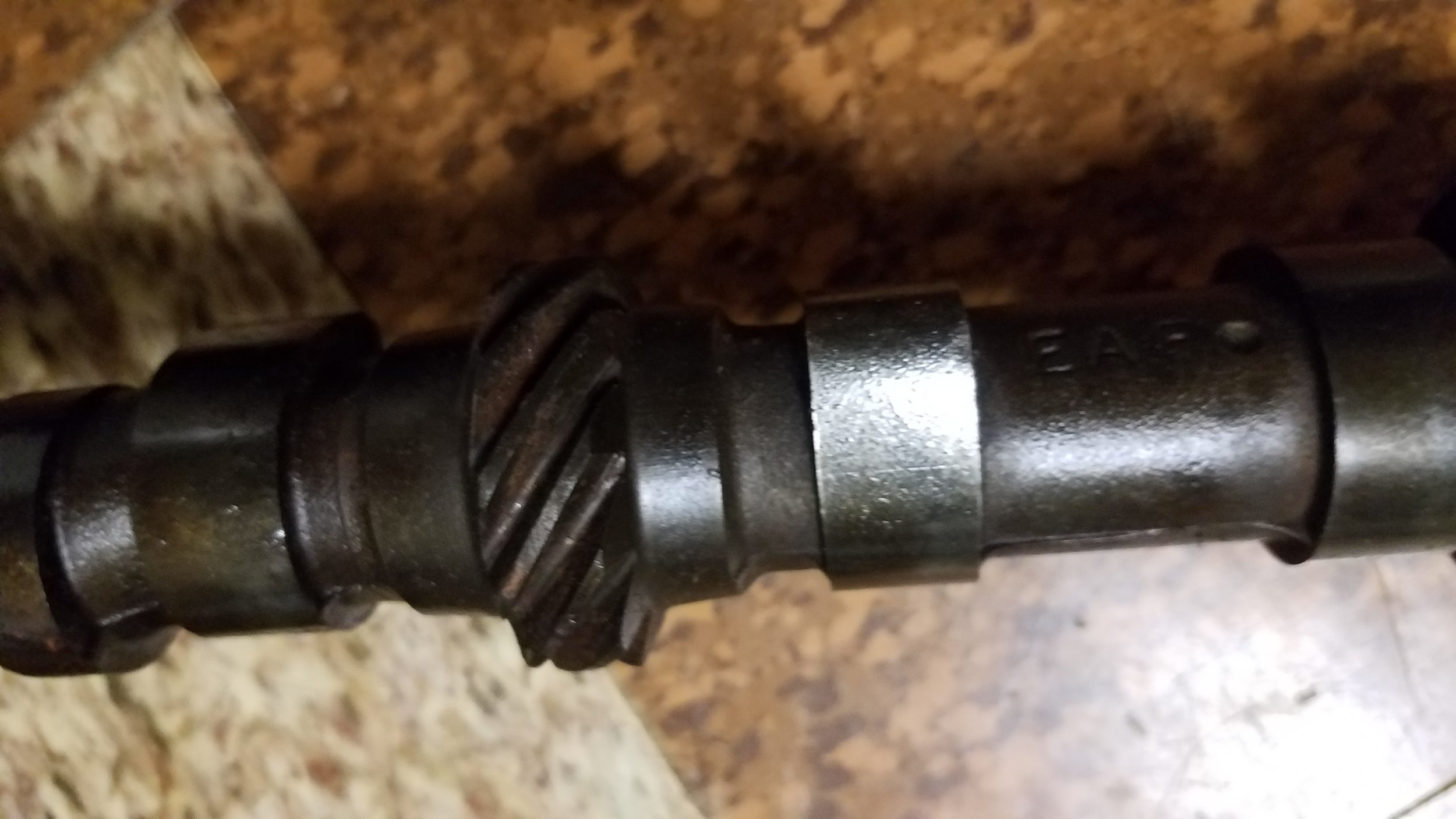

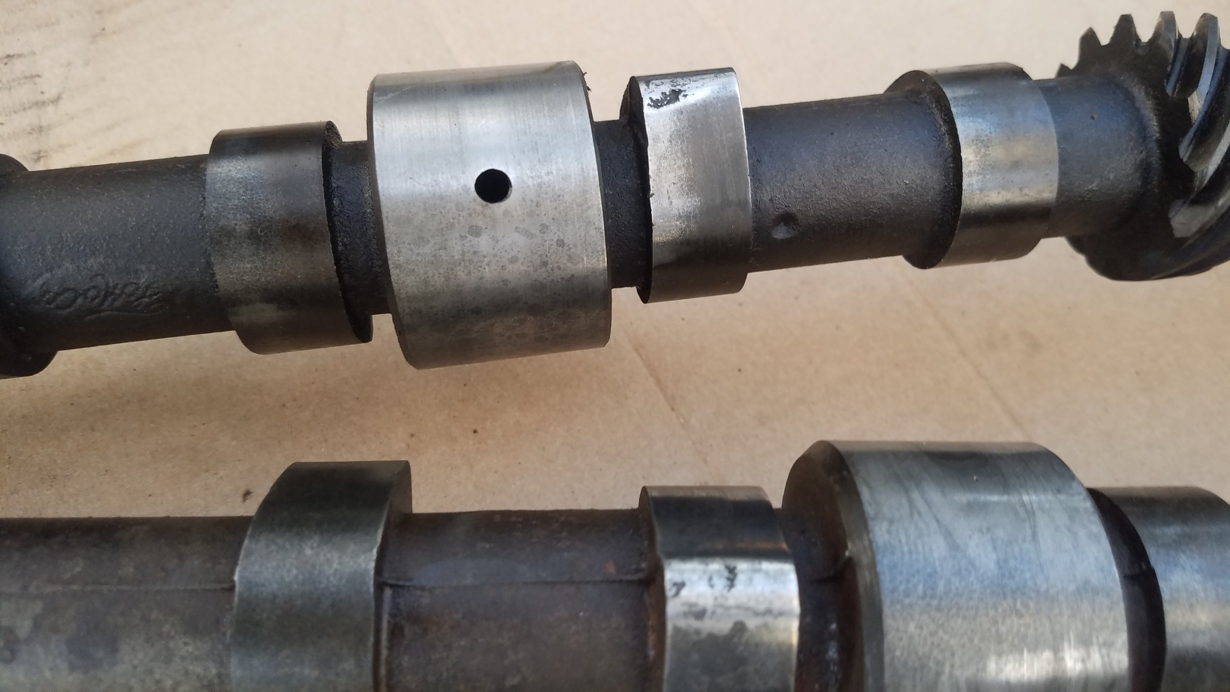

Today I was able to get both cams out in the sun to closely compare lobes
The bottom cam in the pics is the original and the top cam is the used cam I had bought awhile back.
I didnt get to clean either one much due to rain. I was hoping it would turn out nice, but pics show the spots on these lobes on .
It was hard to get the camera to focus tightly to show spots..
These are the worst spots, other lobes look pretty normal on both cams.
The journals on the top "used" cam are a little over 1/2 thousandth larger than journals on the original cam, so it would've fit a little tighter in the block journals. I priced a couple new cams, looks like they would be about $150-$175.
Could either of these be ground or is it just time to look at new cam?
Thanks

   / Ford 800 172 engine sleeves--Overbore or Std 3.9? #18
My guess would be that a quality shop could build up the defects and re-grind the cam but for the cost of that it may be just as cost effective to purchase new. I for sure would not use that cam the way it is.
