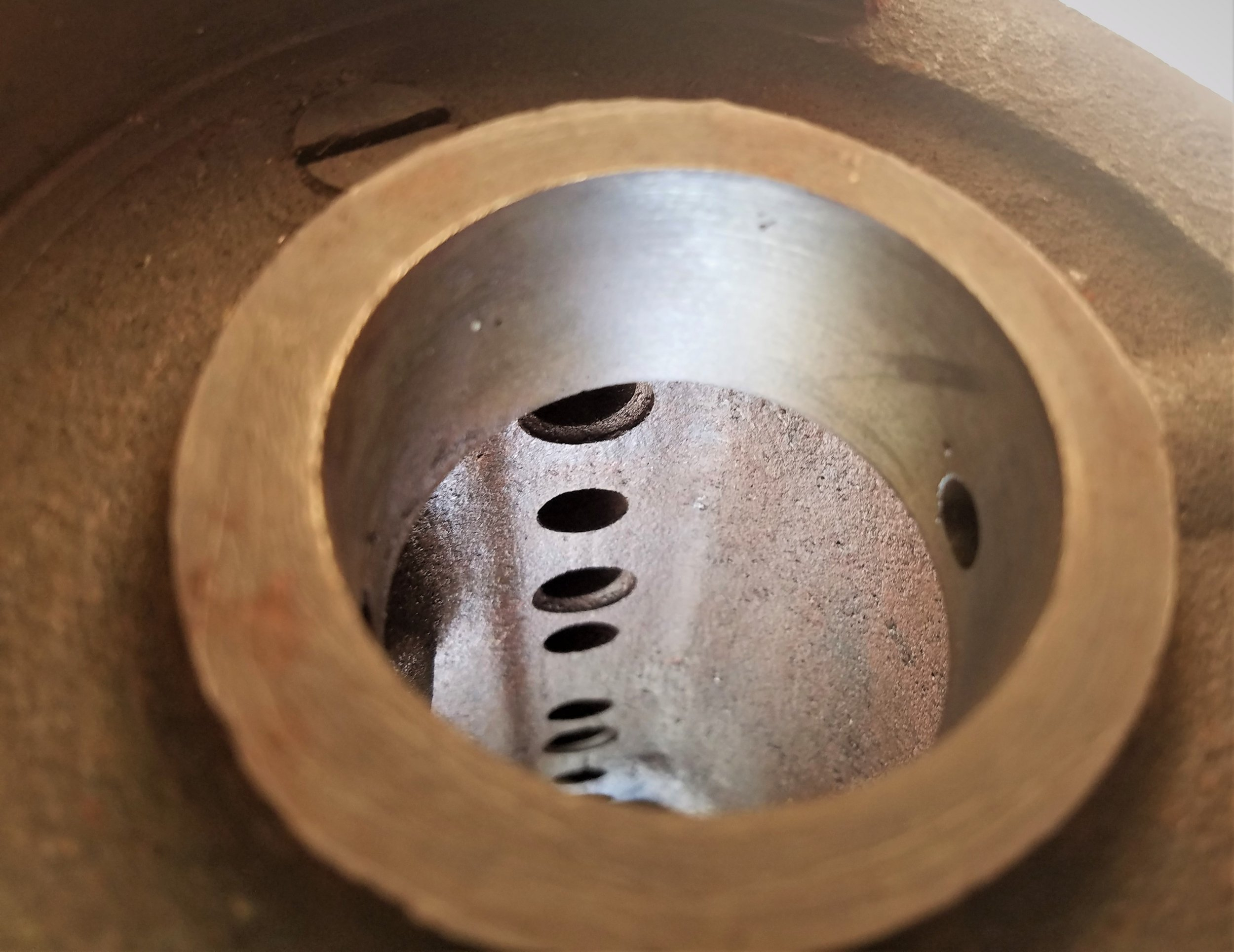

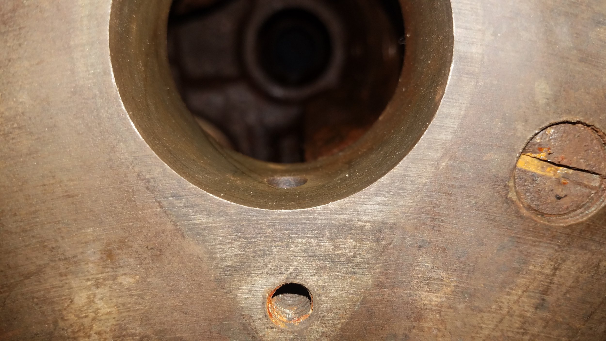

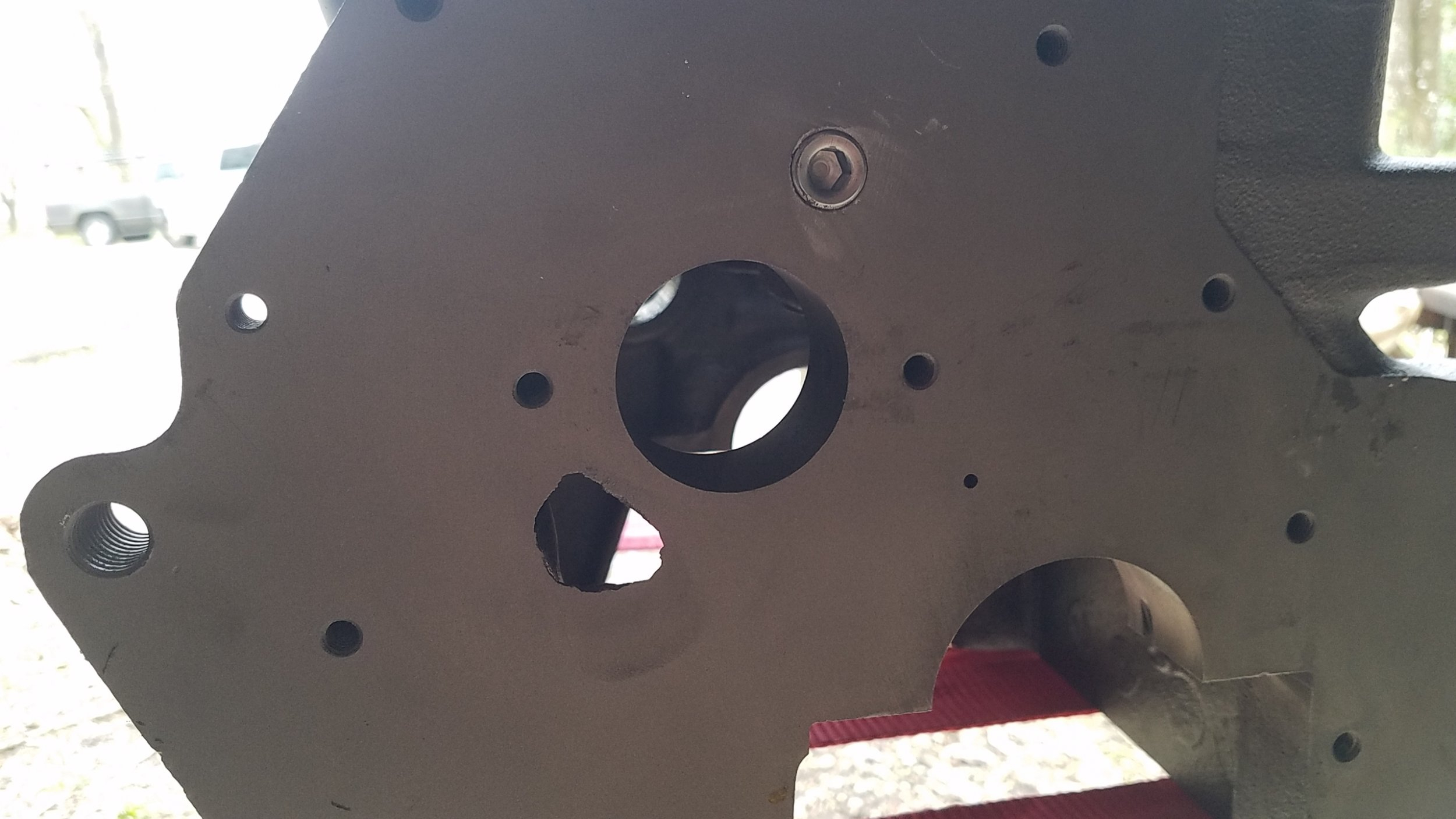

Well, its hard to believe that it is now March and I just got my engine block & head from the shop! Now Hopefully I can get it put back together.
I dropped it off in back in early January, since I needed to have the flywheel machined, I figured I would get the block and head chemical cleaned for the flood/rust and have them install new valve guides and grind valve seats. Originally they said 1-2wks but then more manpower issues and parts issues...
I noticed when I picked it up that they had replaced the oil galley plugs on the front and rear of the engine block near the camshaft.
Here's some pics of original slotted plugs and the new socket head plugs.
I dont have a closeup pic of the rear plug--Should these just be regular plugs or did either of these have an orifice hole for oiling gears?
There is an oil hole in the block near front crank/camshaft gears but I dont see this hole near the rear gear, only a drain hole in the bottom of the gear cavity
I was wondering how the hydraulic pump drive gears on rear of camshaft are getting lubrication?
Thanks!

   / Ford 800 172 engine sleeves--Overbore or Std 3.9? #24
They should be plugs, no orifice, the pump gear lubrication is from what comes pass the cam and its bore in the block. Like you I would have thought they would have put a small orifice to provide lubrication for that gear and one in the front for the governor.

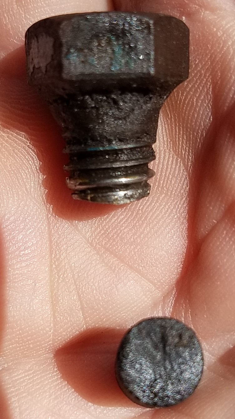

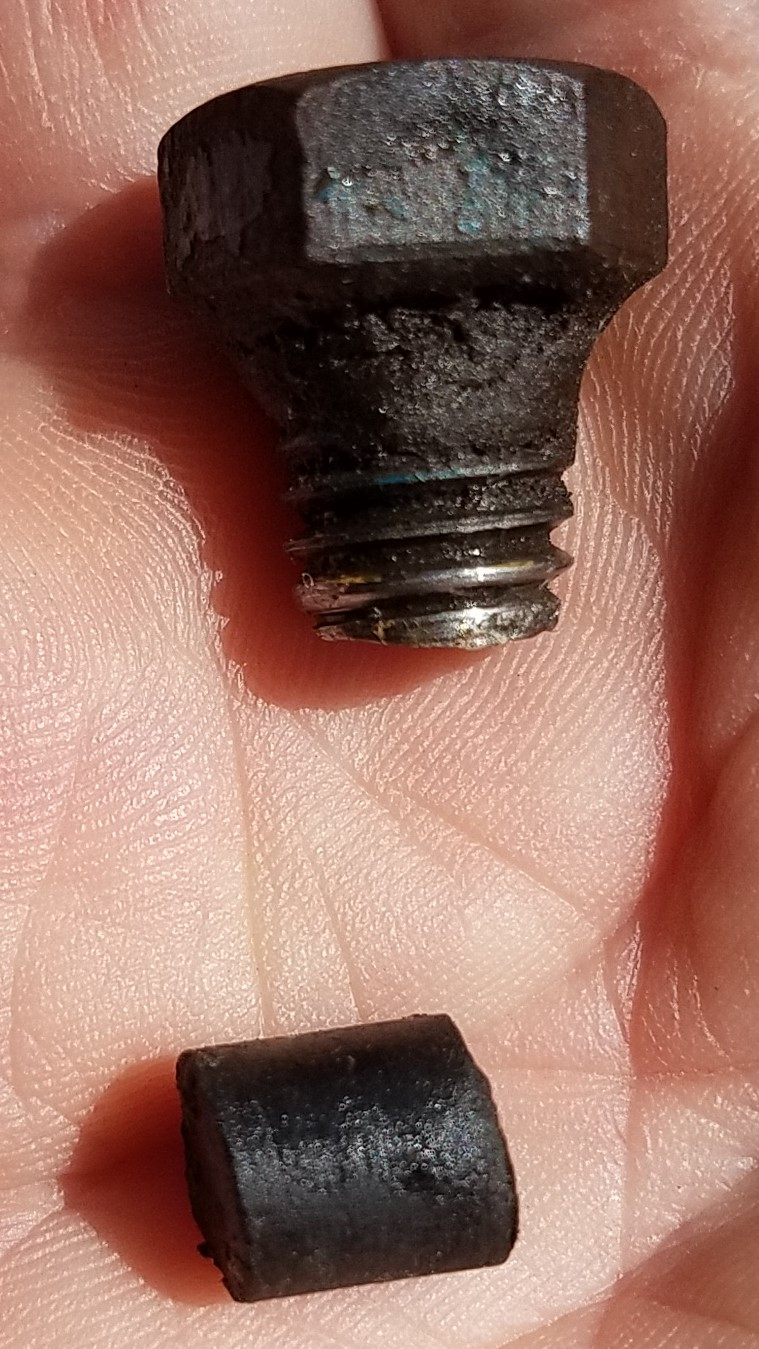

Completed the plastigage check on the mains, all 3 bearings were very slightly under .003".
While cleaning oil passages, I noticed that in the 3 cam bearing bores (where the drilled passages go to the exterior side of block), the front and rear bores are missing the little rubber seals inside the holes.
I've seen mention of these missing on several tractor forums but usually their discussion was about external oil leaks.
My exterior metal plugs are in place and I did not had any external leaks around these prior to teardown. The center cam bearing bore still had the rubber seal in place behind the exterior bolt.
Since that middle bearing seal was sitting flush with the inside of the cam bearing bore, I was wondering whether these seals are also meant to prevent these extra oil cavities from adversely affecting oil circulation to the cam.
The book shows part no's EAA66025A (plug) and EAF66045A (seal). From checking prices on these, they seem to be very proud of these!o_O
Thanks again for the rope seal info!
