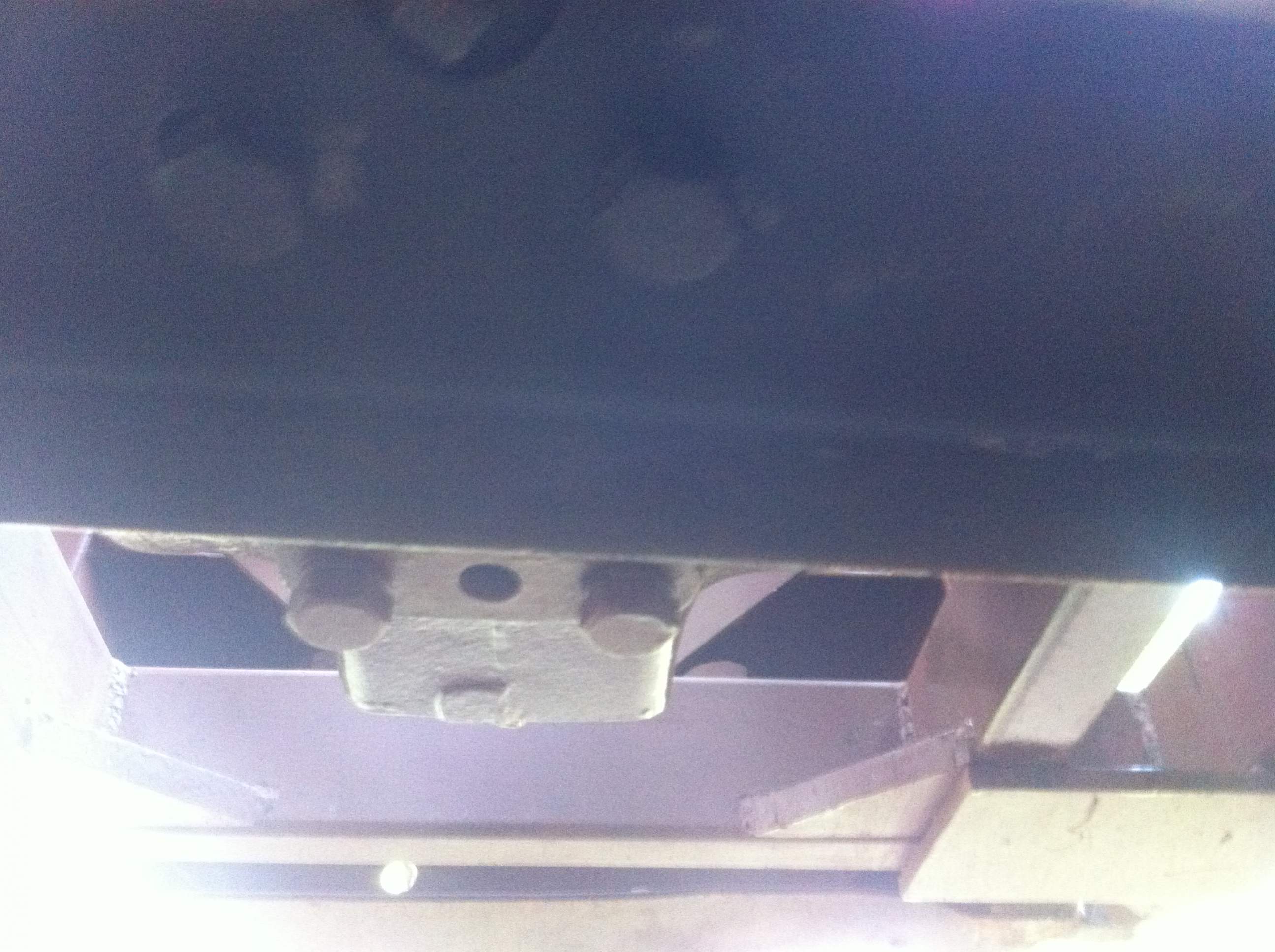

This is a great project. I am impressed with your fabrication skills. I was looking back through some of your pics this morning and saw something that concerned me a little. Where the fender used to sit, you have 2 bolts on each side going through the axle to hold the backhoe sub-frame. This needs to be reinforced so the bolts won't break off the ears of the hole. You need a steel plate on top of the axle for extra support. Most of them that I have seen are about 1/2in thick, about 4in wide, and long enough to reach both bolts. That axle housing is cast iron and will break. I have seen these break before with only a loader attached. Remember, these 4 bolts are supporting everything on the back of the tractor. This is a really easy fix and will save you a headache down the road.

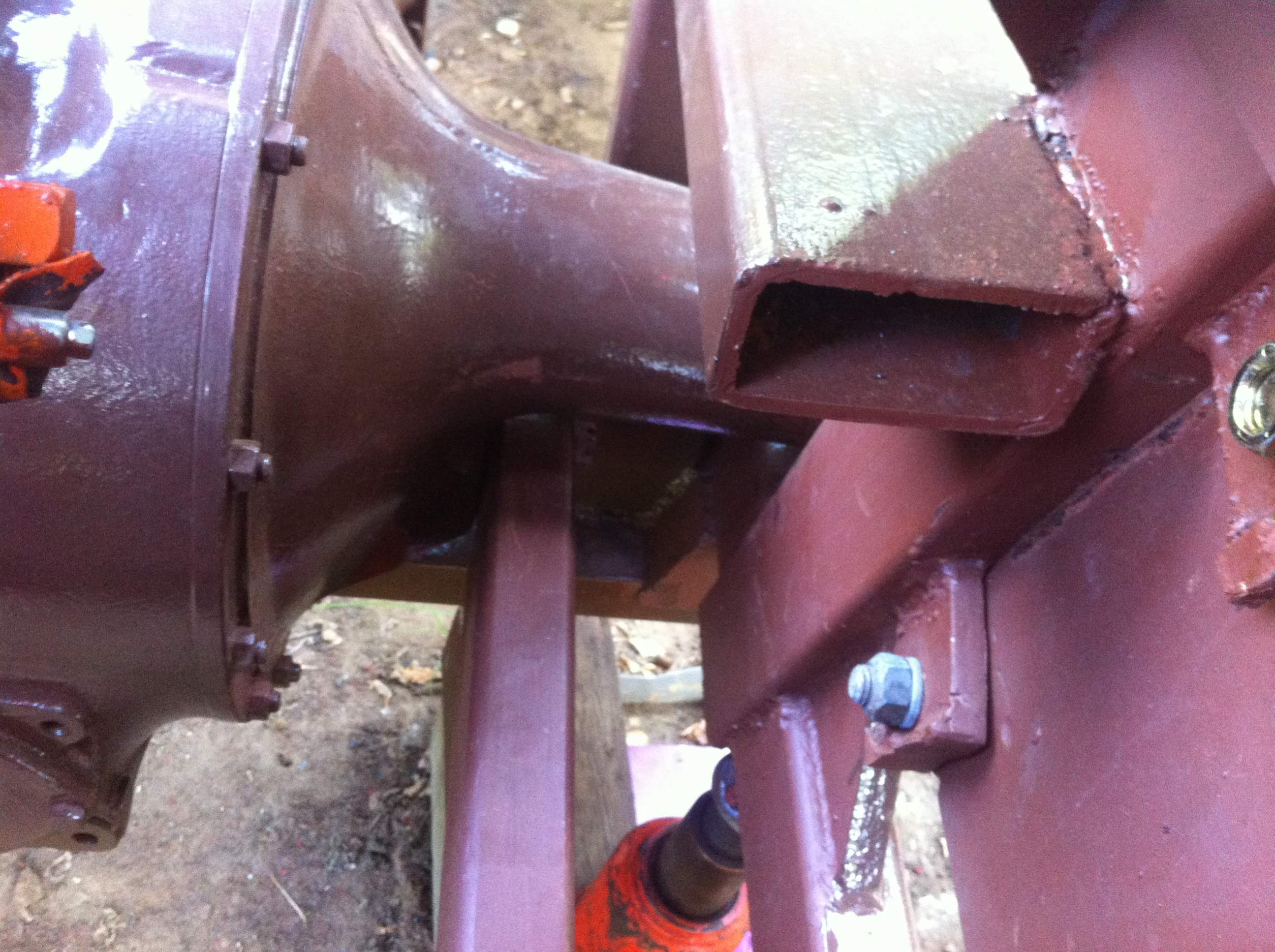

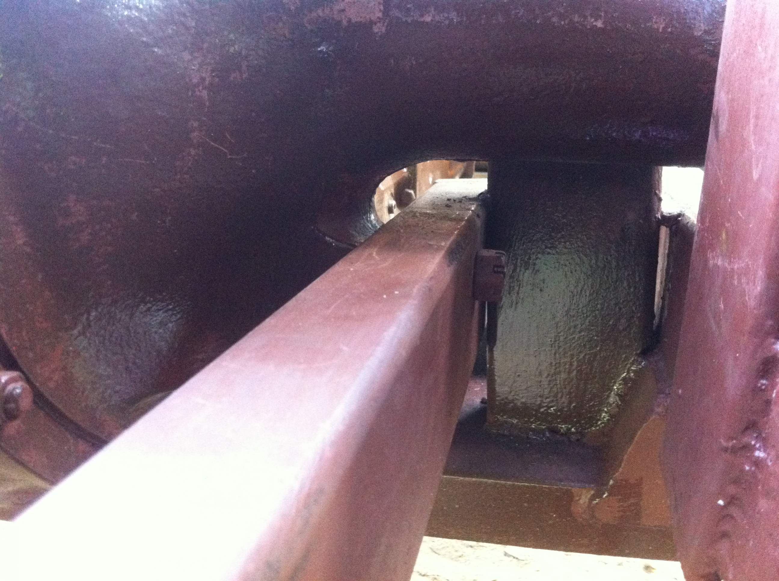

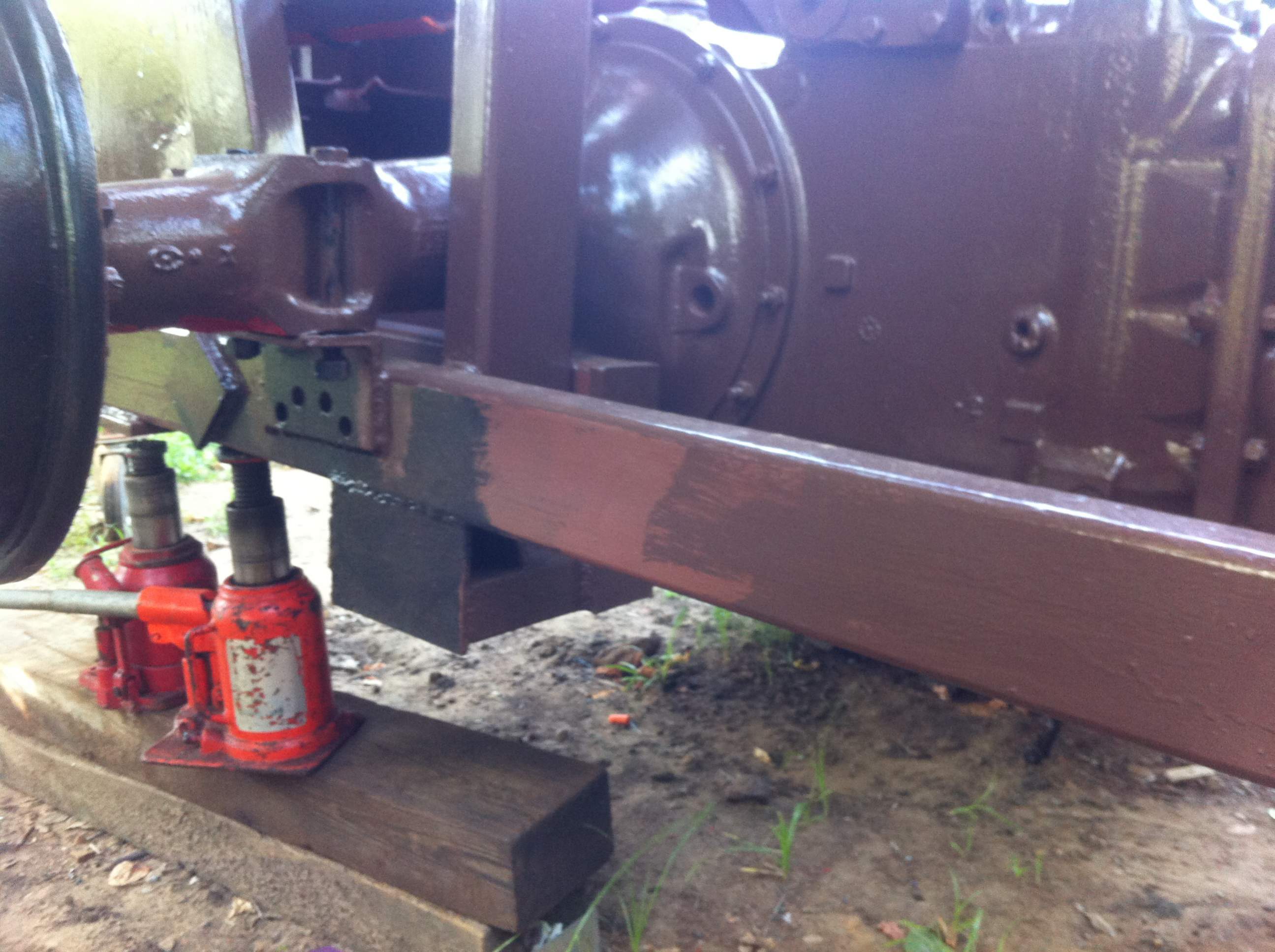

It痴 kind of deceiving from the pictures I致e posted, but the fender brackets aren稚 actually carrying the lion痴 share of the load, although it appears that way. Instead of the weight hanging down from the fender brackets, I thought the first point of support should be under the rear housing (and the bell-housing further up the tractor). So, bolted into the rear housing is the initial port/starboard brace. June 24, 2013 tractor backhoe 003.jpgJune 24, 2013 tractor backhoe 004.jpgJune 24, 2013 tractor backhoe 005.jpg

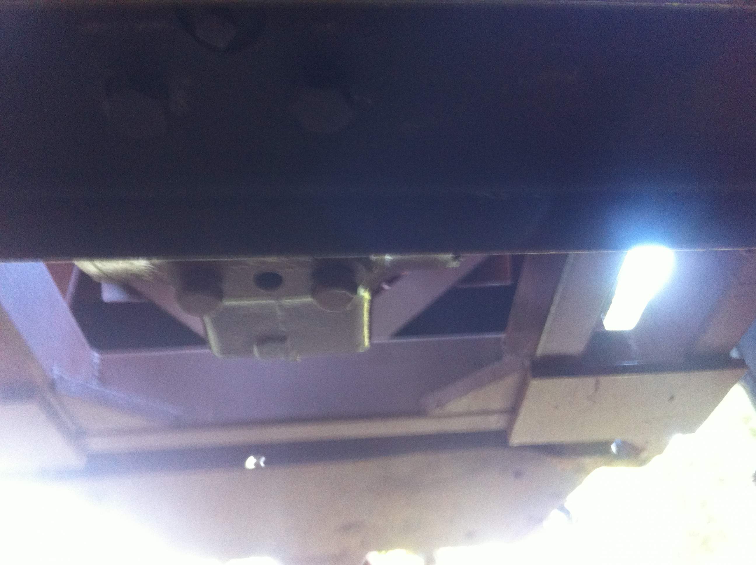

My next step was to figure out the beefiest parts of the casting to take the majority of the BH weight. This is when it occurred to me that the lower link supports were designed just for that purpose! I致e seen some heavy implements raised with those supports, so that became the second two stress points.
Then, yes the fender brackets were incorporated into the outer line of the sub-frame, but I made every effort to have the brackets supported from the center out, instead of vice-versa. June 24, 2013 tractor backhoe 001.jpg

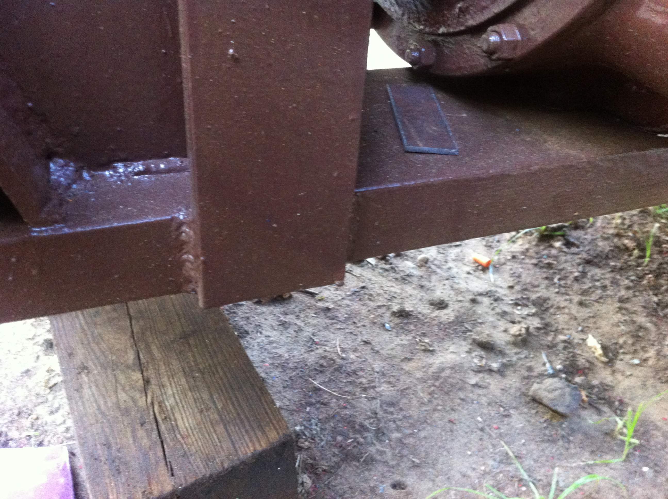

But, I do agree the axle benefits from further reduction in stress points. I tried to make this work both as a step & box in the axle. I haven稚 covered any of the sub-frame with the diamond plate yet, but it will be bolted across the width of the axle. (I think it needs to be shimmed セ of an inch to compensate SoundGuy probably knows).June 24, 2013 tractor backhoe 007.jpgJune 24, 2013 tractor backhoe 008.jpg
As crazy as it looks, the frame can be removed completely from the tractor but I hope I never need to do so. I have looked at the drawings of the Ford sub-frames & tried to pull as much from them as possible, but please anything that looks wrong or fixing let me know. I would prefer over-kill if anything!

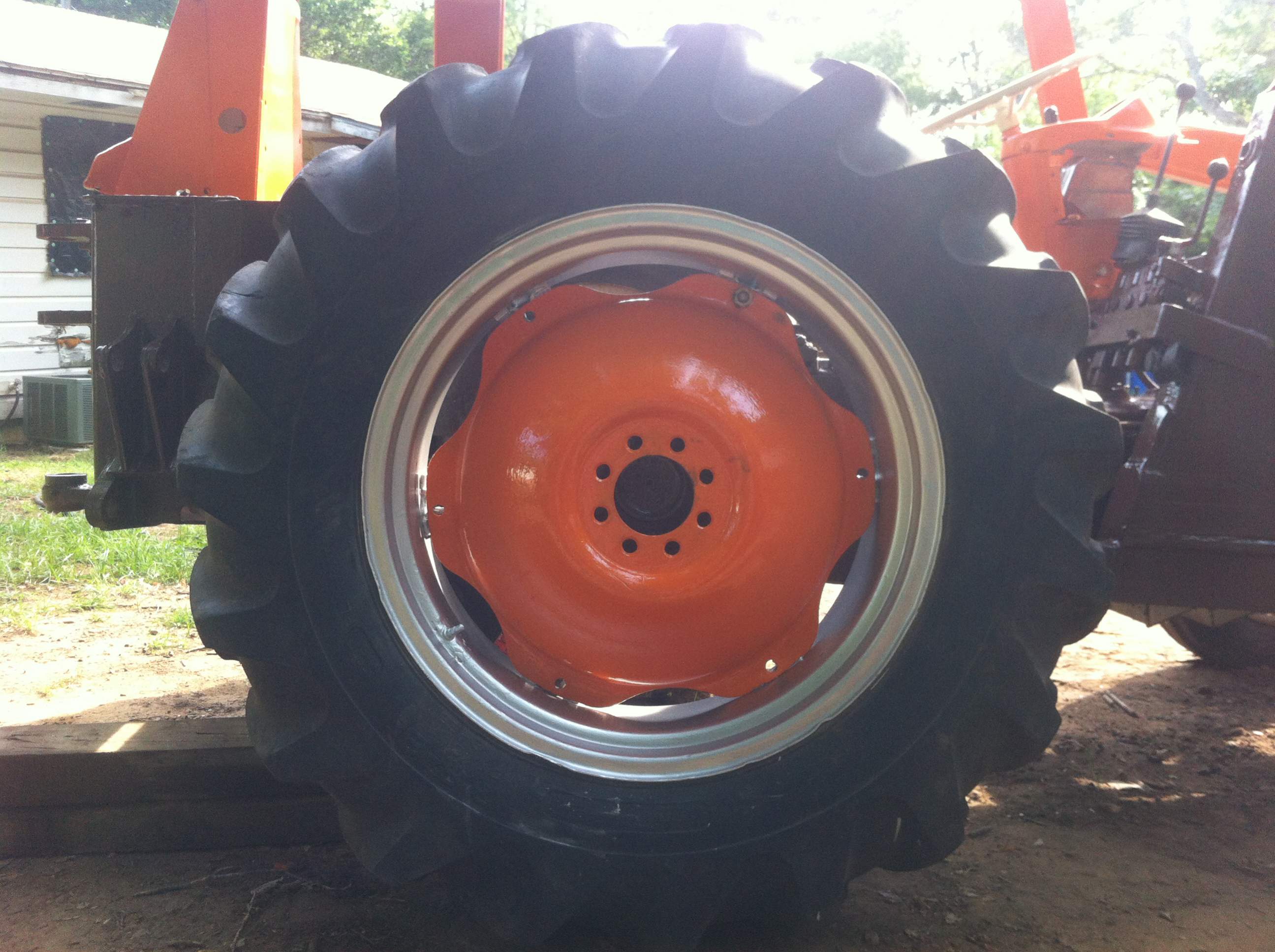

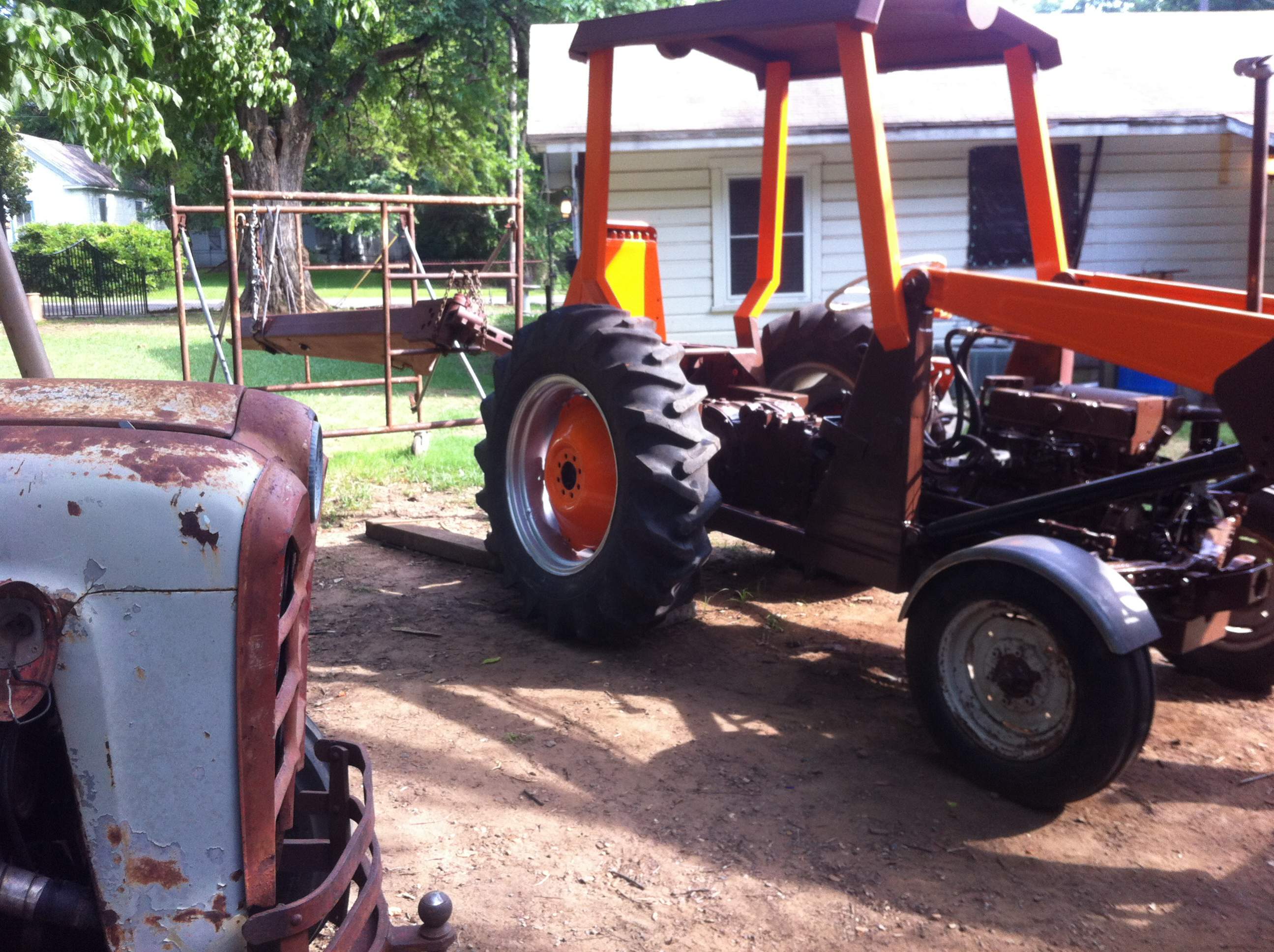

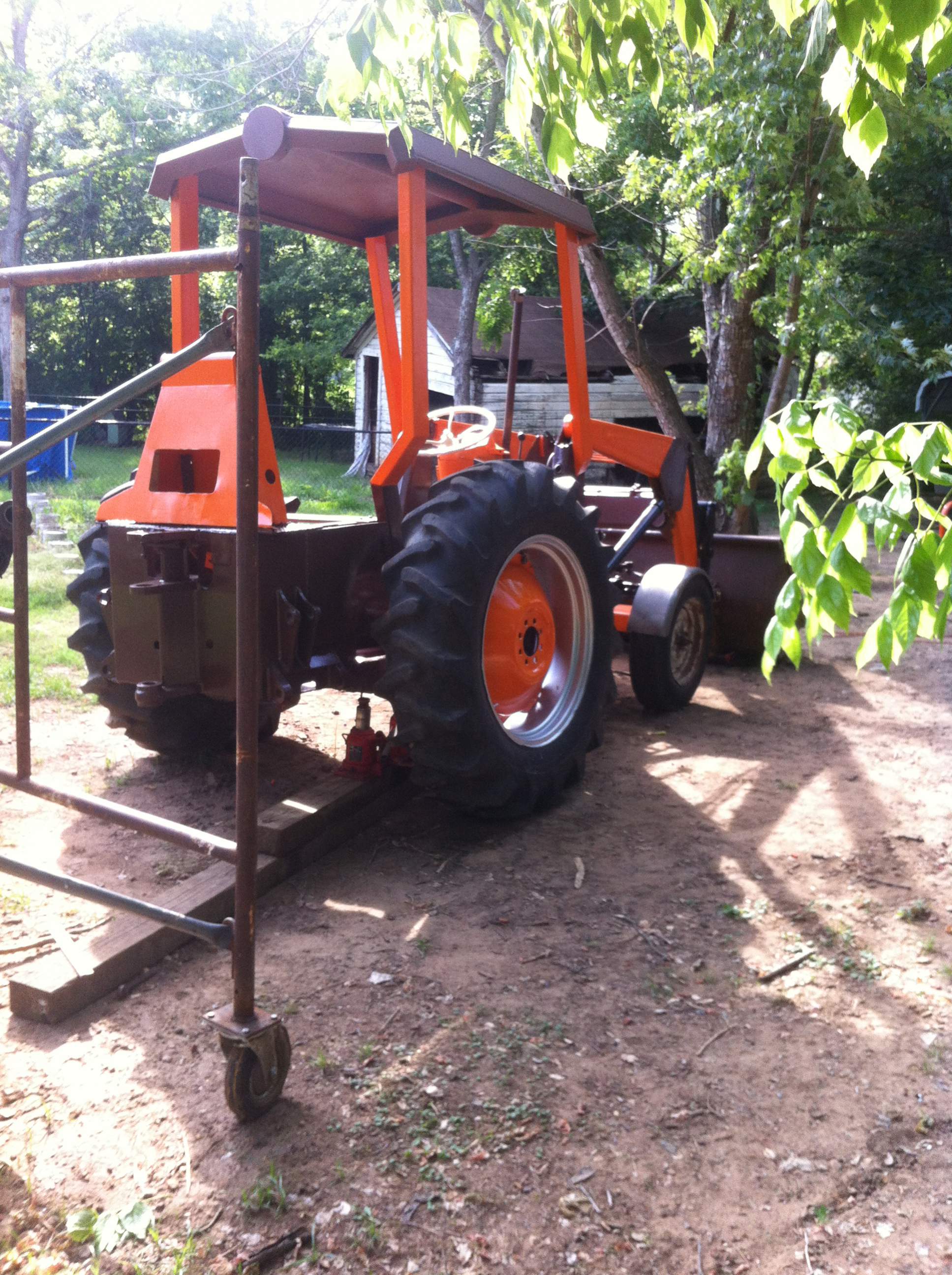

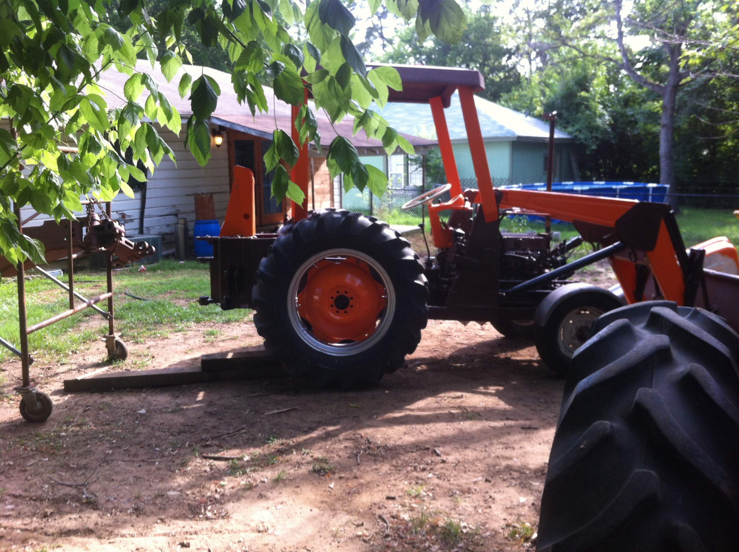

I'm still playing with colours for the paint scheme & I managed to get a rear wheel (mostly painted).
June 24, 2013 tractor backhoe 009.jpgJune 24, 2013 tractor backhoe 010.jpgJune 24, 2013 tractor backhoe 011.jpgJune 24, 2013 tractor backhoe 012.jpg
