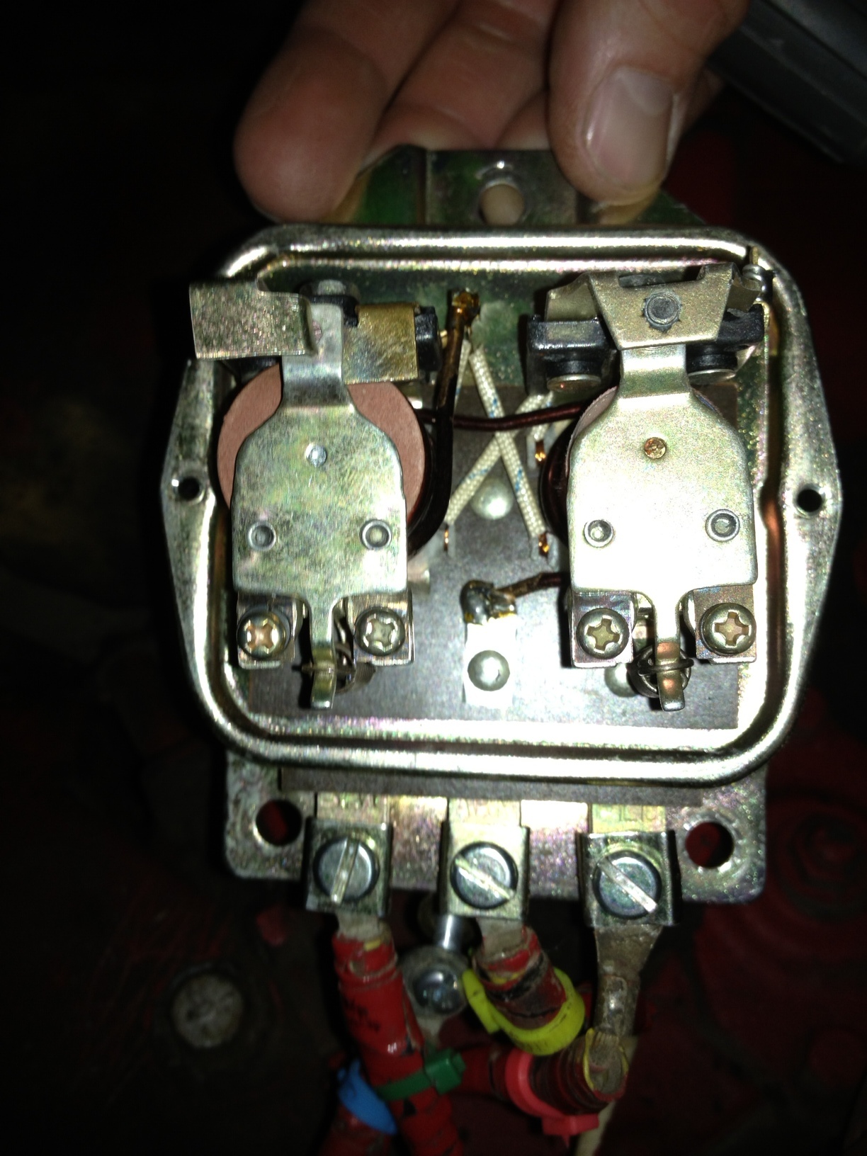

I will post some pictures of the Vreg when I get a chance, including views from the back and the guts of the unit. This may help identify the problem.

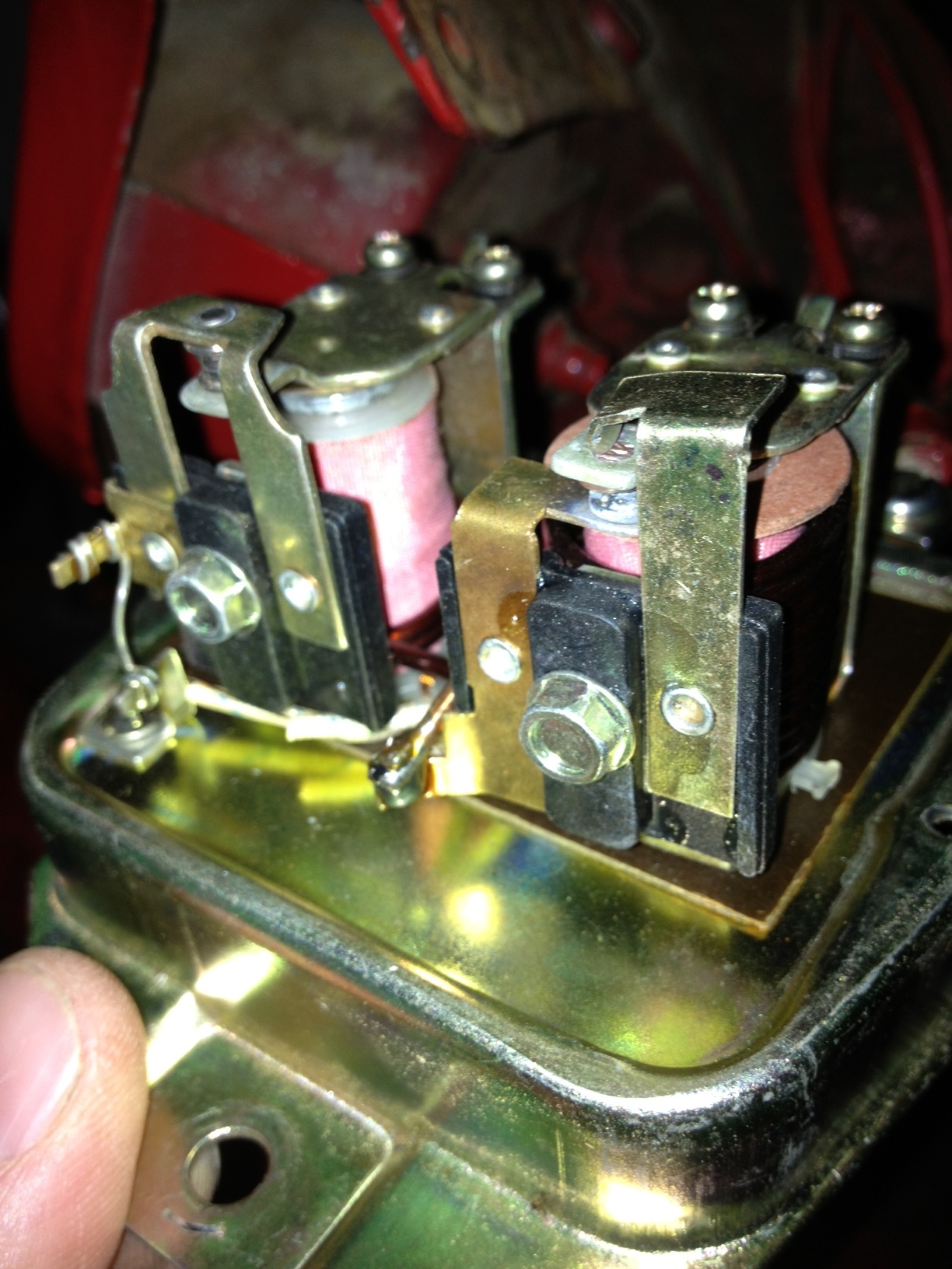

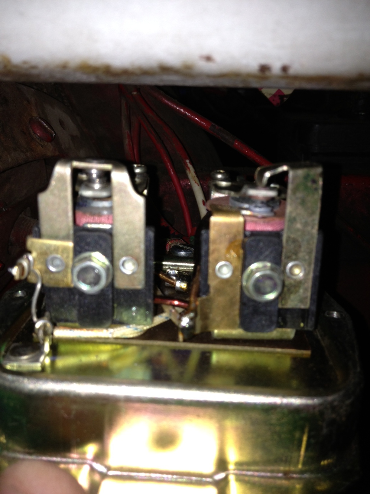

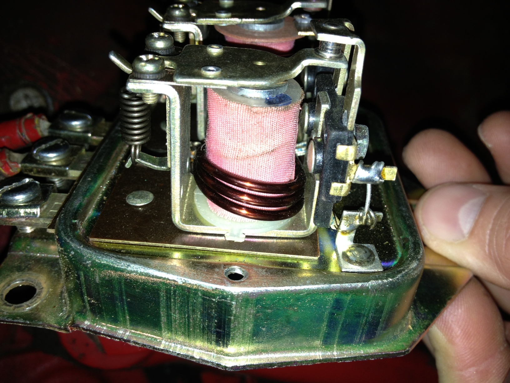

Here are the pictures of the Vreg:
The first picture shows the terminals marked BAT ARM FLD going from left to right and on the reverse side there is a structure (resistor or ground?) connecting the case and what appears to be the FLD terminal.
These are the other pictures I took. Do any of these shed any light on my problem?
Thanks.

as i said. a bias resistor from ground to field is normal for a A circuit regulator.
your post #36 said otherwise. :)

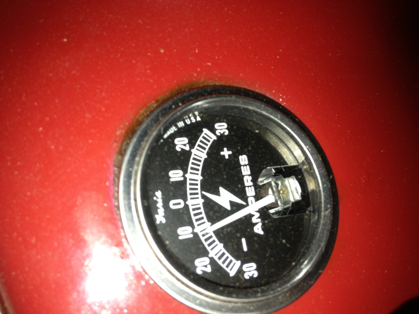

Update:
Started the tractor with everything hooked up. Initially, the ammeter needle drifted aimlessly between the positive and negative side and finally drifted slowly to the positive side, but barely so. Once I lifted the ground line the ammeter zeroed and once the line was reconnected the needle drifted slightly negative and did not move again even if engine revved. The same occurred with each subsequent wire I lifted FLD ARM and BAT.
So what do you all make of these findings?

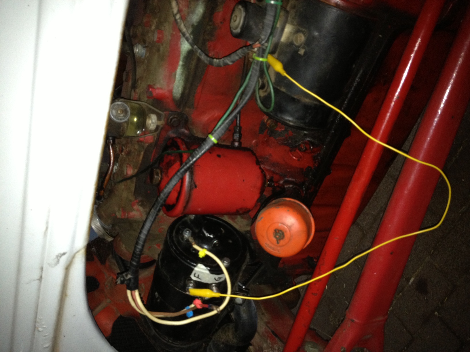

full field it when running at idle then increase rpm
   / Ford 8N - Electrical problem. No juice and ammeter buried into negative side.
#47

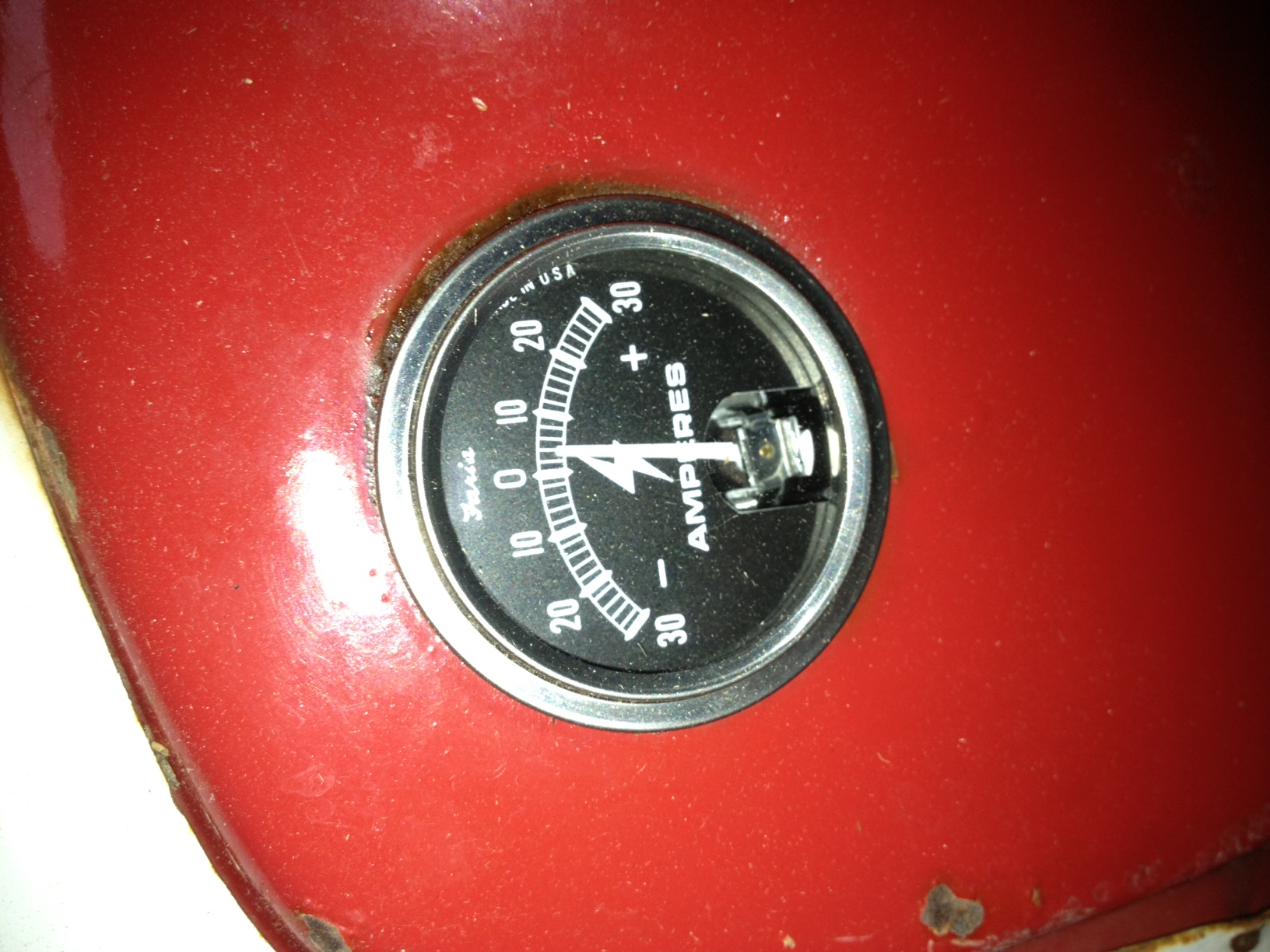

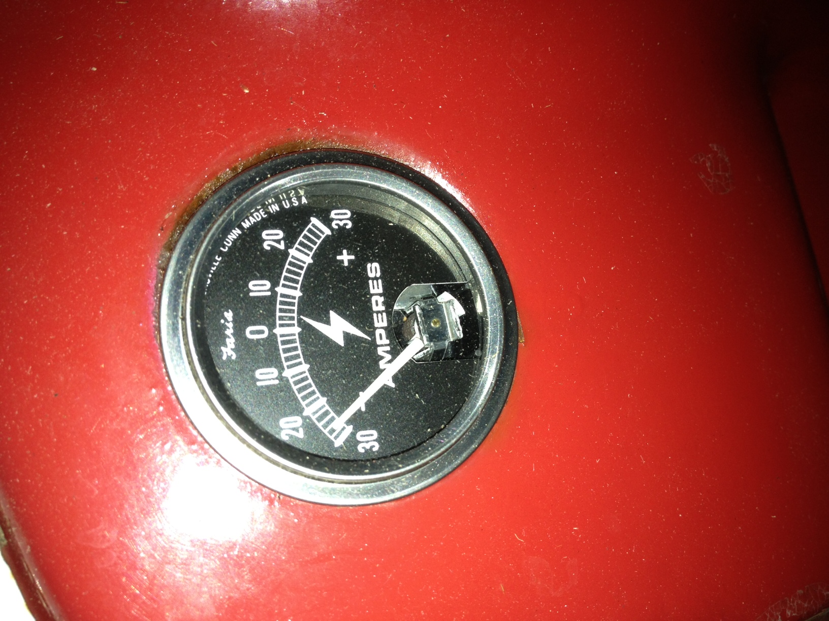

Here is the setup for the full field test. FLD lead is disconnected and a ground jumper is connected to the field post:
At idle the ammeter shows a slight positive current:

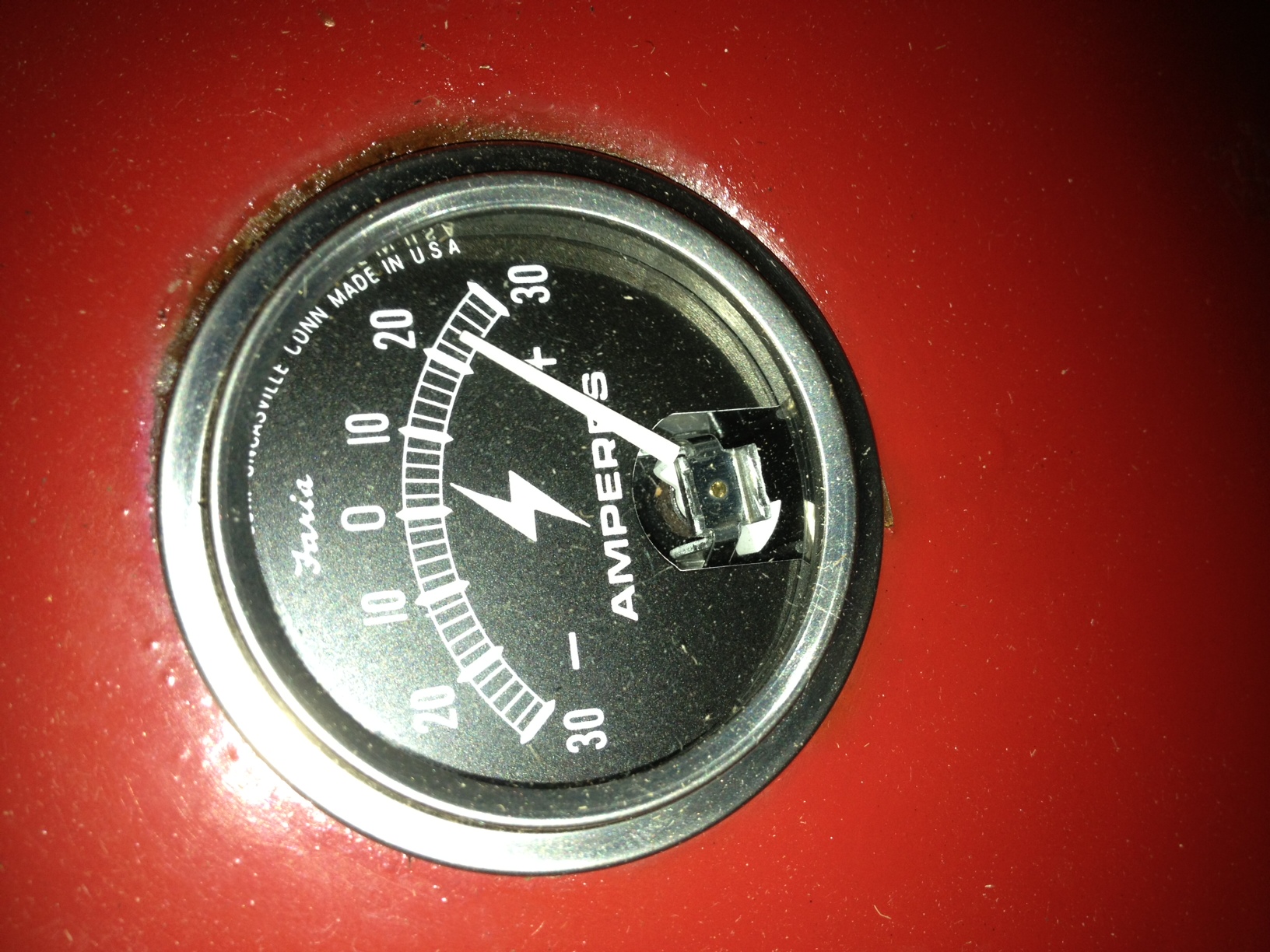

With increased RPM:
However, once I reconnect the FLD wire to the gennie and reconnected the battery, the ammeter showed this:
If started and the engine is revved I noted this:
The situation seemed to temporarily rectify itself once I polarized the Vreg, but I attempted the full field test again after the polarization and the ammeter immediately pegged to the negative side again and, so far, I have been unable to reverse this problem.
The tractor ran fine if I pulled the leads off the battery, by the way. The problem seems to not be with the generator.
Sooo...these are the tea leaves, how do I read them?
