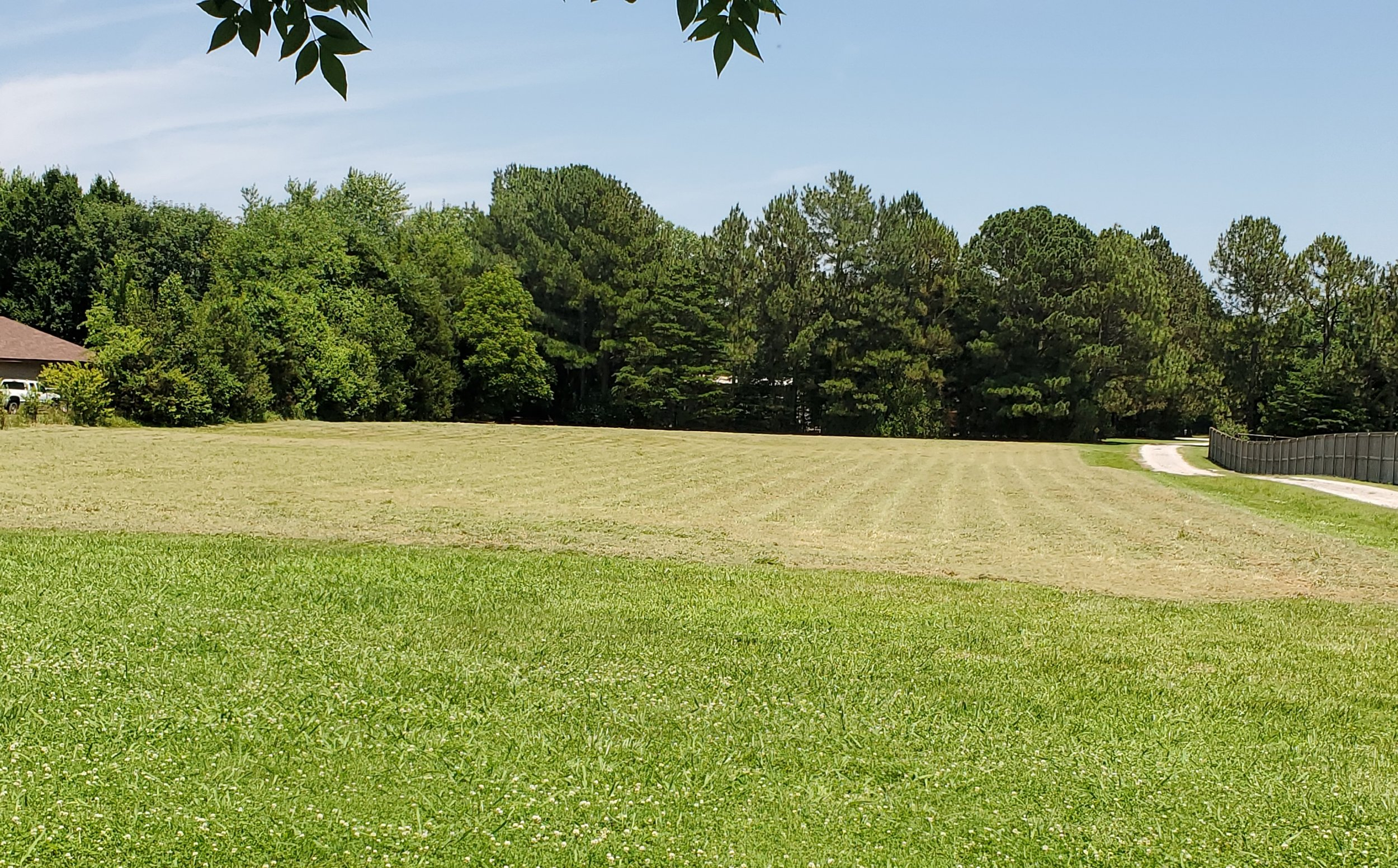

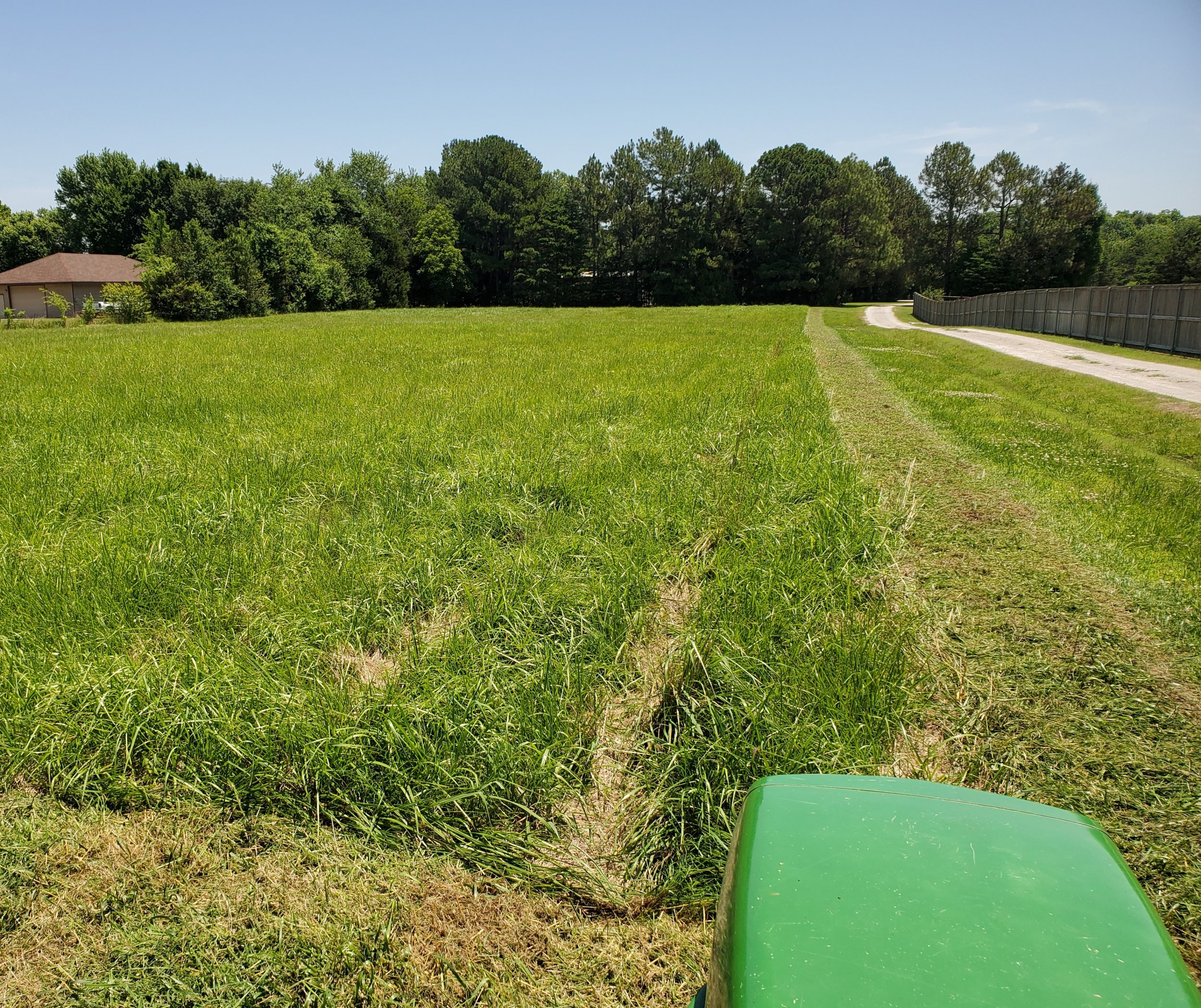

Here was yesterdays big test of the 917L.
This is an area about 1.25 acres I brush hogged in May.
You can see it grew up a bit since.
Height was about 8+ inches of pretty dense green grasses and cut height set at 2 1/4".
It really mowed without issue and took about 1 hour and 20 minutes to do.
Only issue we saw was that you can see the tire tracks but I think this may have been more from the brush hog.
I could see a lot of dead grass from the brush hog also.
I'd really like a wider cut. If I try to run at the full width of the flail with little overlap I get strips of uncut grass so I have to overlap about a good 6 inches.
I'm new to flails so it is a learning process.
   / Ford 917L Special Flail Mower #58
It looks about the same as my 917L cut and perfectly fine for a yard in my opinion.
Mowing more often will help but it may also be worth trying to raise the mower a little if you can.
The tire tracks are probably about the same as with brush hog, but easier to spot since the rest of the finished cut looks nicer?
