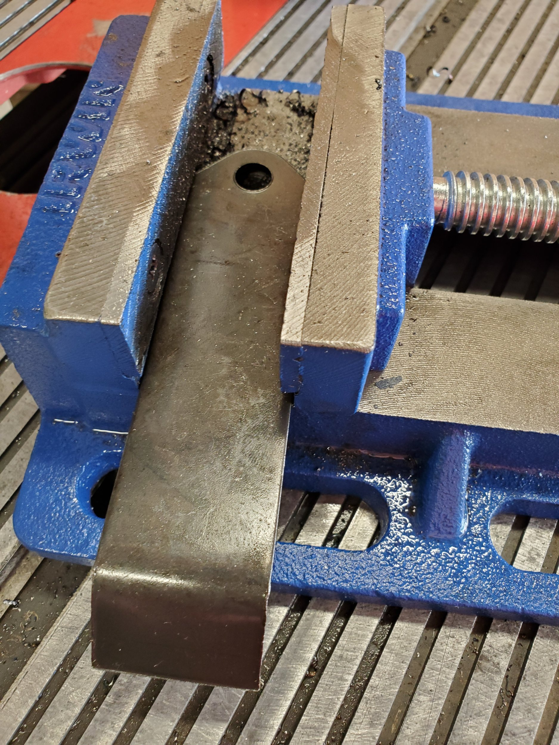

Not a big deal, but last summer they had 7/16" holes in the MH-386 flails and I drilled them out to 3/8"
Just be glad if they now have the proper size holes since drilling them was not easy due to pretty hard material but I did it.
Well it turns out it is a typo!
So I got them all drilled (100) but at first it was taking forever. I was thinking my $45 carbide bit was going to crap out after 20 parts.
Then I stumbled on to something that made a huge difference.
I was loading the flail into the drill press vise with the cutter end pointing up, opposite of in the picture, and drilling like that. It was hard going with lots of heat and took forever to drill the hole.
By accident I loaded one with the cutter end facing down toward the table, like in the picture, and wow what a difference in the drilling. Took 5 seconds vs. a minute before and went so easily.
If you look at the hole in the picture, pre-drill, you can see that this side is where the punch exited while making the original hole. I think drilling from the side where the pinch entered the metal or started the hole does something to the metal. It also makes a sort of beveled hole or rounded edge on the hole. I think the action and pressure of the punch starting through the metal heats it and makes a hard edge around the hole.
As I drill from the side like in the picture it goes right through but you can feel it hit a hard area just before the drill finishes the hole. Night and day difference drilling the holes though.
