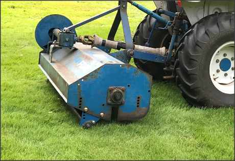

Ok guys, new flails on and new PTO shaft also. Went and tested it out around the property.
Cutting nice green 3-5 inch grass it did ok.
Getting into some more weedy type stuff (filed type growth about 4-6 inches) with a little bit of small ground vines and it would start to clog and slip the belt pretty easily. Do need to retighten the belt.
I know this flail is listed as "light" duty but I'm not really sure what to expect from it. It's my first flail mower.
Seems it's area is going to be a kind of "first" cut for that heavier green grass that may start to bog down the 60" deck or finish mower but isn't enough for the brush hog.
What do you guys use yours for?
Also thanks for all the help getting this one going. Fun project and I think I am in it for about $550 for the mower, flails, clevis and cotter pins, new belt and PTO shaft. So no complaints!

I just mowed my pasture with 60" 917L and am pleased with the result when compared to my JD 413 48" brush hog.
It is faster, uses little less power in tall grass or hay, no scalping and leaves nicer looking finish. No doubt it will require more maintenance over long run but that's OK with me.
Just like you said, sounds like you need to tighten up the belt.

I agree, cutting basically field grass or any grass and especially if it is short than a foot or so the 917 is doing a nice job. Definitely better than my brush hog which I run at a 4" cut height.
The new belt has loosened a little but that's expected to get a little stretch at first.
Do you find the cut better if you run the 917 at its upper height like 2 1/4 or 3 inch or withy a lower cut?
I have mine set to 2 1/4" right now.
   / Ford 917L Special Flail Mower #49
Mine is already set for maximum height and I am eventually going to figure way to set it another inch higher.
It is around 3" height now.

Good to know on the height. I may bump mine to 3" for now and see.
I am going over to a customers field today, 1.2 acres, to see how things go. I brush hogged it about a month ago. It is pretty nice straight up grassy.
It should be a good test to see how things go.
