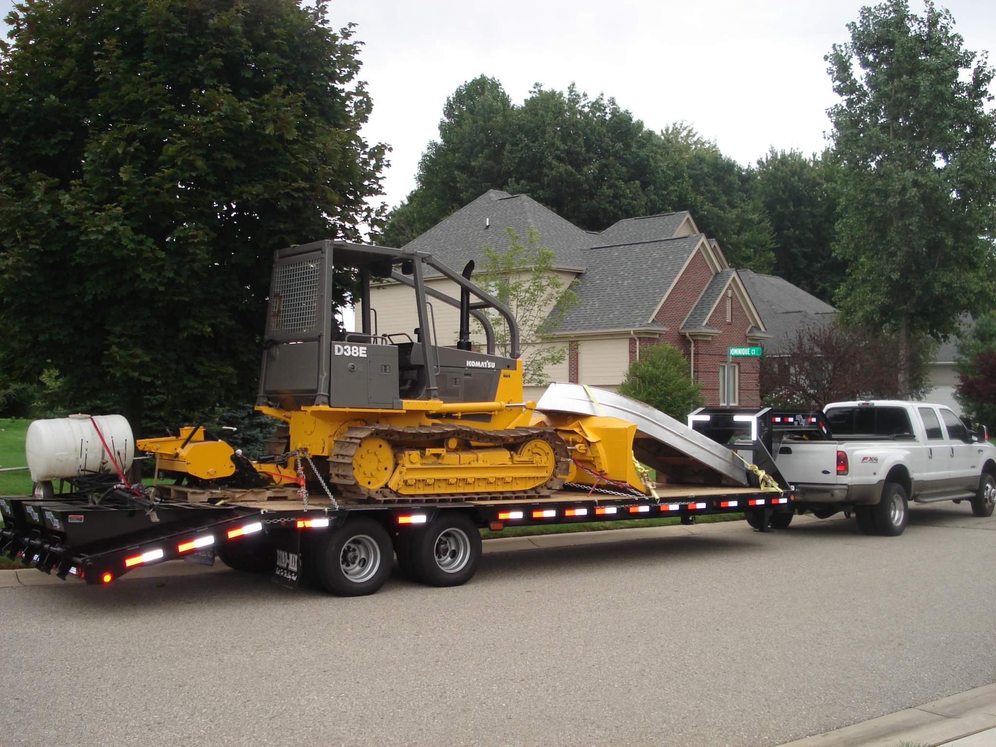

would like to see a picture or video of this 25000 lb load going down the road....
2006 6.0....Trailer....7,000....Dozer....18,000.....400 miles with no problems.
Scout... That's a sweet looking rig. Your truck looks happy too :D
