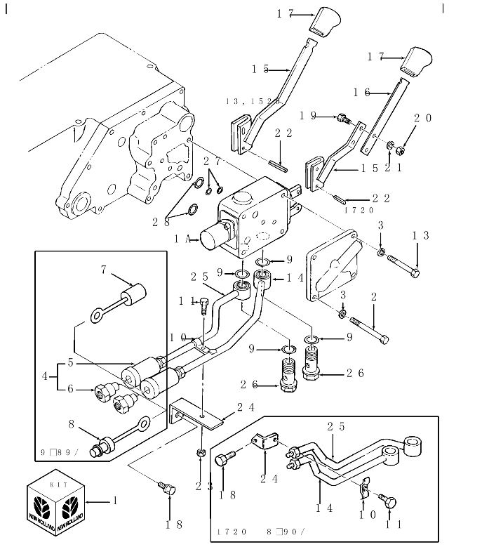

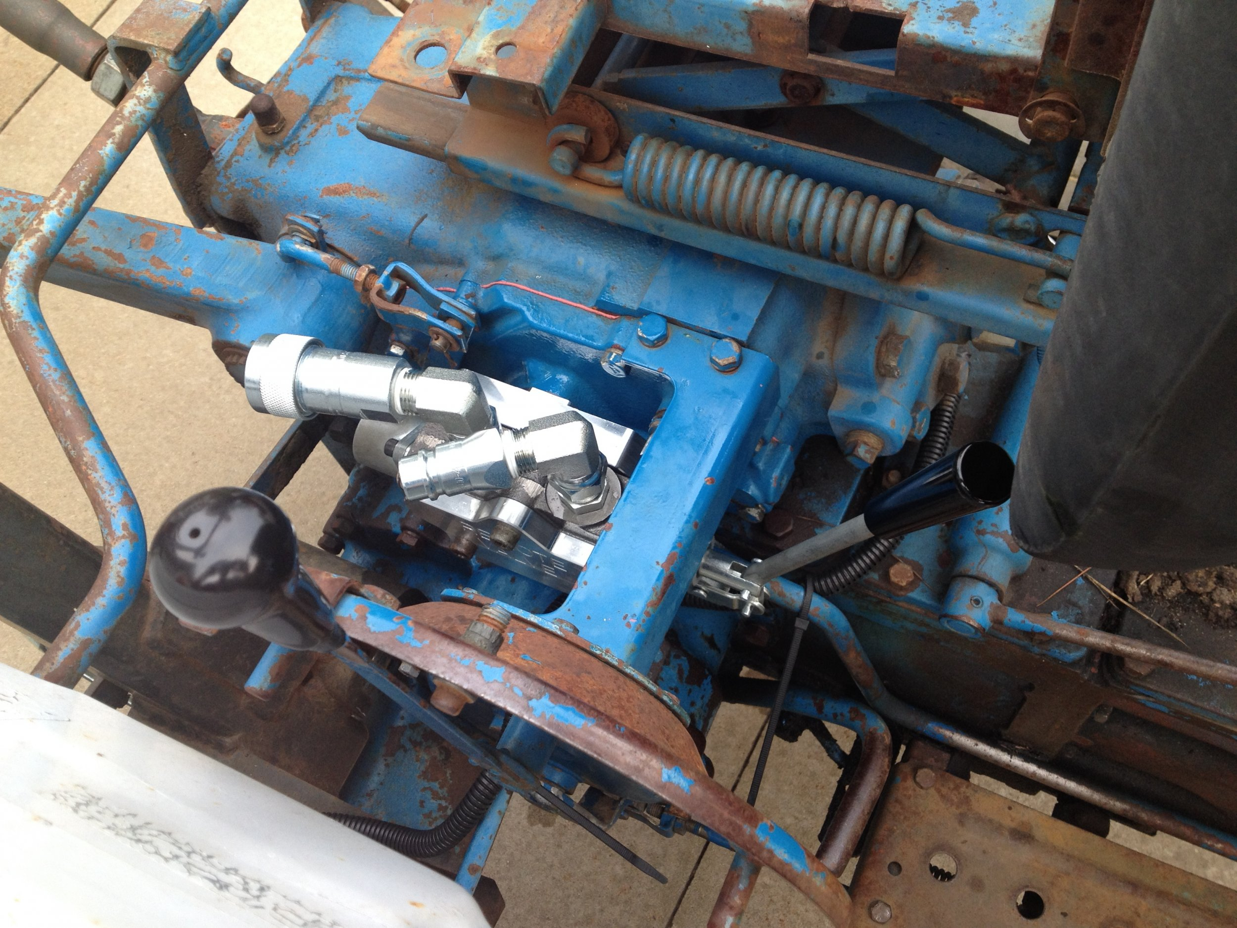

Hi All,
I'm trying to gauge interest on people looking to add a rear remove valve(s) to the 1720. I've been making a kit for the 1710 (see picture) but have come across a few people looking for a kit for the 1720. This would be a replacement for part number SBA340002301, which I think is NLA. I believe this will fit the 1320, 1520, 1620, 1715, 1720, 2110, and 2120 tractors. I've just become aware of a 1720 nearby that I could use for taking measurements and developing the kit if there's actually any interest. This puts a hydraulic valve right under the seat, rather than a power beyond adapter like Tisco or SMA HV4945.
Here's the link to the 1710 rear remote thread: Ford 1710 Rear Remote Valve
Ted

I've started to design the adapter block that the valve mounts to so am making progress on the kit. Once I machine a prototype, I'll be looking for someone to test it out on a tractor. I'm not sure the guy that owns the 1720 nearby will let me mess around with his tractor.

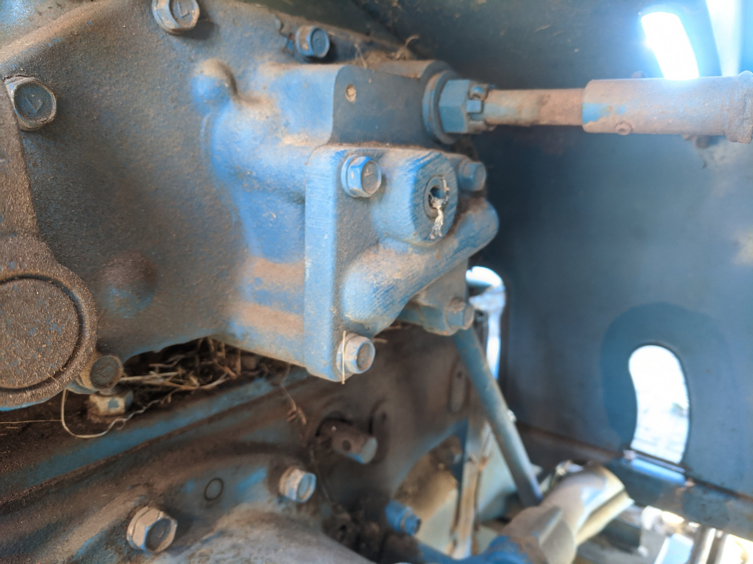

If you wanted to send me a few pics of the right side below the seat where the valve attaches and the sheet metal where the three point levers pass through to the operator area that would be helpful. I think the 20 series tractors have more sheet metal panels than the 10 series so may have to make a custom lever for the valve to get through covers. Thanks!

Adamn, I'm still looking for someone to take a few pics of the 1620 sheet metal and below the seat on right side. Let me know if you can help out.

I've got a design 90% complete in CAD so just need to finish that up and then machine a prototype. I recently had a job change so this got delayed a bit. Hoping to get back to working on it soon!
